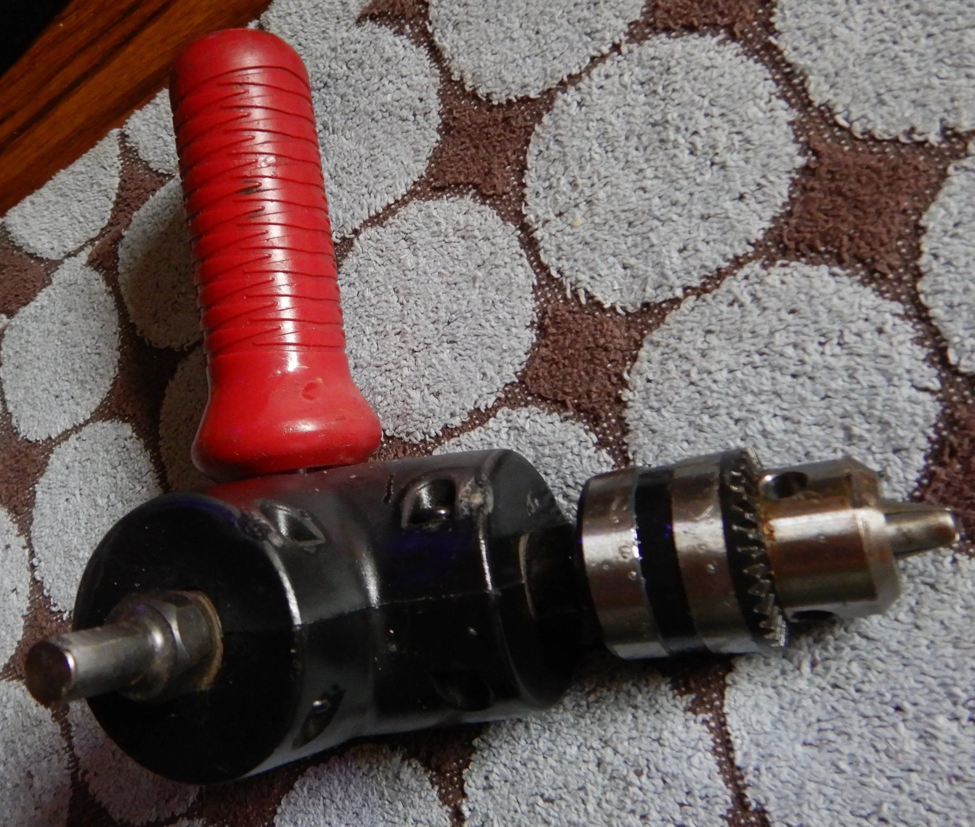

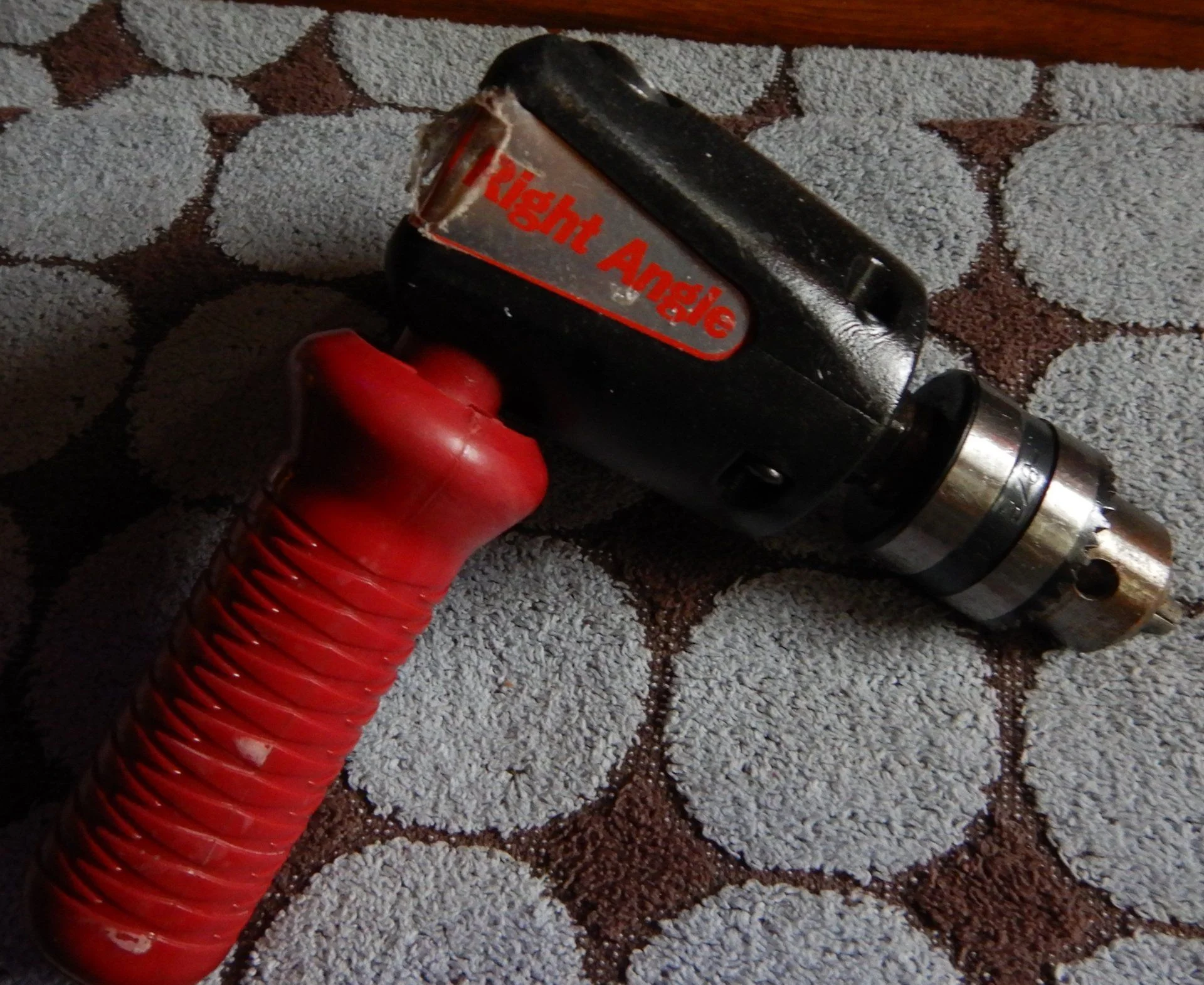

i purchased this MINI right angle swivel drill attachment a while back at Sears , its really a great built tool
in my opinion this will do your drilling job like clock work fast and efficient good same time
this is a Heavy Duty Compact tool for your needs
was under $50 , like $25-35 if i recall
go get one now today , and practice with it first
I also have all the tap and die & corresponding correct size drill bits chart if u need that info
good luck ;)
good luck ;)

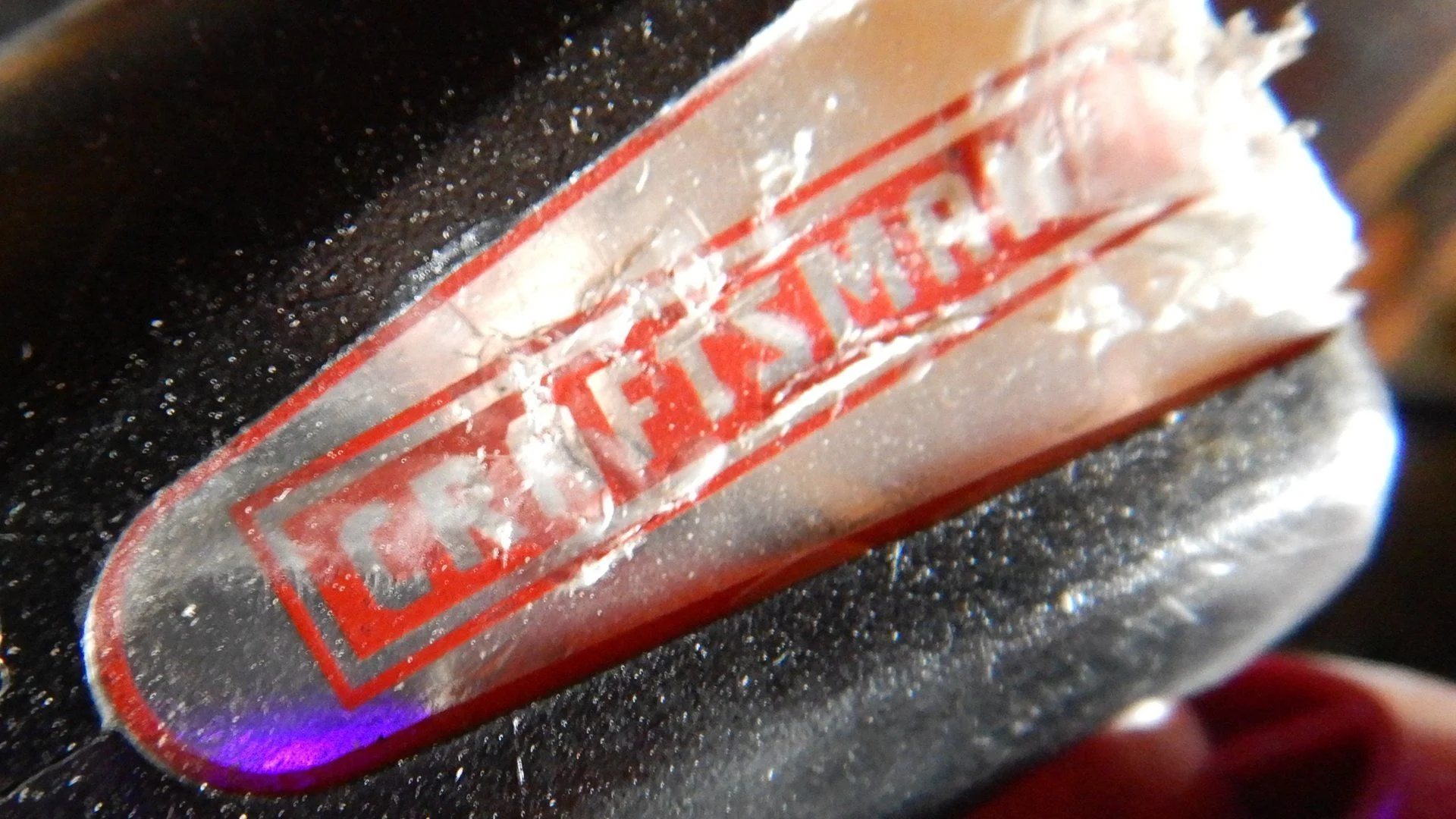

Thank You, this looks like a great tool and soon will add it to my tool list. The harbor freight drill has now out of commission the plastic housing broke off taking it back tomorrow.
