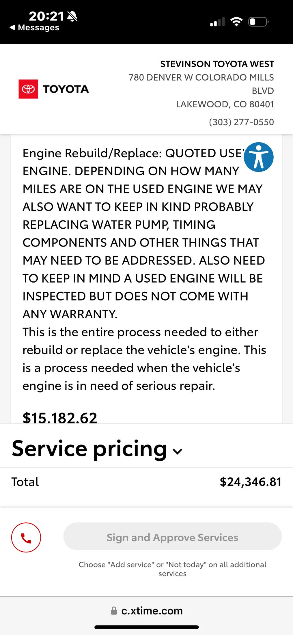

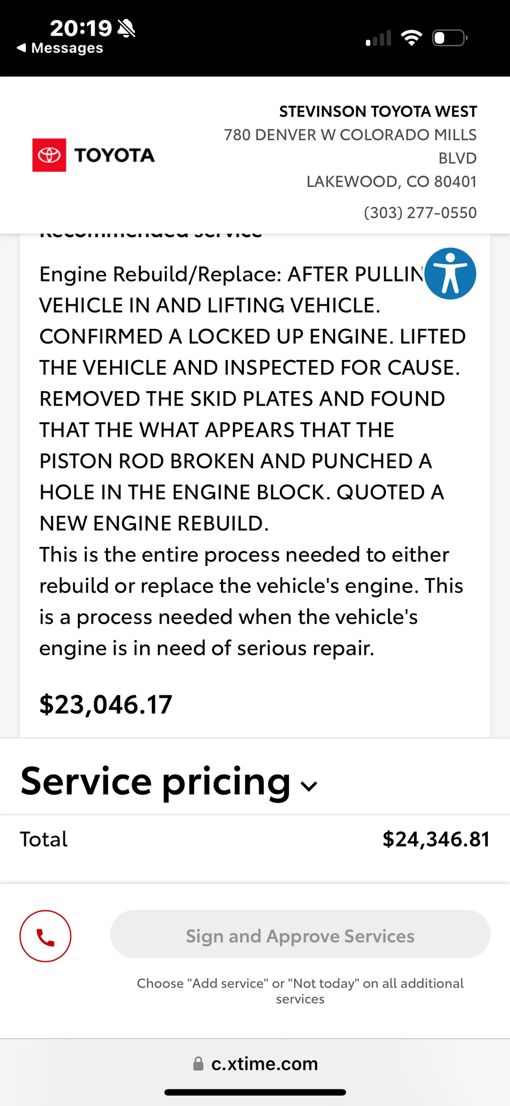

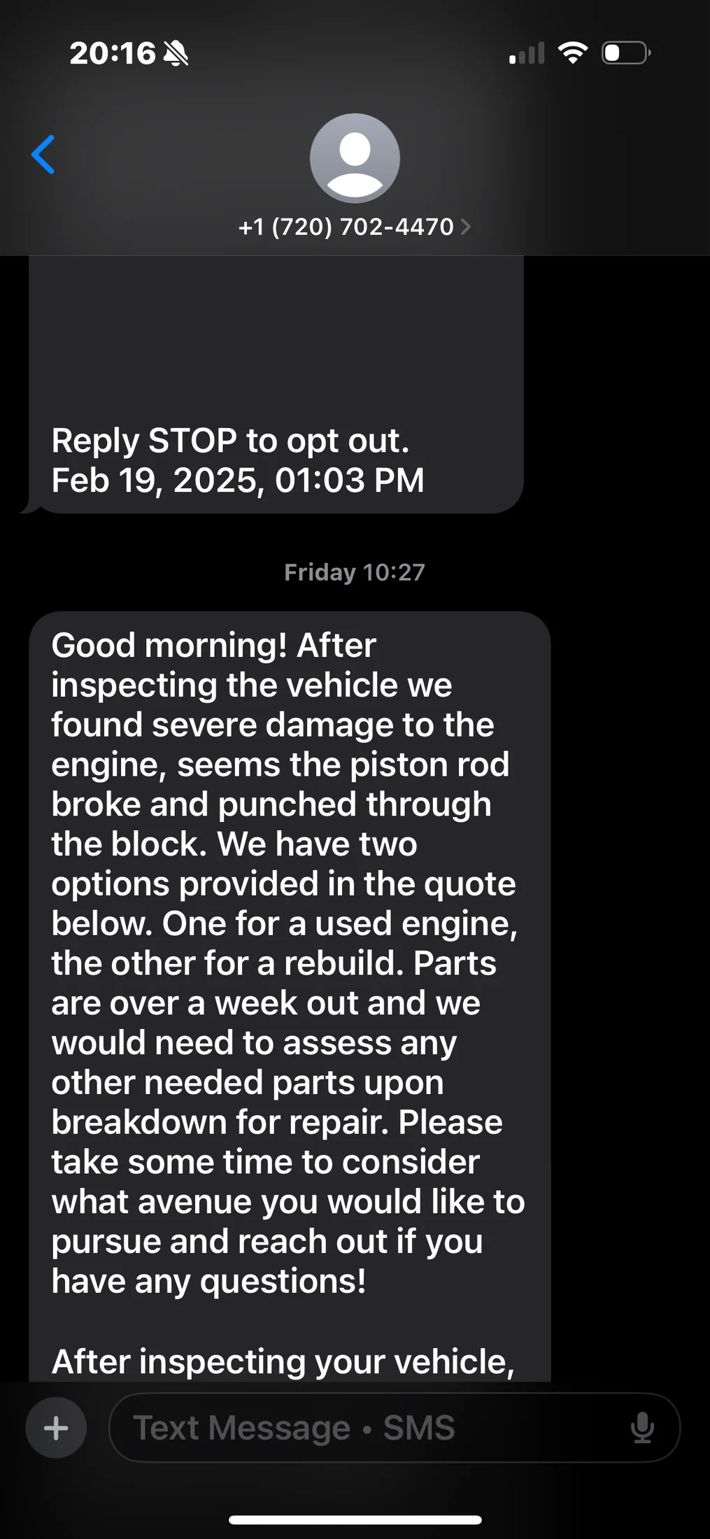

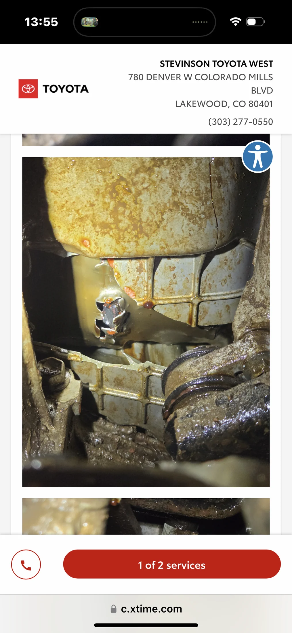

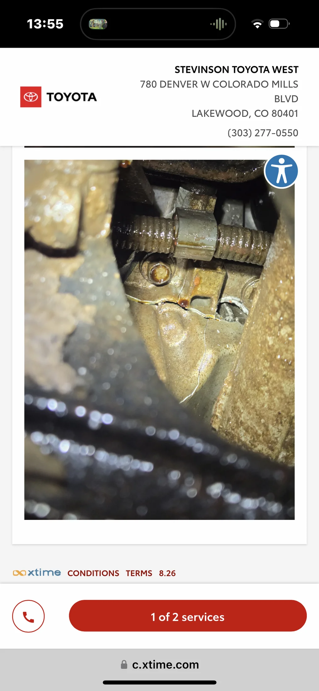

I am not much of a motor head but I knew enough to buy a Land Cruiser when I needed a vehicle for my family in Colorado. I love this vehicle. We've been all over the West in this thing. It has many mods from SLEE but I am at a loss as to what to do with it now. Options are 1. rebuild existing motor (~24K) 2. put in new motor (~16K) or 3. what? sell for parts?
I am leaning toward putting in a new motor and then sell it to someone who want to take it further. Please see the photos below. They are the communications from the Toyota Dealership in Lakewood.
You don't mention year/mileage of your vehicle. I would definitely consider the value of your cruiser without fixing the engine vs fixing the engine. You might also look for another quote from a non-dealer to see if putting in a used engine could be more in the 7-8k range. I 100% doubt the dealer is the cheapest option. Especially if you source a Tundra engine instead of looking for another LC engine.
Without knowing the value of your truck it's hard to make any recommendations. If it's a 2008 with 250k miles, it's probably only worth 20k running and maybe 5-6k not running (no idea if this is reasonable, but I suspect you could get that much for it). If it's a 2013-2015 with 100k miles then it's probably worth closer to 35-40k, which makes fixing it a lot more viable.

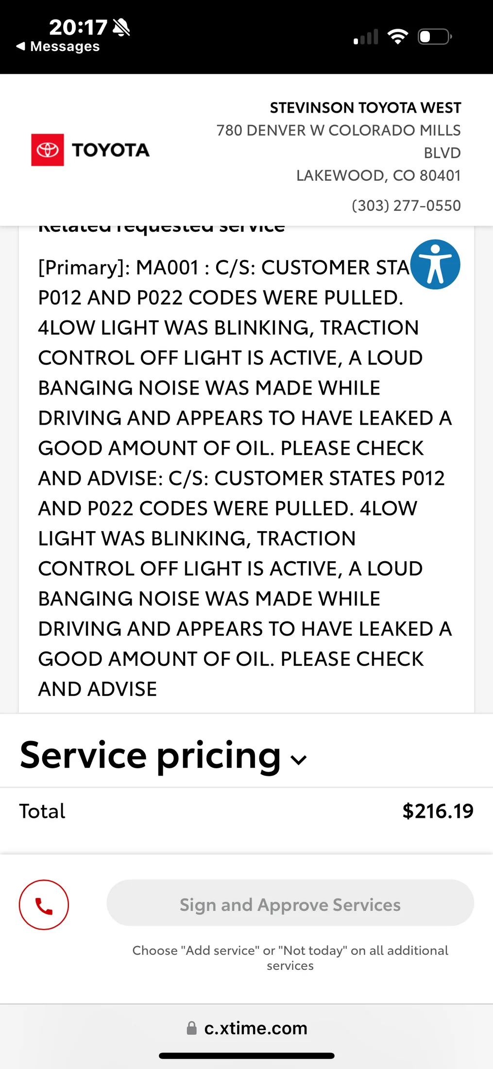

We got about 4 foot of snow in three days up here. Super wet and the 4Lo light started blinking the Trac Off and check engine light came on. We checked the codes and reset them. P0012 and P0022. My son started out for the mechanic and on the way up to the tunnel- revving high probably- kablam - my mourning continues

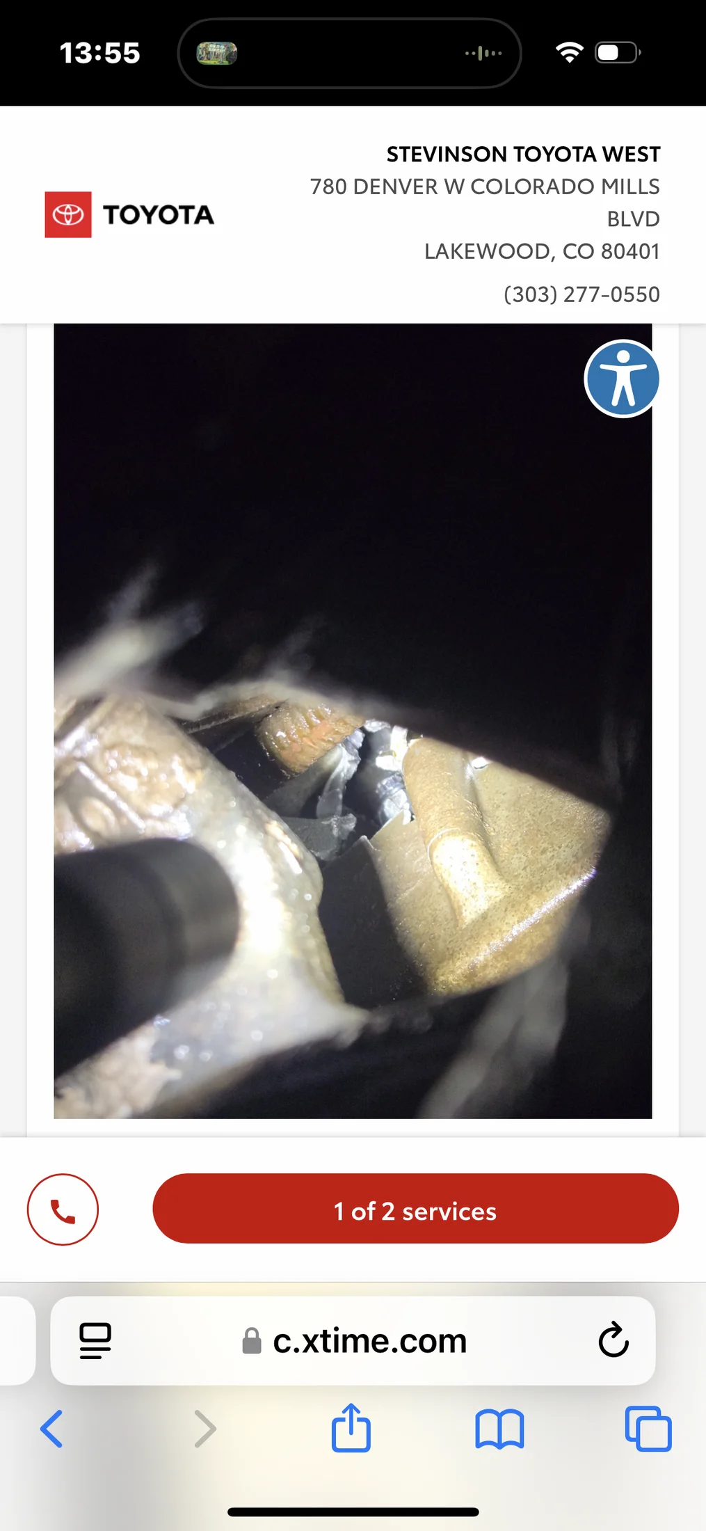

Also, I think we all need to see a photo of the "piston rod broke and punched through the block".
Picture, or it didn't happen!
I'm still scratching my head over the thought of "rebuilding" a motor that had a connecting rod escape out the side of the block. I'd guess in this situation, rebuilding means putting in a new engine and swapping over the manifolds and external accessories.

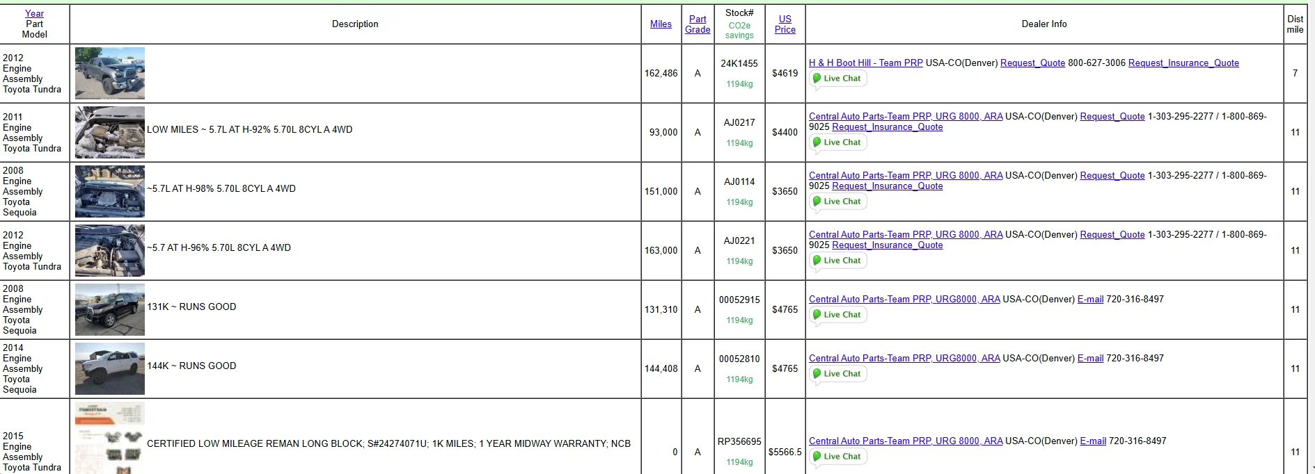

If a Tundra 3urfe (non flex fuel) will work, I'd go that route. Here are a few examples in Denver, Colorado:
If I was in your shoes, I'd be looking at negotiating a deal on the second one (2011 with 93,000 miles for $4400), and possibly checking out the last one (reman for $5566.50). I believe you can also look at the flex fuel 5.7 L. Someone please chime in if I'm out to lunch, as I've never swapped a Tundra 5.7 L into a LandCruiser or LX.
