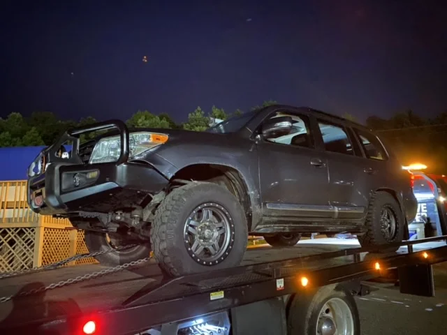

Several jump attempts later and we chalk it up to the starter issue. Replace starter and no improvement. Engine appears seized. Throw in the towel and have it towed to shop.

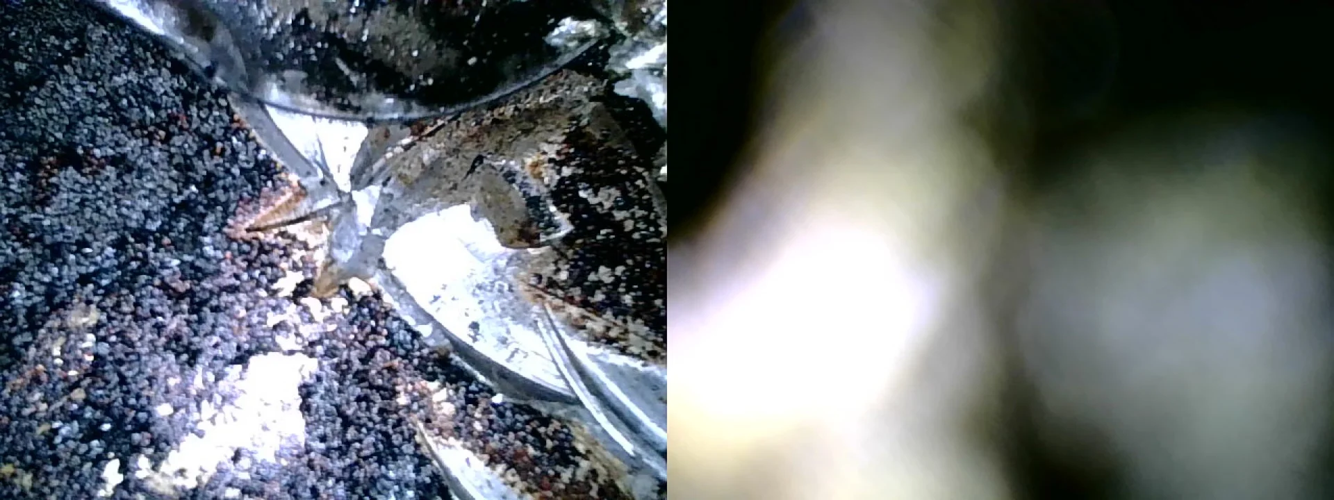

Cylinder 2 is done

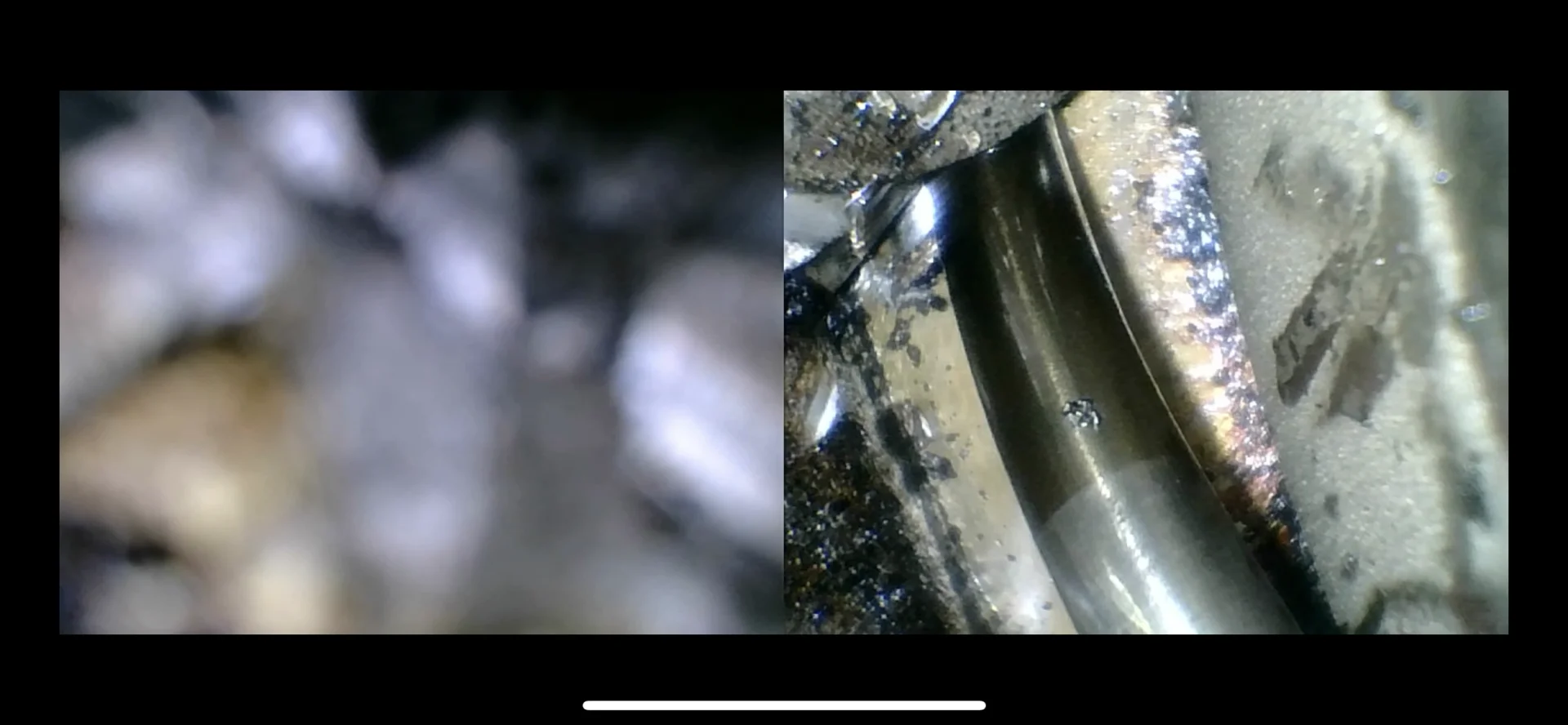

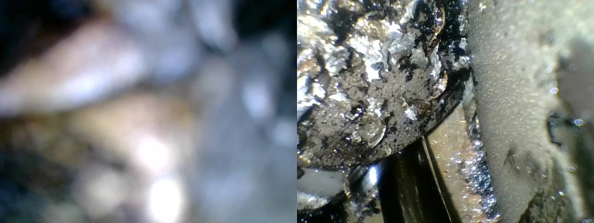

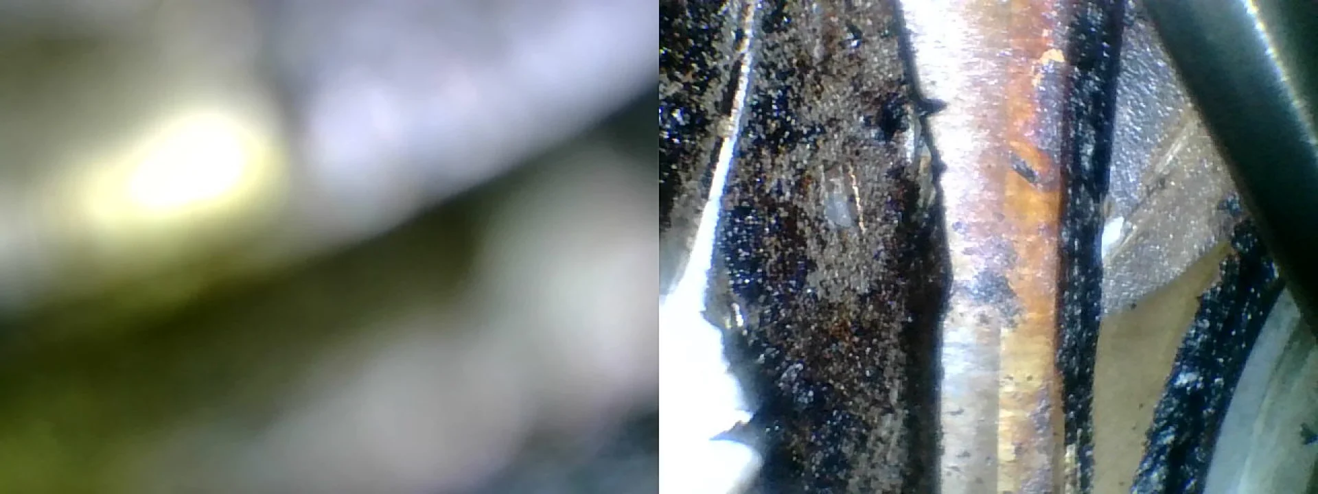

Borescope pictures confirm the carnage inside. Can’t see the whole cylinder yet but turning the crank doesn’t move the piston so the rod is likely broken and fearing the block is gone with it.
Maybe a valve spring failure? Tear down is paused to figure out the next move. Best case, new head, piston/rod, and related parts. Likely looking at a motor swap.

Lots of carnage. Really was expecting a bad engine ground. Cylinder 2 is hosed. Jarco won’t even sell reman 3ur motors. When we tried to back the piston down with the crank nut we could hear parts falling into the pan and the piston didn’t move much which means the connecting rod is done. Once the motor is out I’ll do a little more investigation and see how bad things are in the bottom but I’m pretty sure it’s all toast. Only thing I can think of is a valve spring failure. I’ve heard from a few sources it’s almost always the passenger side.

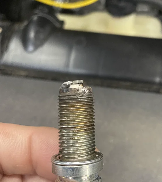

Cylinder 1 is done
