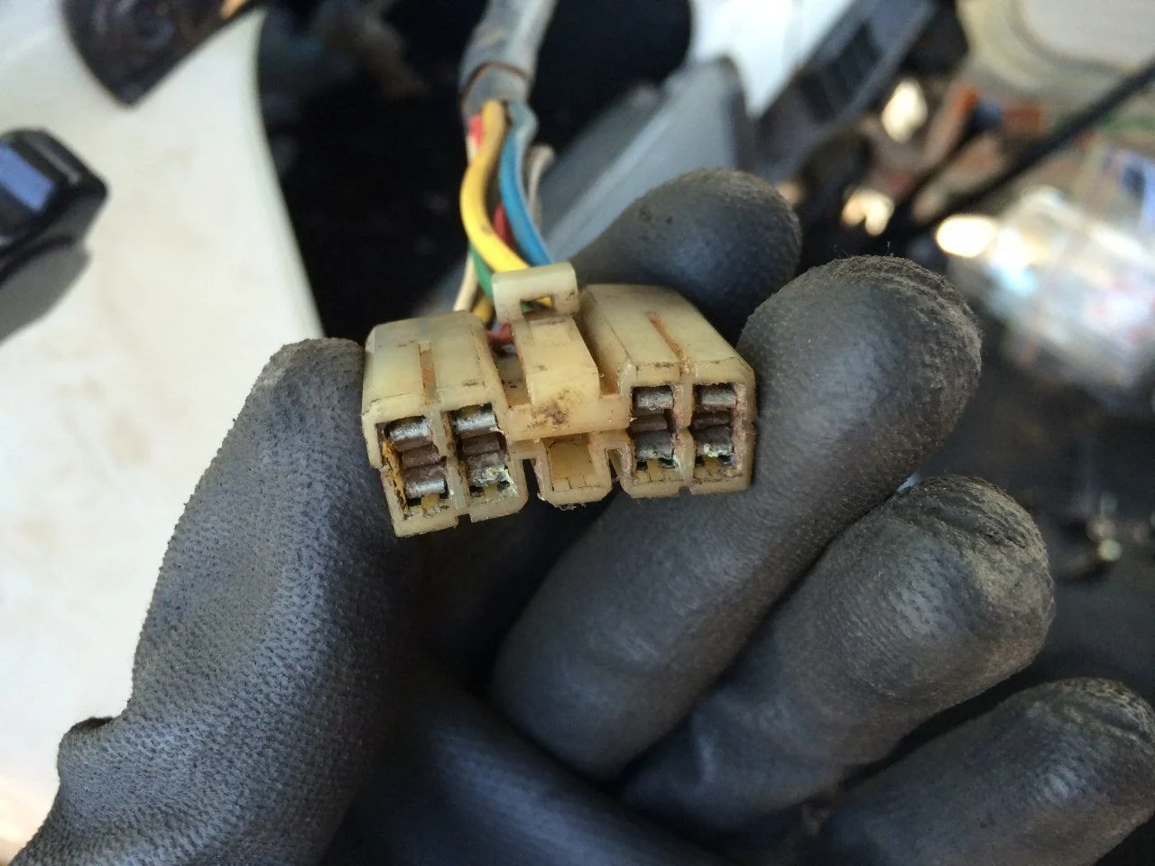

The first picture might be a good clue as I understand the 2H's low oil switch is a normally closed circuit. That plug with the wires jumped across leads to the fuel control relay, I tested them all and they correspond to each other some with no resistance and some with high resistance.
The single wire to the left of the plug corresponds to all the wires at the fuel control relay, mostly with no resistance and some with high, except the yellow/black oil pressure switch wire which it has no connection to. It does not lead anywhere it's just dangling there. Anyone know what this wire is all about?

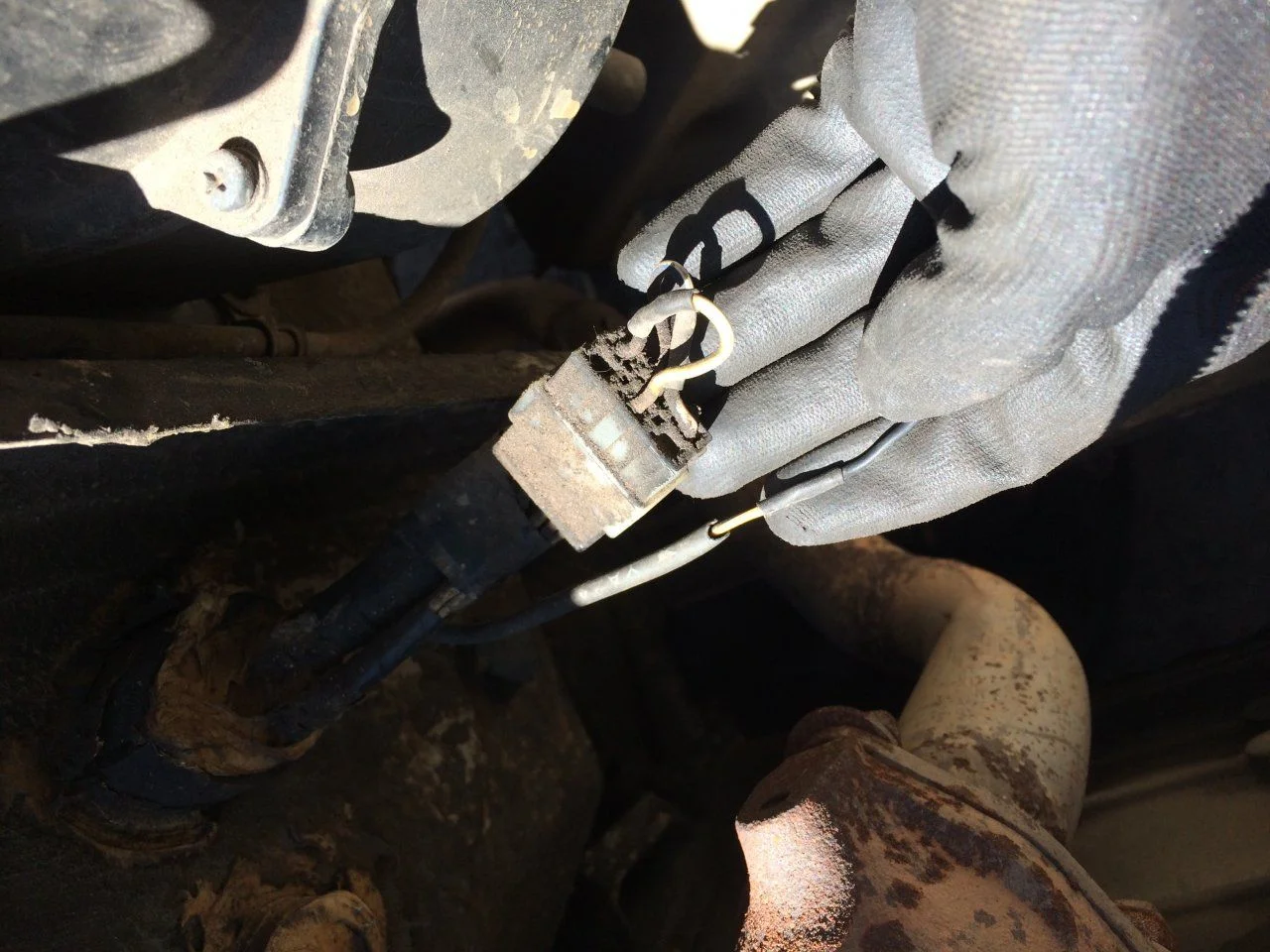

The plastic insulation in the second picture contains a wire which corresponds to the oil switch wire at the fuel control relay with no resistance and once caused the engine to die due to grounding the exhaust manifold. I followed it to the alternator where it appears to turn around and run back into the fuel control relay.
Oh. Typing this I just realized that wire in the second picture must be the one I need to connect directly to the oil pressure switch since there will be no continuity through the switch so long as there is oil pressure. Does this sound accurate?
