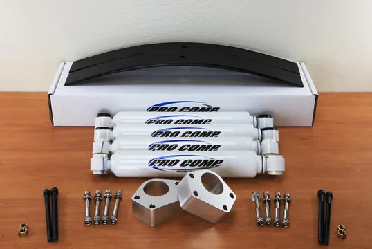

Don't mean to thread hijack, but would the add a leafs in that kit still give you a lift if you are sagging in the rear? Or would you have to get new springs and then the lift kit?
Every add a leaf is different. Basically different spring rates. The problem on answering that question perfectly is that I have no idea what the rate is on those add a leafs nor what yours are currently at. What I will do is take a stab at your question based off of experience and say..... Those are short add a leafs which normally have a high rate (stiff). They will lift your sagging springs just fine back to where you want to be. The longer add a leafs I prefer (softer ride) but are more likely going to get influenced by your sagging pack due to they have to take the full load. This is stupid but I have to say it as I have seen it done. Make sure you place the add a leaf in the correct spot in your pack or you will be trying to influence overload springs which are not going to budge. Toyota is luckily pretty obvious so you shouldn't have an issue.
Again I am just one of thoe guys that are trying to be helpful..... I have lifted zero early 90s type yotas. Ask me how to lift a tacoma cheap as that i can answer confidently as I have done 7. The rears are obviously similar
id say your about right station, as you said stiff will increase the spring rate and thus make the truck sit firmer and compensate a lil for the sagging springs, they only sag due to old age and losing there pretension and therefor the spring rates. adding an extra one should help bring it up a bit depending on the length of the spring..
Before I get ate up I should mention the arch of those add a leafs factor into the occasion as well. Even a stiff as a board add a leaf wouldnt do anything if it was flat and you were adding them to a pack that was slightly arched while on the vehicle (have load). The add a leafs in the pictures arch reminds me of a rear spring that has been removed and has no load on it. Therefor these will indeed increase your sagging springs as your springs are closer to flat right now (which is why they lift your vehicle even with a good pack more than just the 3/8s or however thick they are).... This next piece doesnt apply to the 90 trucks but to make a point the front yota springs are flat which is why when you put a pair of rears in the front it provides I think 3" of lift (as well as moves the front axle forward or backwards). I hope this makes sense. The down side to the adda leafs is a stiffer ride...... Not too stiff but stiffer. I preferred blocks vs. add a leafs on the tacomas I have done except the ones that were not the tow package. One of them had a different leaf pack in the rear and the add a leaf was a perfect addition as when a four wheeler was loaded in the back it prevously sat on the bump stops...... Mind you these were daily drivers so the axle wrap wasnt an issue nor was even noticeable. BUT they did not have sagging springs either so in the case of the sagging springs go with the add a leafs. If you have good springs go with a block or the add a leaf in the rear.... No biggie either way is fine. The only question we have now is do you just crank the torsion bars to whatever will still be alignable or do you purchase those shiny doo hickeys that (supposebly again I do not know) keep your geometry correct.

I am after the same thing. I am going to go with 1.5" ball joint spacers and add 2 leafs from another set of rear springs I have. If I need I will add longer rear shackels to get the back where I need it.
I need a little extra in my springs because I have wood compartments in the bed and a topper. I also put stuff in it often and I think 3 leafs + the overloads is just not enough, so this will be a good option for me. I do not care for add a leafs, but that is just me.

Meigsrock - i agree i prefer to go with long factory junk yard leafs in addition and cut them down accordingly as an identicle pack will have two leafs land at the exact same spot making for a really hard spot in the pack that has the potential to bend the next up leaf. I agree that add a leafs are not my favorite BUT i do not want to confuse people as on my tacoma it worked perfect... On my 1980 wheeler I am going for a completely different purpose and would not put an actual add a leaf in it
Guys honestly either of the three ways mentioned so far are perfect for the daily driver rig..... longer shackles are fine as well as long as we are talking a little longer..... If you wanted 2" of lift in the rear you would need 4" longer shackles and this is my opinion but it looks about as nice as a body lift over 1.5" tall..... Just my opinion
I think Meigsrock hit it on the head where he wants to haul heavier loads so he is going to focus on adding leafs either junkyard stock leafs or an add a leaf would work. For others that tell themselves I like the stiffness of my rear suspension and do not need any stiffer go with blocks..... Assuming we are talking a 1.5 inch block or 2" whatever it takes to level the rear. I am not stating to put 6" blocks in the rear

I agree with Station wagon here. A little lift from blocks is ok or a little from longer shckels is ok, extremes are no good. I have seen 8" shackes back in the day and that is crazy. I do not like blocks as much due to more axle wrap but you can counter this with the cheap trick in my thread of adding a half leaf to the top rear to help with axle wrap.
In regards to the length of the springs I can not confirm that as I never had a need to measure a tacoma vs. an early 90s but as you mentioned I do in deed recall (memory) the 80s rear spirngs having more arch as compared to the tacoma (yeah maybe the 2" your talking about I would need to look). The way around the length concern (eye to eye) is assuming the center pin is located the same as the other springs you can maintain your main leaf and utilize the other leafs you find to build a new spring pack. You just need to be cautious because toyota rears are offset center pins so it would help to find a pack that had offset as well (and ofcourse the same width) so they would trim up nicely.
Again for a guy on the cheap just buy one of these kits...... I paid 100 a pair for the last two leafs I have boughth at the local junk yard. Then assuming your buiding a new pack you would need to spend a few bucks on new center pins. And often times I see people trying to achieve a height and since its a bit of a trial and error game they end up with more leafs than they should and the ride will knock your wisdom teeth out.
