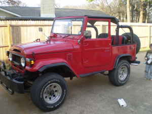

Given that it appears to be a buyers market, what do you think I should offer for it? Anything look strange in the pictures?

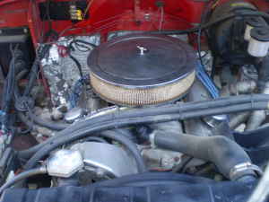

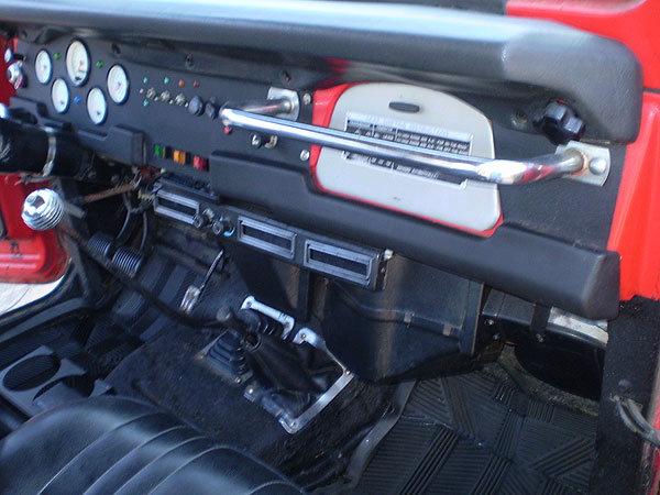

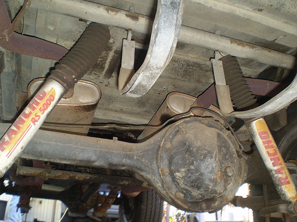

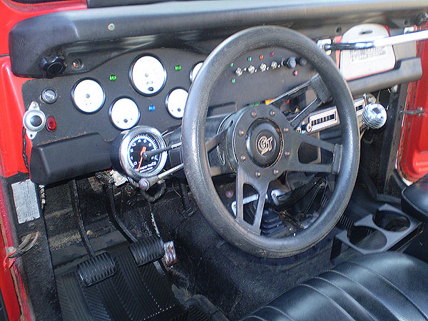

Looks like it may have had an extra tank underneath it. The cost really depends on you. It's not stock so you are going to have to worry about who did the v8 conversion and if it was done correctly, safely? Do all of the gauges work? Is there any vibration in the driveline? The rig does look good and I agree with 3J, I'd offer near 5 but he's going to want alot more.
No mechanical issues as of this second..
There will be issues. Overheating seems to be a big one among most swaps.
Nothing that can't be overcome with $$ and ingenuity;)
Looks like a sweet rig. If it's put together well, most I've seen are in the 10k range.
Being the market it is, and depending on how motivated he is to sell, I'd have to say 6k+
