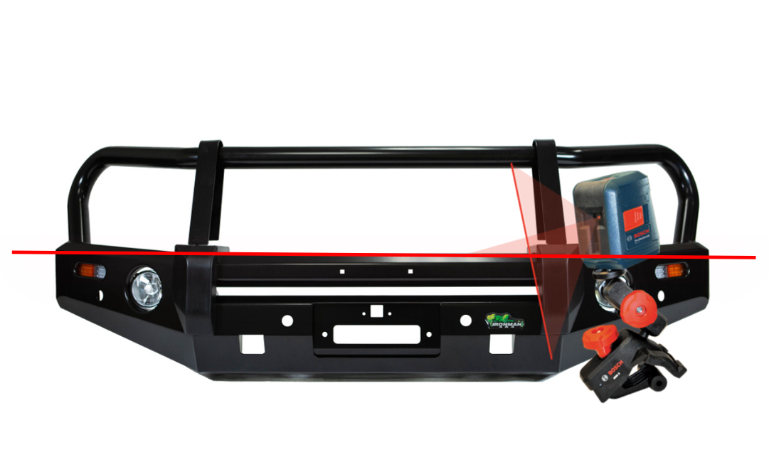

I have a Iron man premium bumper See here the link to the exact part Premium Off Road Bumper Suited For 2014+ Lexus GX460 - https://ironman4x4america.com/premium-off-road-bumper-suited-for-2014-lexus-gx460/
I am installing it this and was hoping you guys would please help me get a rough idea or measurements from your current install, If you could give me reference points for at least one side (since the other will match symmetrically) and then some reference points in the middle.
Basically if you guys already have your ironman premium bumper on already and its lined great like shop fitted and clean, then please put a tape on it and kindly share accurate measurements you have. I think the easiest way is to put a laser level on it, and then tell me that point you put the lazer on and then measure off of that measure each change in point/angle/direction etc.
I GREATLY APPRECIATE YOUR HELP HERE!!!
I promise when I am finished I will take all these notes down and make a guide for the next person doing this after me, the instructions from Iron man are trash.
THANKS GUYS!!!
