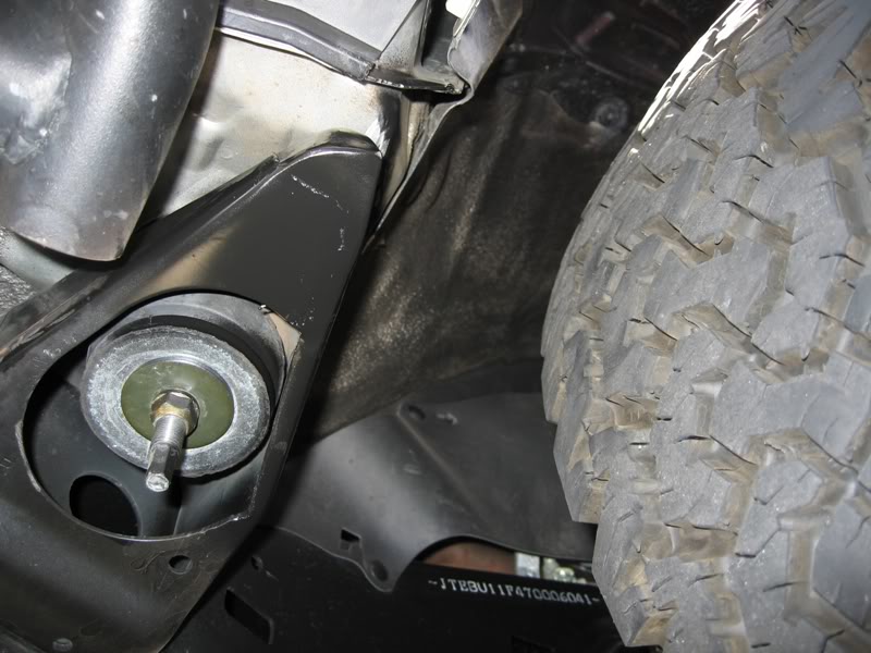

I'm looking for a shop near me that can help me perform this body mount trim. Toyota used the same platform to build the FJ as the Prada (some Euro SUV) and the body mount hangs into the wheel well which gets in the way of putting bigger tires on it. I would give it a try myself but with limited welding skills (and no equipment), I need to find someone that can do this for me. See pics below on the two methods being done on the FJ body mounts.
Hope the pics help with what my objective is. One guys cuts then fabs a new piece while the other just takes a "pie piece" out of the mount, pounds it back and re-welds. Either way, it allows up to 35's and takes away any rubbing issues when fully articulated (with front swaybar removed)

But I've seen threads with people saying they just took a sawzall to it. I wouldn't feel good about that. But I wouldn't feel real bad about it the way I use mine. Baja? No. Mint 400? No. 1/2mph at Tellico? I'm not sure you could put enough load on that mount to collapse it. Might preclude going for long distance air but any sane driving I don't think would risk it.
I've also seen that rubbing has only occurred in extreme conditiions. I'm thinking that in the very slow motion wheeling we do how much problem could it cause you if it did bump?

Mostly, it could tear up the tires and be annoying. With the tires I'm planning, I shouldn't have any issues. Mostly want to clean up the wheel well just in case and/or if I want to get a taller tire.
re - body lifts...my guess is that nobody is making anything specific yet for the FJ and that the benefit isn't there. Better suspension (OME/AllPro/Donohoe) gives some lift with increased performance with spacer lifts both increase the COG and a body lift would only do that more which I wouldn't want to do. But, I'll bet we will see them in the near future...
