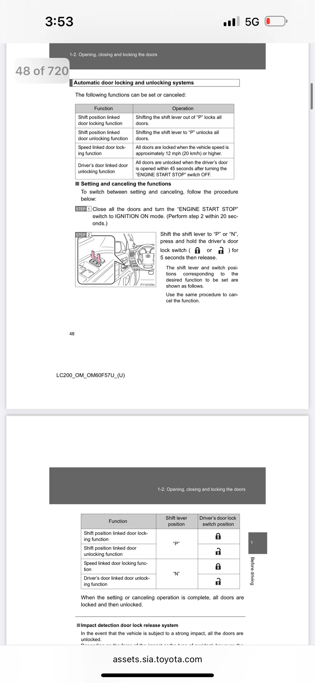

ok this is my last attempt haha
this is from a 2014 manual:
good luck
You’ll need to get someone with techstream to poke around in the CANBUS system to see if it is a selectable option.
Alternately you could try getting a Bluetooth OBD module and see if their software allows configuration changes like that. I know from experience the Carista product does allow some of these.. though I can’t remember whether that specific spec is an option.
