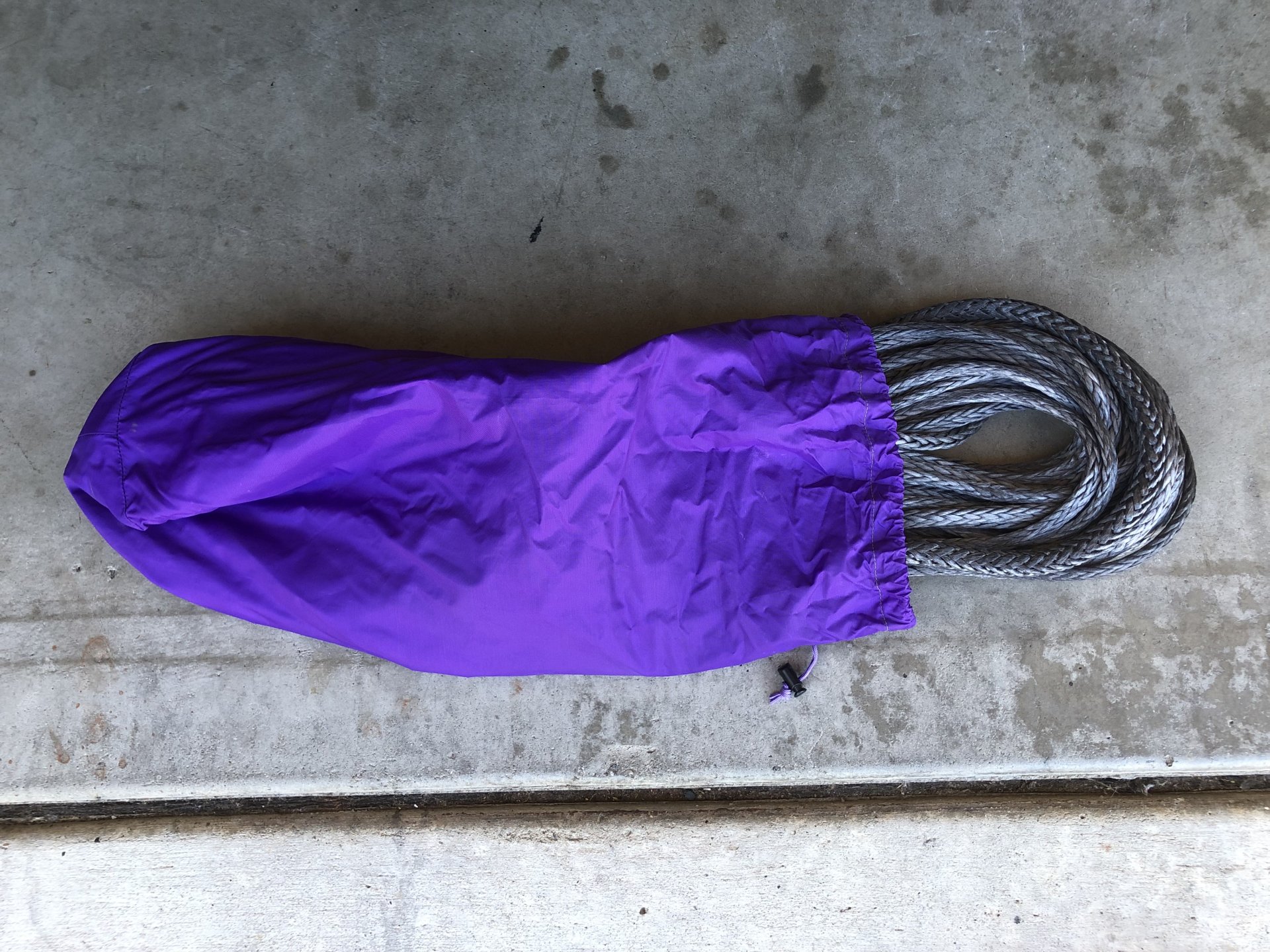

I have one of these for an extension..you have to splice the end that would go onto the winch drum though…I spliced my own 😉
I have one of these for an extension..you have to splice the end that would go onto the winch drum though…I spliced my own 😉View attachment 3030482
About how big is that? Trying to get an understanding of how much space whatever I get will take up
You can always double up a long extension rope if less distance is needed.

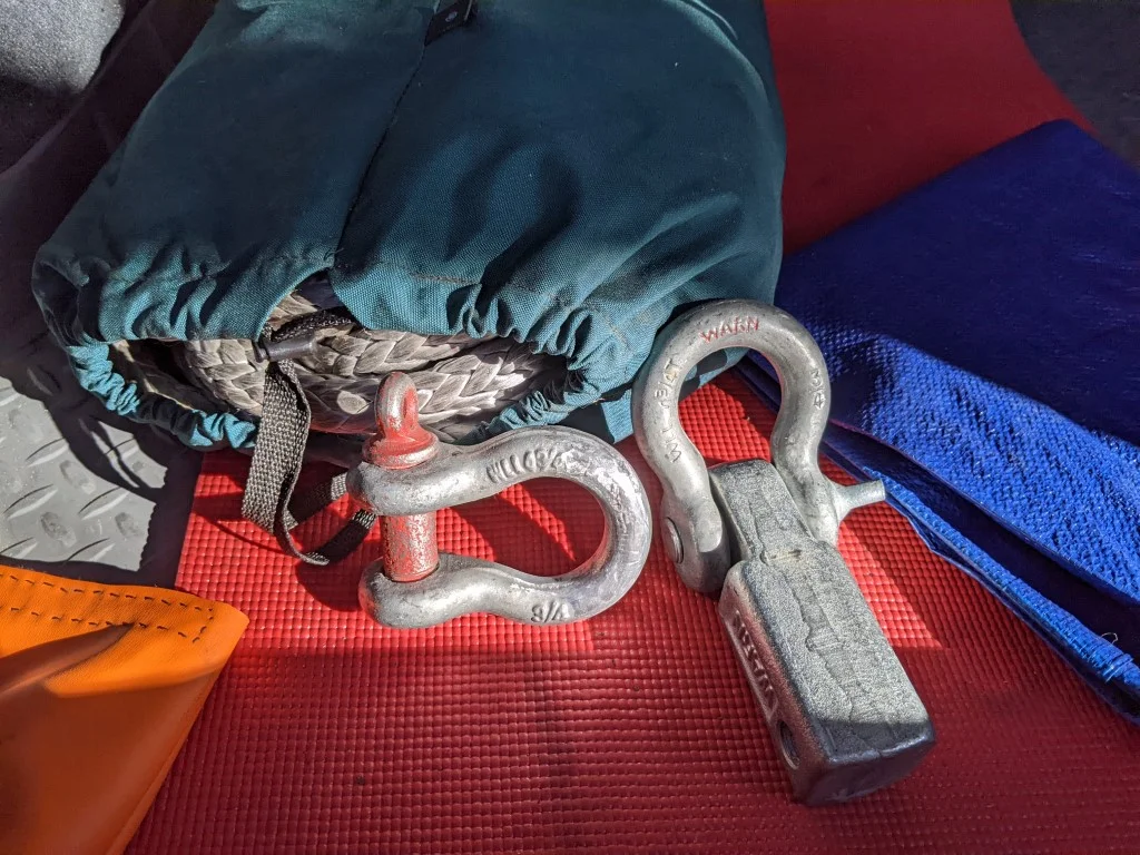

And old-style D-ring shackles are not such a bad thing. When you need to hook onto another vehicle, they may be the better option.

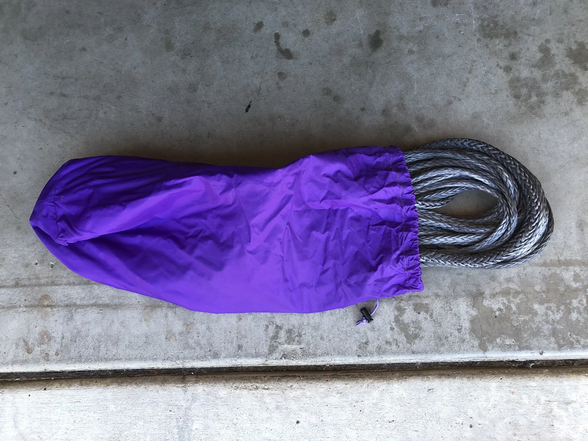

I just put my extension in a bag..
^ Same here, extension in a heavy duty bag.

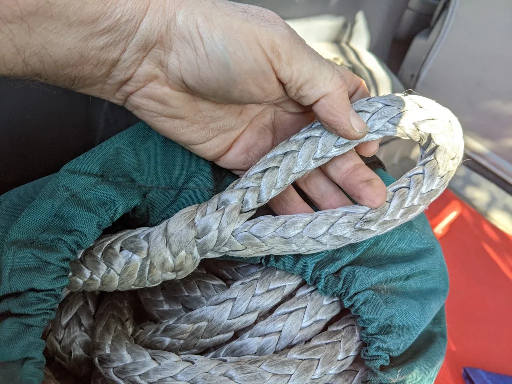

5/8" synthetic bought quite a few years ago on ebay from a fella that got off cuts front amsteel and back then a bargain. About 90' of it.
And yeah, good to have old school shackles and used them a few times my past trip to DV to rescue folk.
