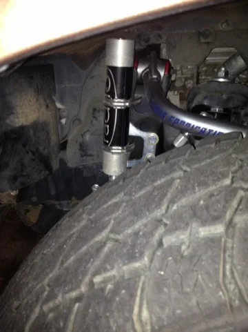

PROBLEM: At full turn, I'm smashing my Slee resivoirs and rubbing fender on other side. Yes, I knew this was going to happen, but does anyone think I can mount them on top of the frame? I've seen other 100's with resivoirs and do they have that problem? What about wheel spacers to reduce/eliminate rub? BTW, Discount Tires told me that they wouldn't work on my truck if I had spacers. Does anyone think they would void my warranty if I had spacers on? What about a body lift? Should I just do it on the front or on all four? If I do it on the rear, do I run the risk of ruining my rear fenders when completely tucked?

This is the safest position for remote reservoirs.

Ok bro, that is AWESOME X 1000! What kind of mount is that? Where can I get one?
MetalTech makes them in house. Requires two holes/self tapping bolts in the UCA mount.
Nice....let me email LT right now and see what's up. Guess some good ol zip ties won't work, huh?

For the TC UCA's I'd recommend the 1" from JT/Carl. High quality. At 1" I have contact at full compression at the fender rim. Not with the metal, but with the fender liner. This is with 295/70R18's. You may have it different with the 315's. You'll also likely need to trim the rear liner above the nose of the slider as well as bend over the pinch weld. A 1" Body Lift would help too, but again I'd go back to really defining what your goal is for all of the mods.
Out of curiosity, what is the total stroke of those front shocks? Hard to tell exactly from the pics, but they look short compared to mine.
And FWIW, I had my reservoirs mounted on the frame rail where you have them at first because it's a better angle for the hose. Found out like you did that avoiding rub isn't possible.
