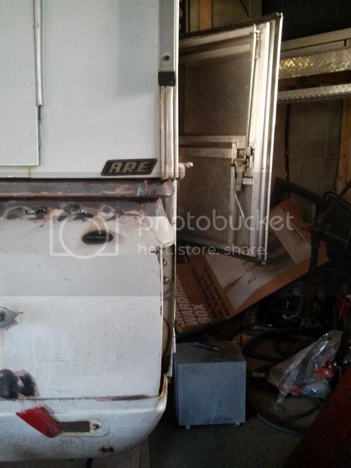

Thanks, just reset my phone and forgot to post some pictures when I got off shift. I'll try to get some pictures up asap. I'll look on my photobucket for pics when I was building in the meantime.
this was before I cut it I think, tongue should end right at or before the end of the picture.
The top was my first thought on tongue mount but went with a lower, heavier wall hitch.
What needs to happen, and I'd be the first to say it ain't gonna happen if it were my trailer, is to swap the bed 180° on the frame. Then the fore/aft weight distribution will be much closer and much harder to load wrong.
If you have a spare and it isn't mounted up front now, it should be. Any other permanent mods need to be mounted in front of the bed.
There is a hitch I mounted in the rear of the bed. For future accessories or to be able to tow back out of somewhere in a pinch without turning the trailer or any randomness from life happening. planned for a spare tire on the tongue later on as well as a beefy jack/stand. It has two (empty now) locking 5 gallon fuel tanks mounted there. But thats all once i get it from florida to tennessee and can tweak and refine as needed. I havent tried towing it in reverse, would the shackles forward cause any weird handling issues to tow backwards? I may have a few hours to tinker since im down for thanksgiving but not attempting to tow it back this time. Thanks
Mine is similar....only on a Datsun bed/frame. Was hauling butt on the highway fully loaded and always tracks nice and tight. I have a truck tool box ahead of the bed and just as it turns out, the wheelbase from the trailer axle to cruzers rear axle is about the same as the cruzers wheelbase. Don't know if that has anything to do with wobble.
found the picture I snapped after welding on shock mounts with raised hitch shown, vs straight hitch when I had death wobble.
before I went and picked up the roll cage which went around the front of the topper, tongue side.
