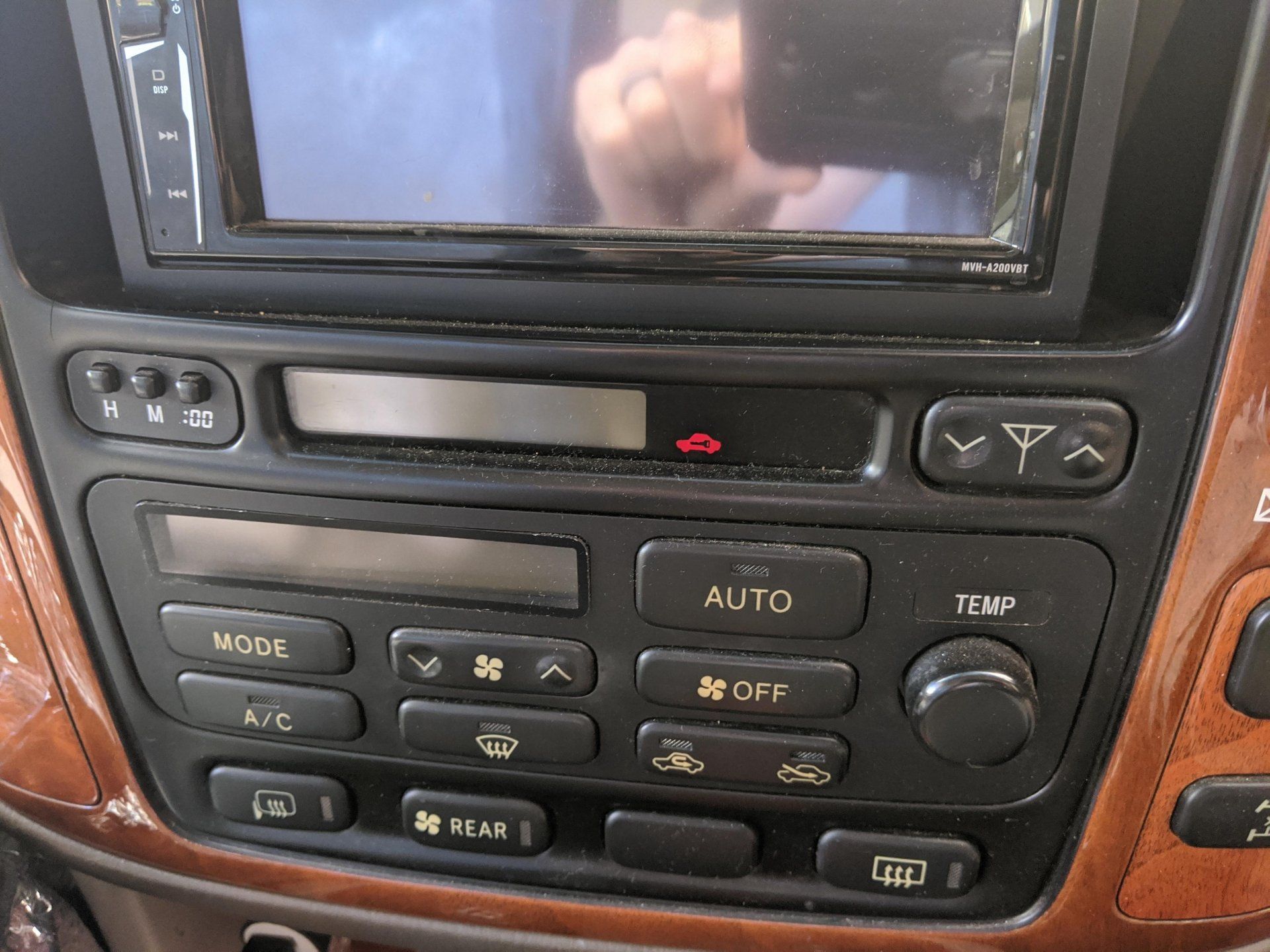

OK so i found the flashing light which i thought would be on the drivers dash and if its this one (in the pic) then it turns off straight away with the key fob key but if you insert only the keyblade it keeps flashing. Is this the same on the US versions? or is it up on the speedo dash?
Assuming my understanding , the light going out straight away means its the master key?
YES....that is it.
It is responding as it should. That light (when a key is not in the ignition) is ALWAYS flashing, its just that you can't really see it very well in the daylight.
A MASTER KEY will cause that light to go out immediately when the key is inserted into the ignition tumbler.
The key blank/shank will NOT turn it off or start the vehicle because no transponder is present. BUT if you hold the other key (with transponder head on it) right near the ignition, while inserting the key shank....I bet it will start the vehicle. To use the second key (to start the car) you'll need a transponder head for it and program it.
Some folks even zip tie a working transponder behind the dash panel (right up against the ignition tumbler) and then use cut keys to start the vehicle. It will NOT start without a working transponder near the ignition.
Excellent, thank god i have the master key. Lexus quoted me $1800 to replace if not! Yowch
