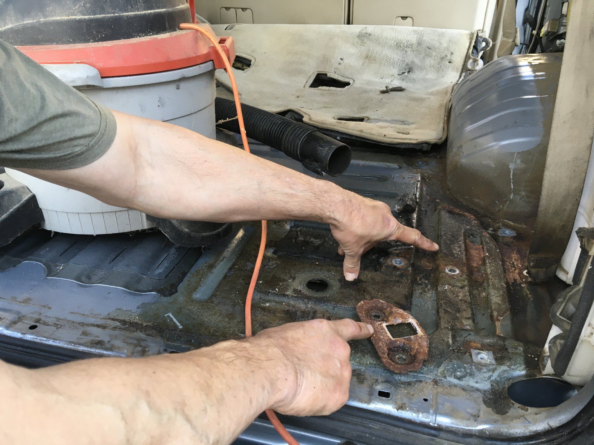

Noticed that the cargo carpet looked funny on the passenger side and there was some rust on one of the seat brackets. Pulled up the carpet and found RUST! Grrrr! Looks like they spilled something caustic in that corner and it seems to have melted some of the dynamat. Any pointers on getting this fixed up? Also, what is the white plastic assembly in the corner? Rear a/c? How hard is it to remove?

I'll be following this as I have a similar situation with my rig. I pulled my carpet up and found half a beach worth of sand that caused some rust. I plan to just have a body shop take care of mine, but I'm curious to see what the suggestions are and how you proceed.
Yeah, I’m up in the air on whether it’s worth having a body shop handle it or if I can fully get rid of it myself.
from the first pic, hard to tell, but it looks like surface rust, wire brush/wire wheel and prime and paint, or rust convertor type product
get a new/used plate and put it back together
