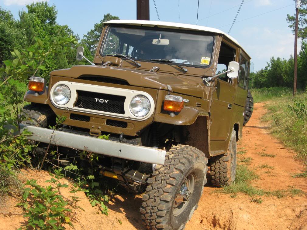

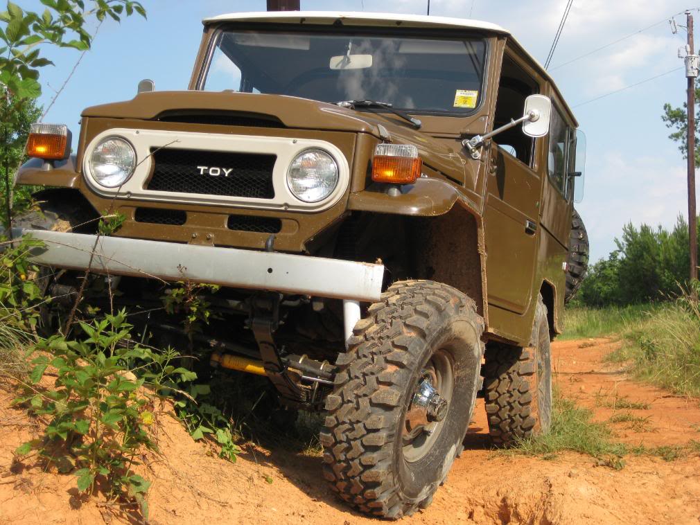

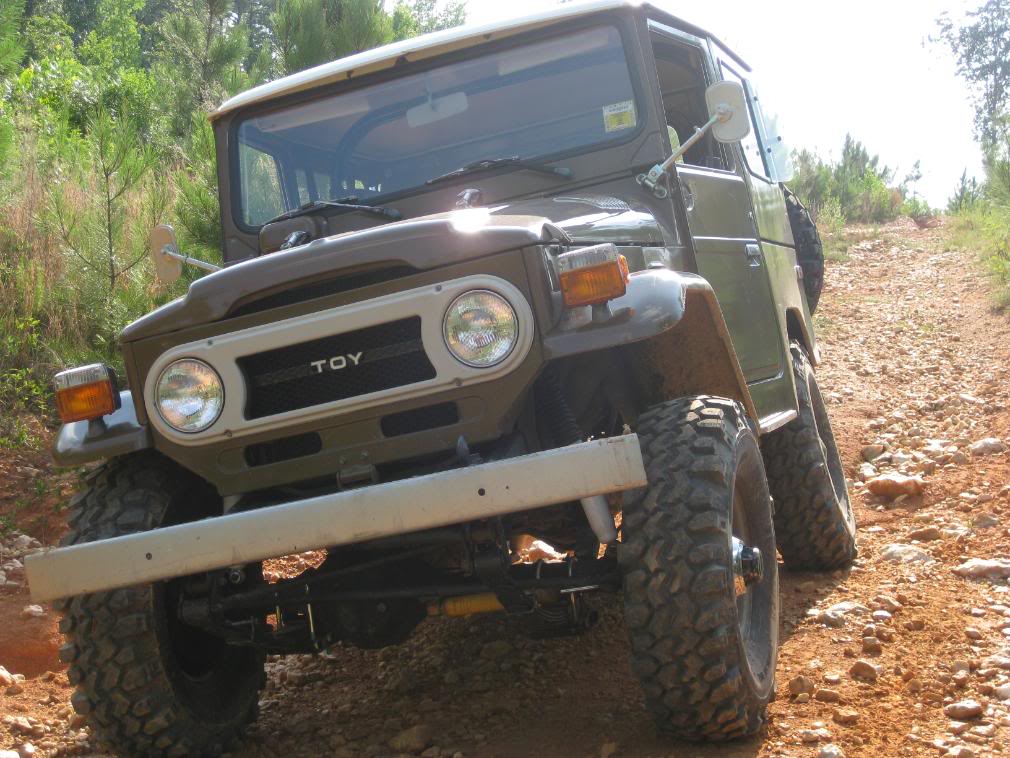

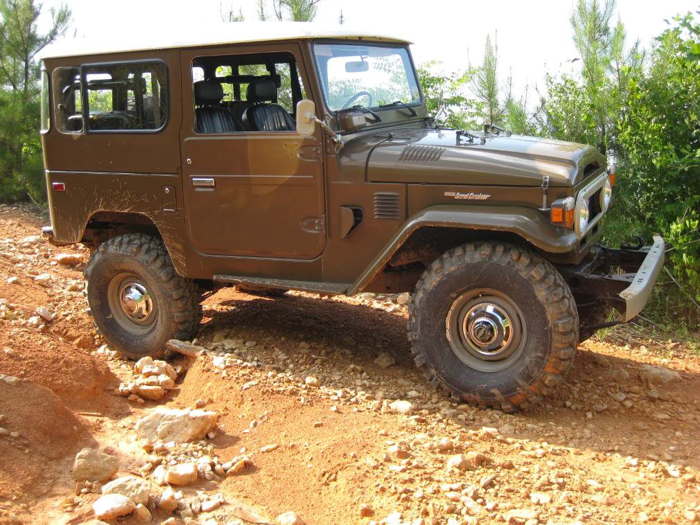

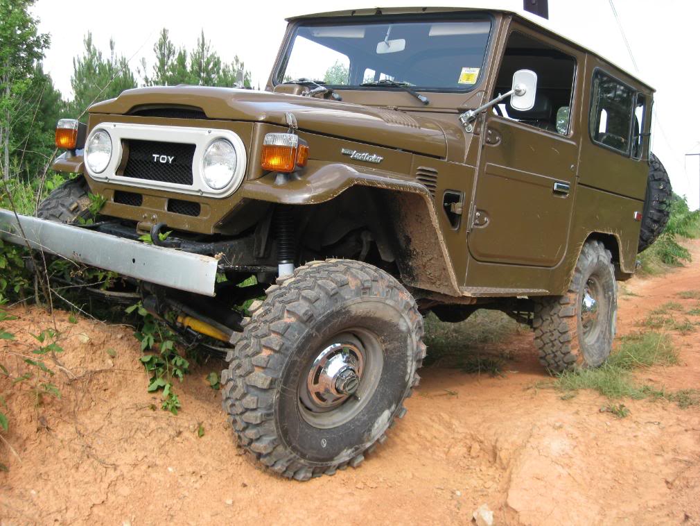

Hi All,
Well after several questions in my Hell Creek and LTB thread, here it is finished with the LTB's installed. Finished it up, took it out on some local power line trails to flex the springs a bit. Leaving in a few to hit them again this evening. It is NOT good on the road, but bad a$$ on the trail so far.
Thanks again for all the answers and comments/suggestions.
Here are few pics.
BTW - specs:
- Stock shackles
- Hell Creek 4" lift
- 34x10.50x15 SS LTB's
- Stock everything else.
- no power steering yet.
- Very squirley on the road
- HardTop scrubs top of garage
Anyway, still need to find some extended brake lines (not interested in the stainless braided, just black/stock type). Still trying to locate them.
Not sure if I will put 1.5 + shackles on the rear to level up a bit...tires do not rub so far with stock shackles.
Lots of rigs on here were inspiration, hope you guys enjoy.
Brad
