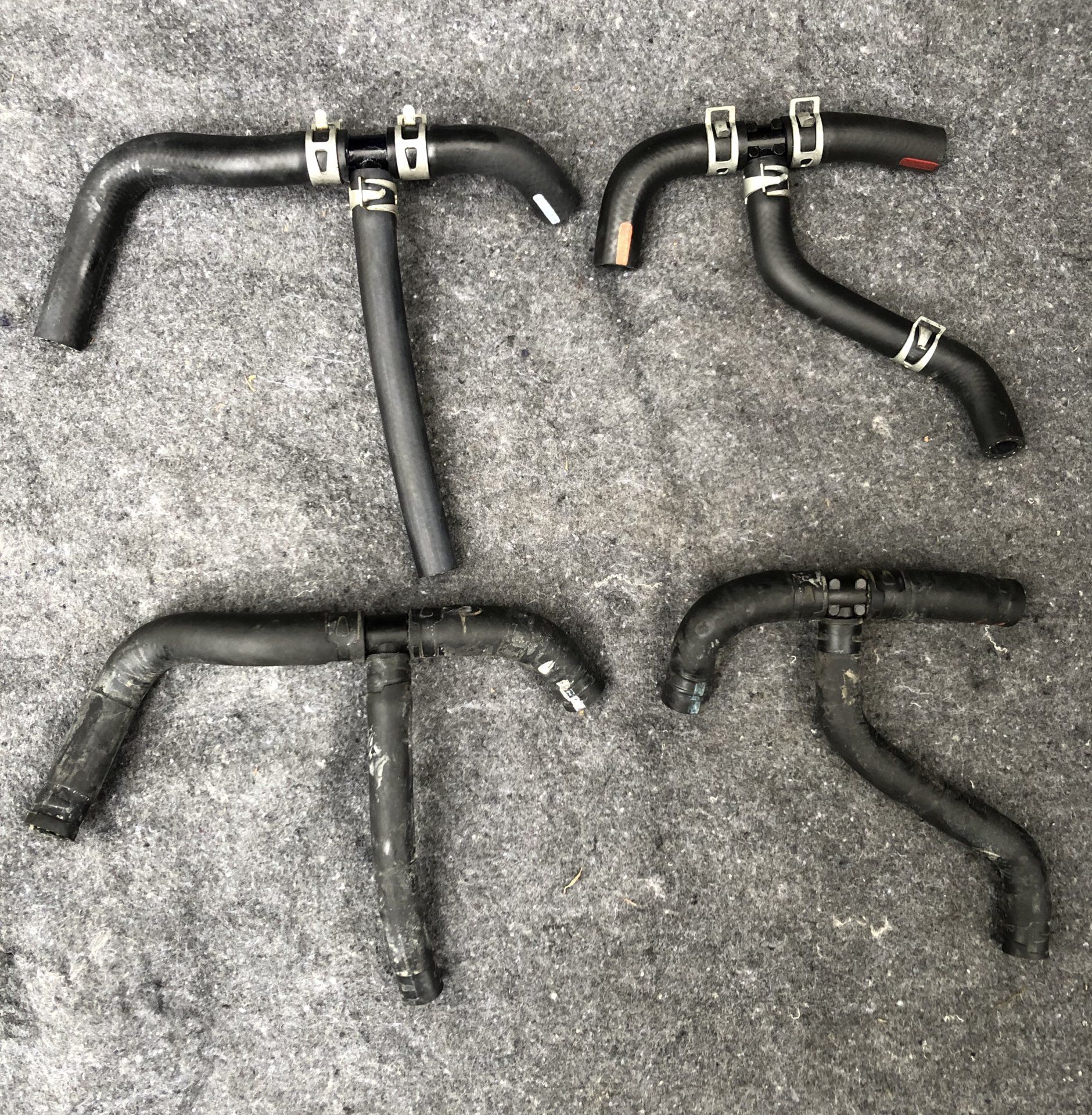

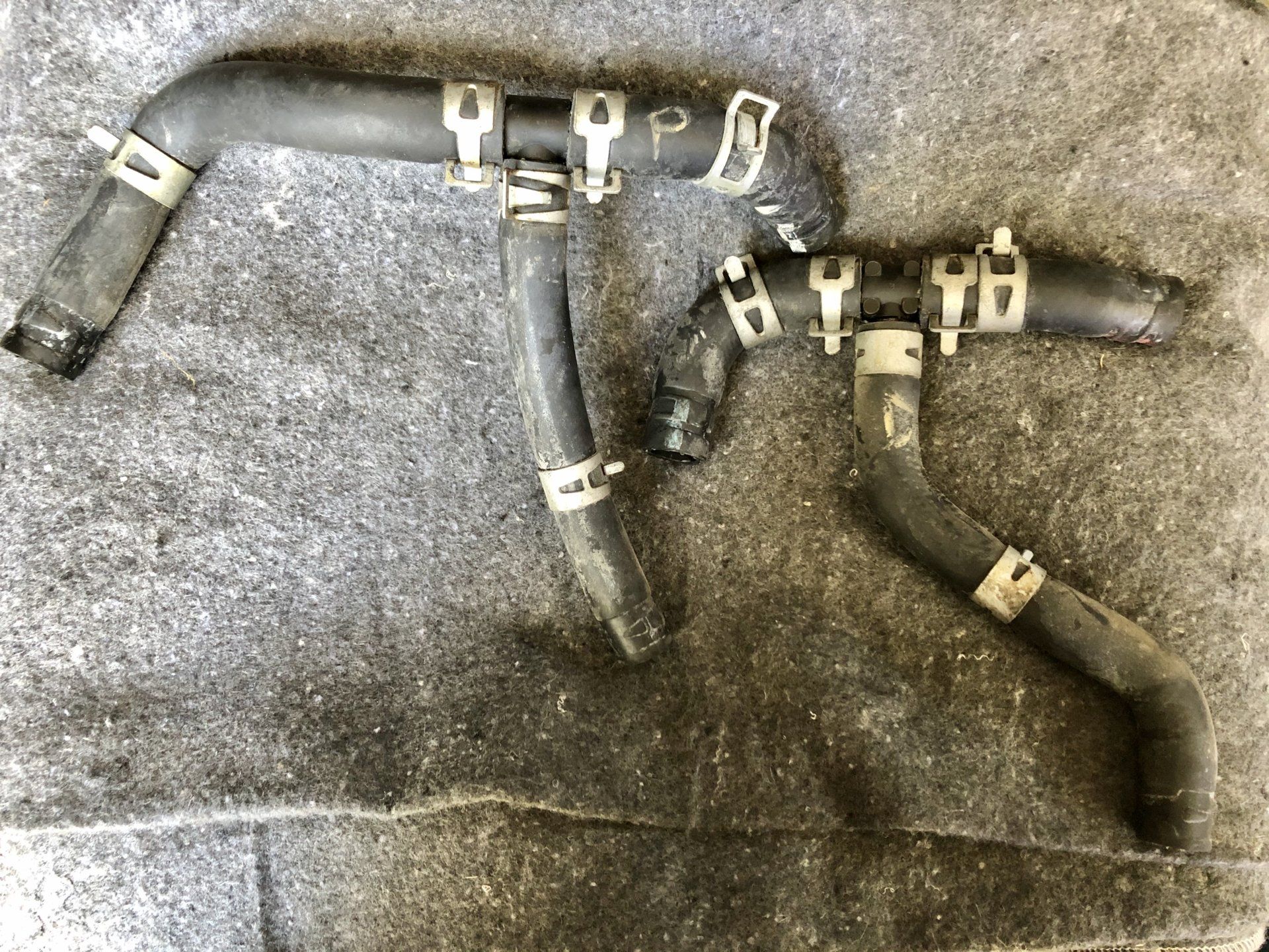

Assembled and ready to go back in. Tees are actually in good shape, not soft or broken at all. Hoses are definitely swollen. @gregnash I’d already put the clamps on by the time I saw your post so I’ll fool with it a bit as is and go from there.
Yeah it is not absolutely necessary... just allows for you to position hoses a little easier without having to muck with things. Then you also have the ability to position the clamps too once you have everything set in place.
Went in just right, pre-assembled definitely the way to go. I had all clamps in place and pretty much positioned how I wanted them. Installed passenger side first - was very easy. The driver side was a little more difficult as the top hoses are shorter and there is less room to adjust. On both I tried connecting the bottom hose first. For passenger side this worked great as there is more ability to make adjustments to connect the other hoses. For driver side I tried the same but wound up having to connect the top two hoses first which made it a bit of a pain to connect the bottom hose and position the clamp.

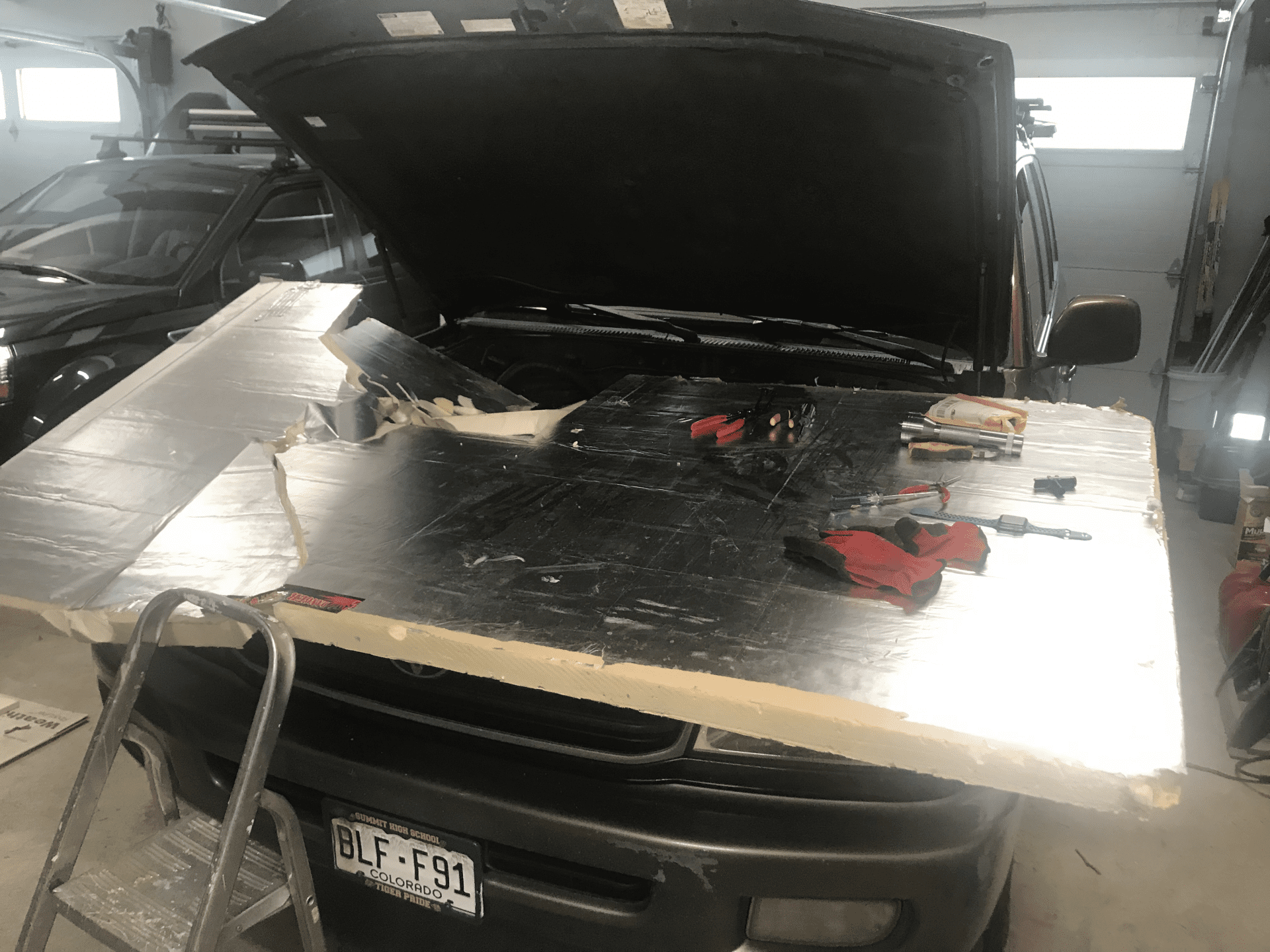

this s a PIA job - this time I used an old piece of insulting board to gain easy access to the clamps - made the job much better than the previous time I did it.......
