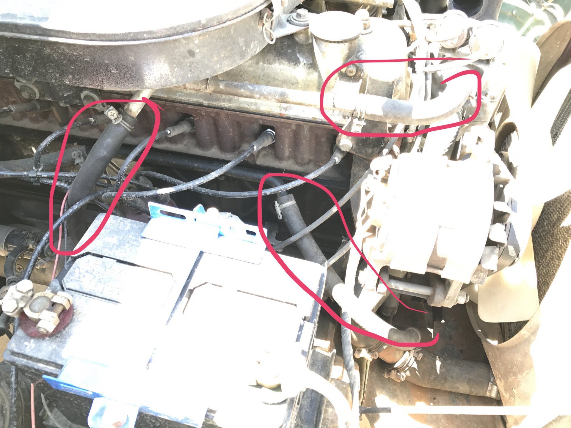

I've looked everywhere I can think of and can't find these hoses (circled in red). Can any of you guys help me out with part numbers?

The upper right hose is an oil cooler hose part # 15777-61010.
The other 2 hoses are just straight heater hoses. 5/8" ID will work.
If you're going to replace all those hoses, I suggest you replace the metal pipe also. Part # 15707-61010.

The upper one is connected to the thermostat housing. Is that normal for an oil cooler hose?
