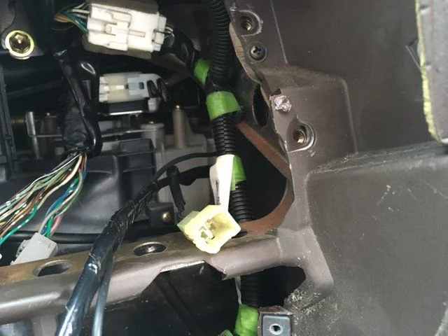

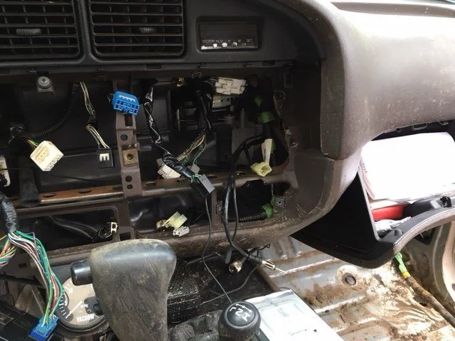

To the OP, before the massive high jack. I have the same issue, fist I tried over riding the cable and moving the valve to hot. Nothing. Both heater hoses are hot, inside is cold air. Removed stereo to find the servo motor which controls cable and a flap closing air off from heater core. Mine was jammed with antenna cable. I have pics on my phone and can text them to someone that can post.
I would love to see those pics! I think my 80 is having this exact same problem.

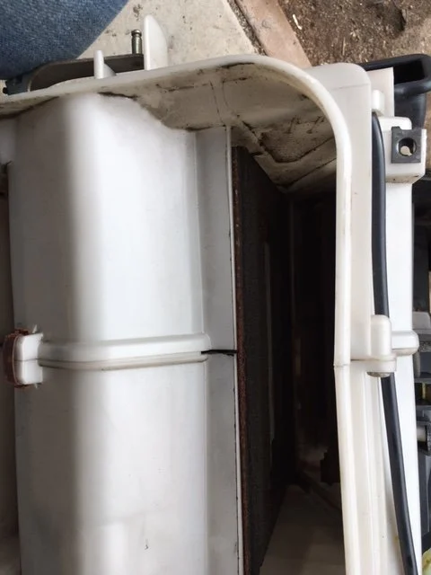

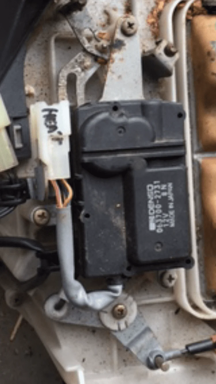

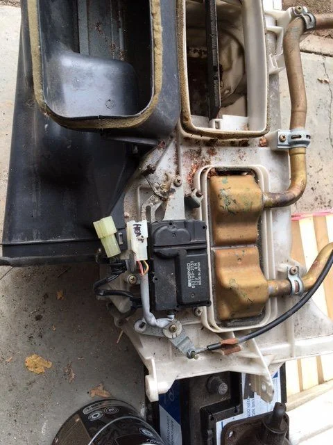

Ok, so the first pic shows the servo on top of the heater box, second shows the flap door, sort of. This is from the the fan box removed view. All you see from a complete truck is through the hole when the radio is removed. There is more room than it looks like, but not much
Thanks for the description of the pics. So if a person wanted to manually open the air flap to the heater, where is that relative to the removed radio? Assuming the servo has failed?
I'm cold in MN and a little desperate to get heat in my 80! Even if it's temporary until I can solve the problem correctly.
There is a metal rod approx 3" long connecting the motor to the flap door. Look for little white clips similar to door lock rod bushings. Unhook and move door with cable together. You will pull toward the left

I'm super slow sometimes, but I think I've finally gotten it. This black device pictured is the heater servo. This thing fails and the air flow does not open with the heater controls. I could swear a lot and get those screws out and replace the servo. Or I could temporarily disconnect it for the winter and just open the air flap manually.
