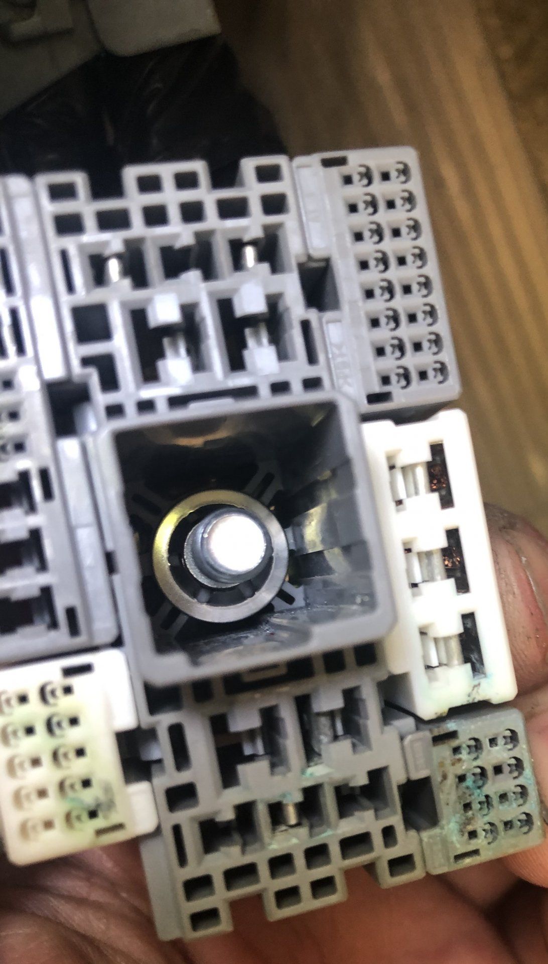

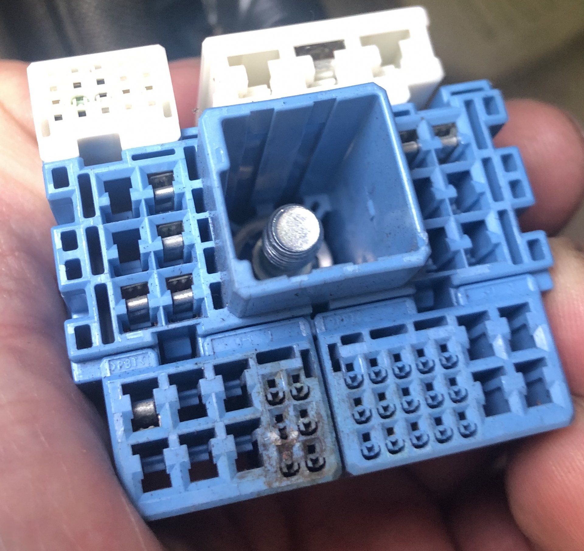

More digging after the problem returned...
Found this in the 3 multipin connectors in the DS kick board
Moral of the story - keep your sunroof drains flowing properly. I cleaned these up with a soft bristle brush and some baking powder to help keep the corrossion at bay, after blowing everything out with compressed air. Problems are gone for now, hopefully for good.
Deoxit also works well for cleaning corroded connectors, plus some dielectric grease to prevent future corrosion.
