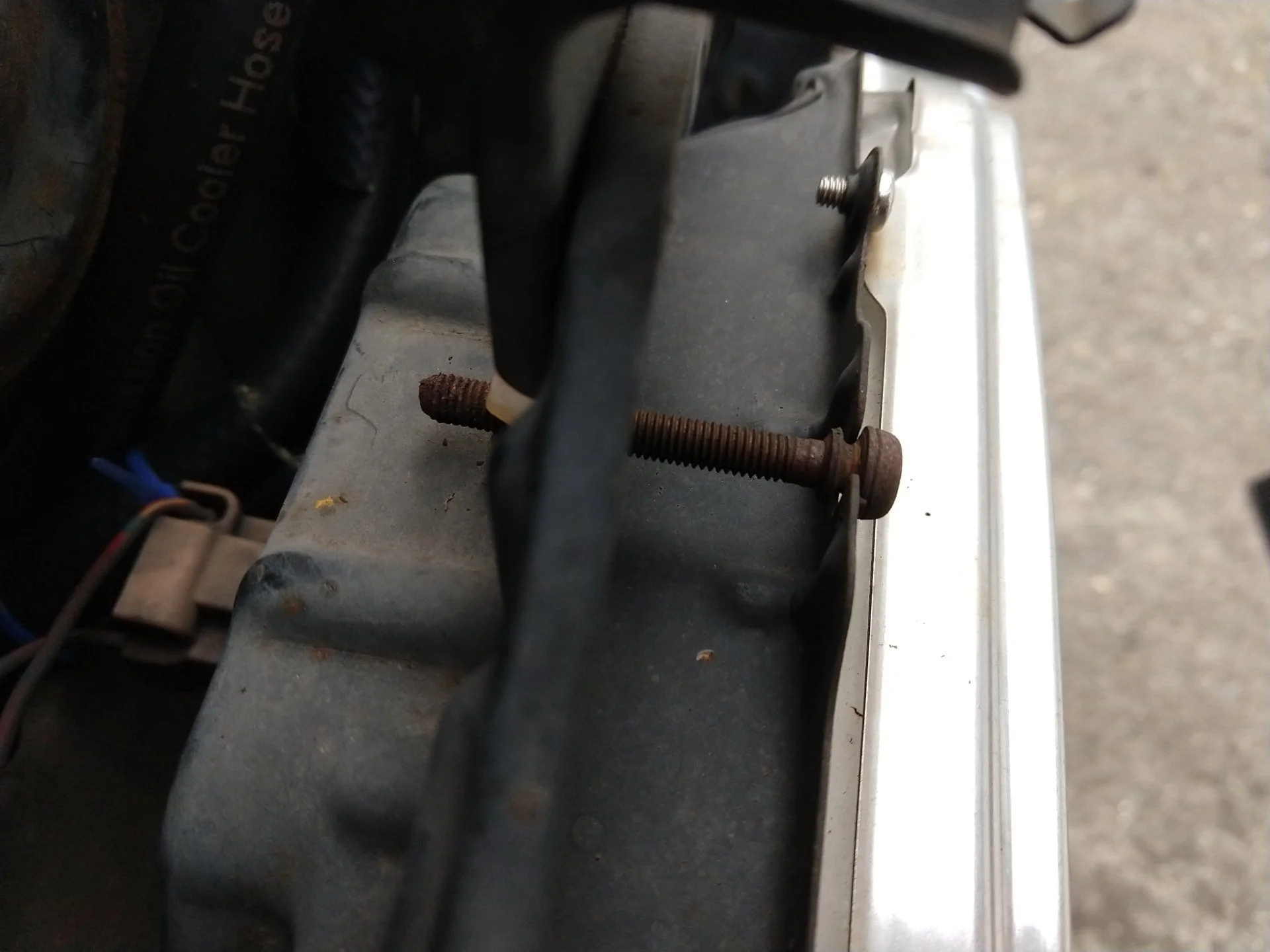

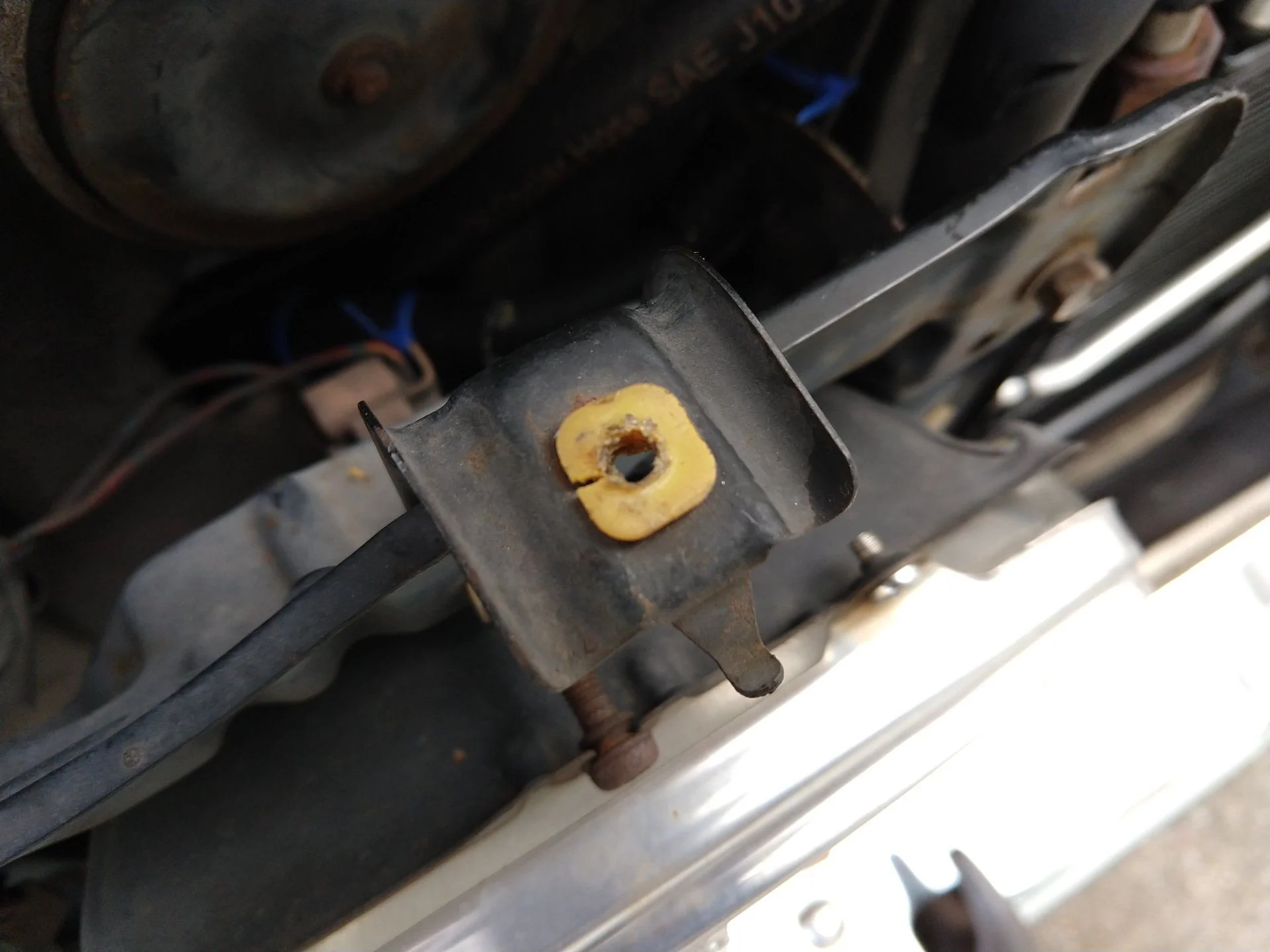

Title says it all.
Looking for replacement plastic retainers for screwing in the grill.
Also looking to find replacement screws that are used for adjusting the angle on the bulb. There are two per each headlight. But they have a lip to them.
If NLA, what are people using as alternatives?
Bought some stainless steel replacement machine screws for the cages, but would like to get new hardware all the way around.
Thank you!

Yup, I could paste in the part numbers but I feel really lazy. Ugh. Screw it. Sort through it, this is basically everything for headlamps. I got lazy and stopped putting quantities I ordered. Whoops.
81119-1A270Headlamp Adjusting Screw
90160-40002Corner Lamp Mounting Screws (8)
90189-04069Corner Lamp Mounting Grommets (8)
90154-50001Headlight Door Mounting Screws (8)
90189-05013Headlight Door Mounting Grommets (8)
93311-16012Screw W Washer
81121-62010Spring Adjusting
81136-12571Headlamp Assembly Screw
81111-89117Sealed Beam Retainer Ring (Left and Right)
90189-05013Headlamp Self Locking nut (grommet)

I bought some retainers from Ace. I did have to trim a mm or so off but they tapped in fine and hold the screws in tight.
Thank you everyone for the feedback. I was able to find the 16 small screws that hold in the four headlights on the 62 at about $0.17/each. So that was great over at Ace Hardware, but the adjusting screw and the grommet/self-locking nut were obnoxious.
Appreciate all the part numbers @mattressking and the link @Borrego . I took a look last weekend @NeverGiveUpYota at my Ace Hardware ( when I was able to get some of the screws) but they were lacking in their assortment. Nice to know that 1. They are still available and 2. I can buy 25 of them for under $10 on the internetz.

Hey gang, just finding this thread. Any chance anyone has a specific name or part number for me to purchase these grommets / plastic screw holders for my FJ62 headlamp grills? I'm in the same boat as the first image posted here whereas I have the screws / new chrome grills but all the plastic holders are rotted out. See options online but unsure of which ones will fit or work for me?
