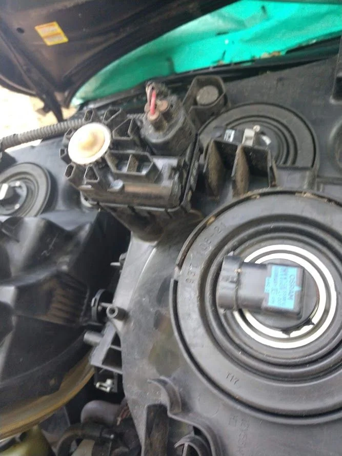

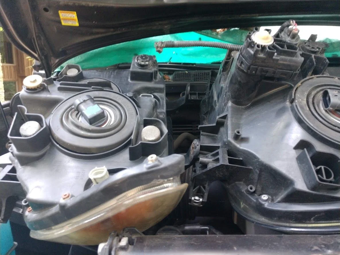

I compared the back of the headlight assemblies because I was always curious if you could just buy the motors and add them on. Not likely. They look to be different moldings all together.
The connectors are all the same for the lights themselves. So if you aren't going to get the the wiring modifications for a while you can just install the new housing assemblies and drive for now. Thats what I did since I swapped these from truck to truck at a friends house.
A few more pics of the backs:

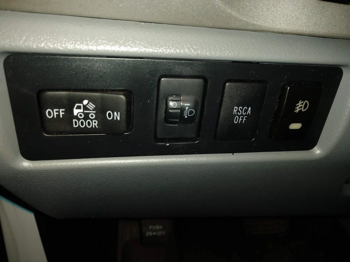

For the beam adjusting roller switch thing- Just pop it out of the dash. Its just tension clips holding this in place and you should have a blank spot in your dash to install this to the left of the steering column- as long as you didn't go adding a bunch of useless light bars and dumb s*** to use up all those spots.

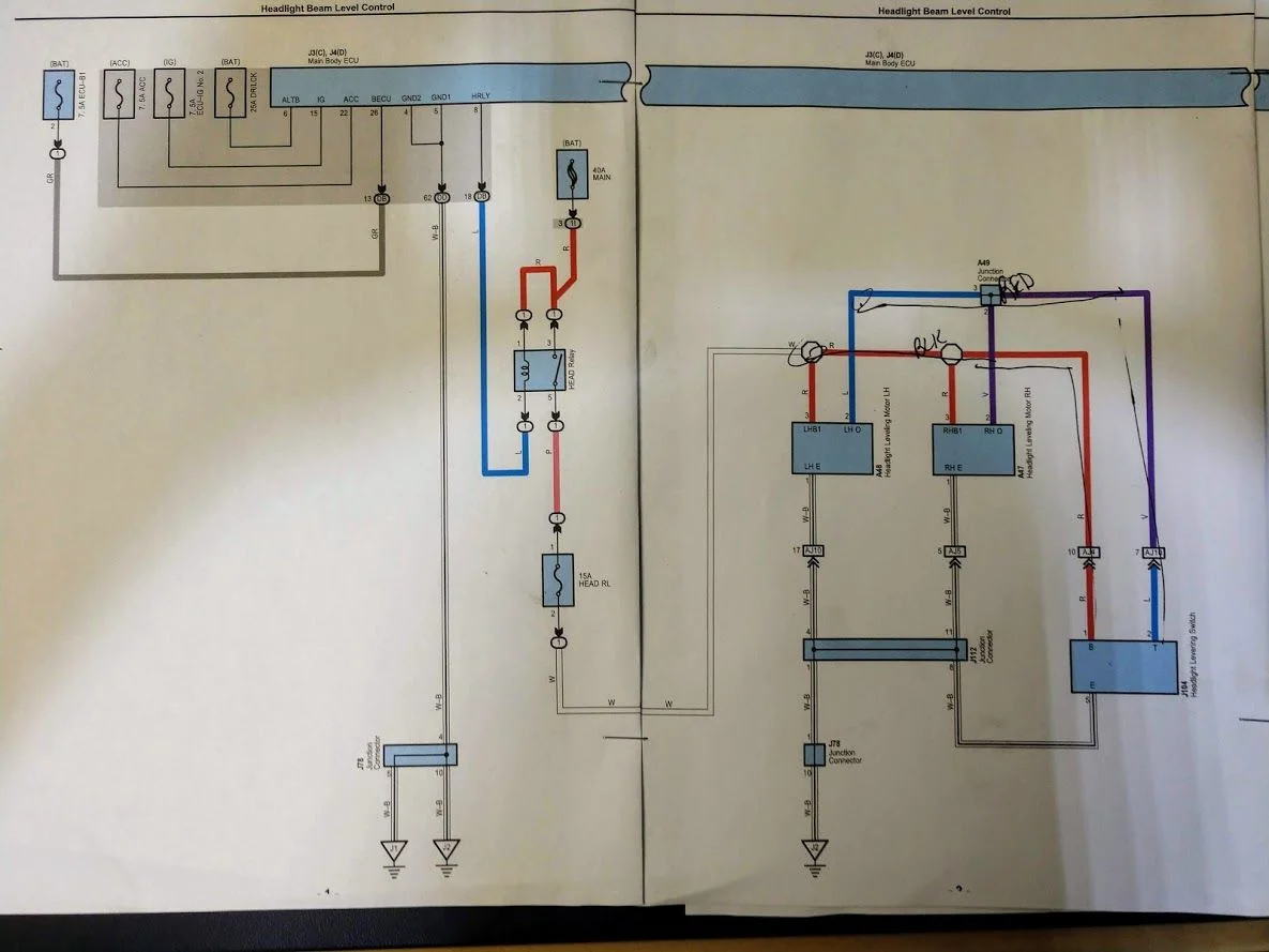

And for the most difficult part which is easy enough if you understand some basic wiring diagrams.

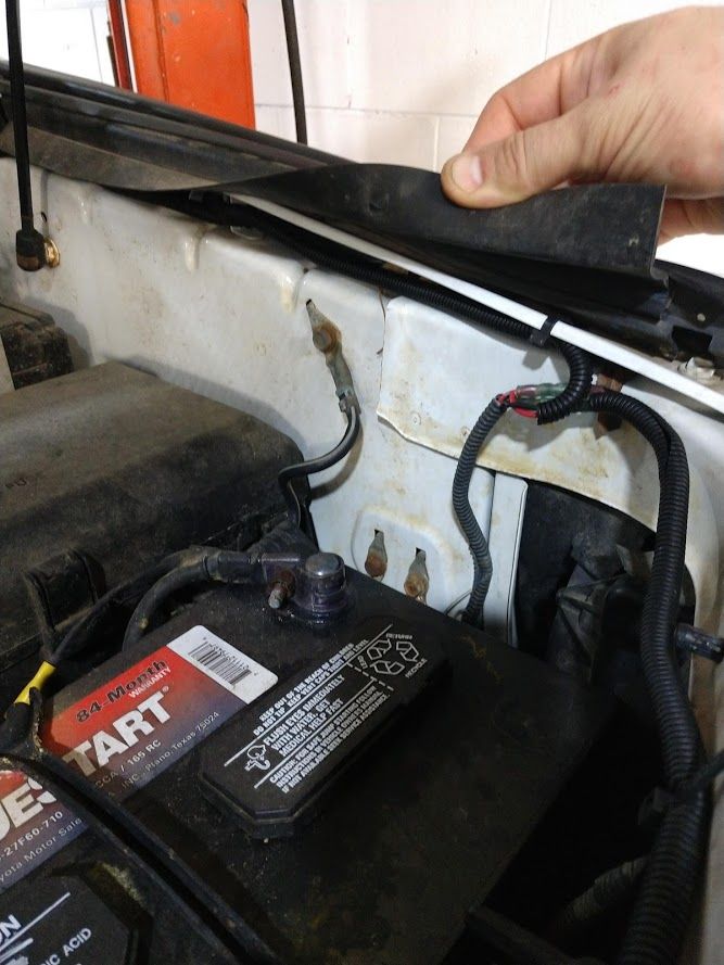

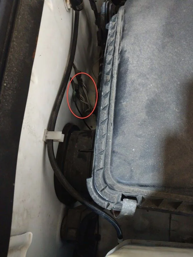

I ran the two control wires from the switch out to the headlamp motors and T'd them in as shown in the diagram. You can also see in the diagram that one of the motor wires tees in and gets power from the right low beam headlight wire. Not sure why, but ok.
I hope this diagram can help someone and just ignore my scribblings that no longer even make sense to me.

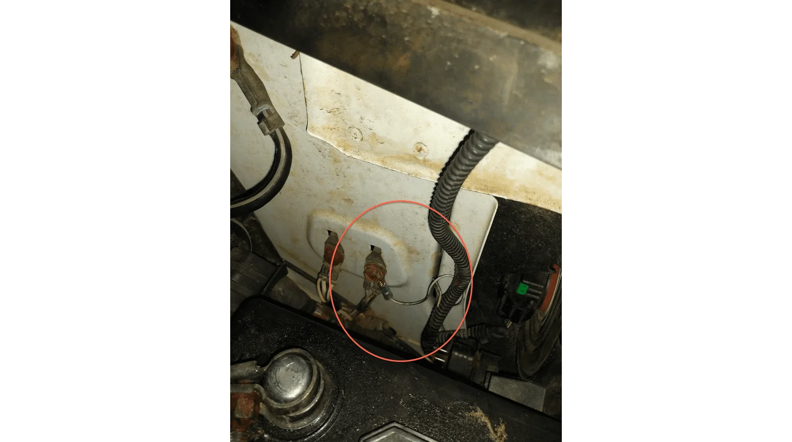

For the headlamp motor grounds I just ran the wires from the headlamp motors to existing grounds nearby.

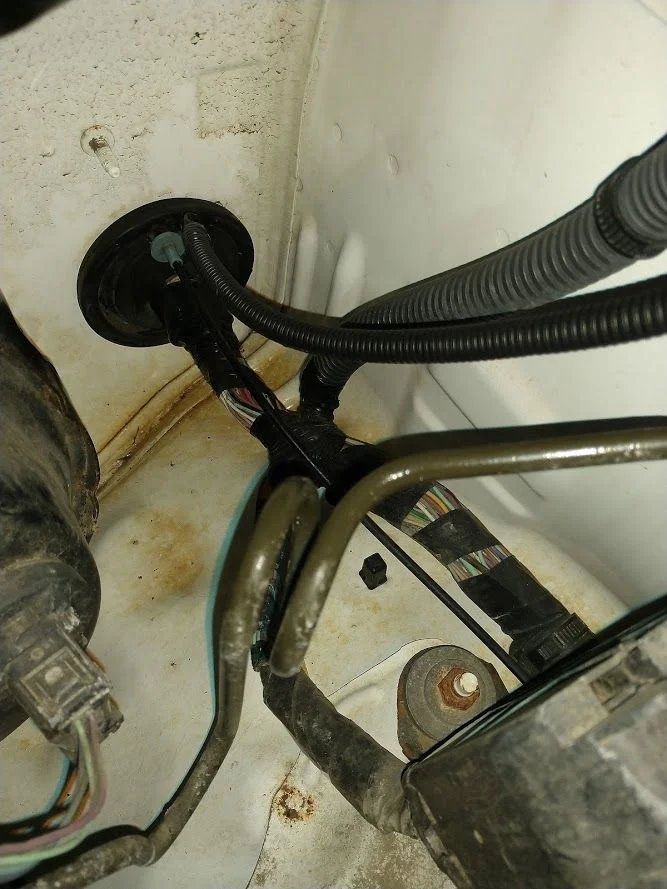

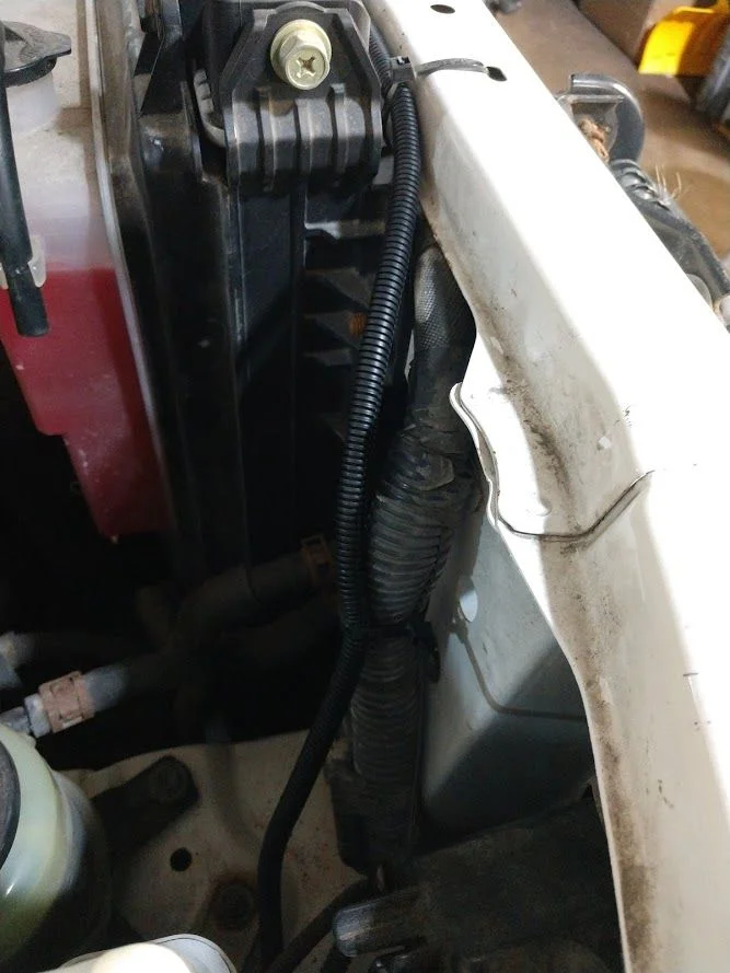

Then I routed the control wires from the motors into the cab and to the switch.
And finally where the wiring enters the cab. I slathered some liquid electric tape over the new grommet hole later.
Yes there is some surface rust under the hood...... Welcome to illinois.
