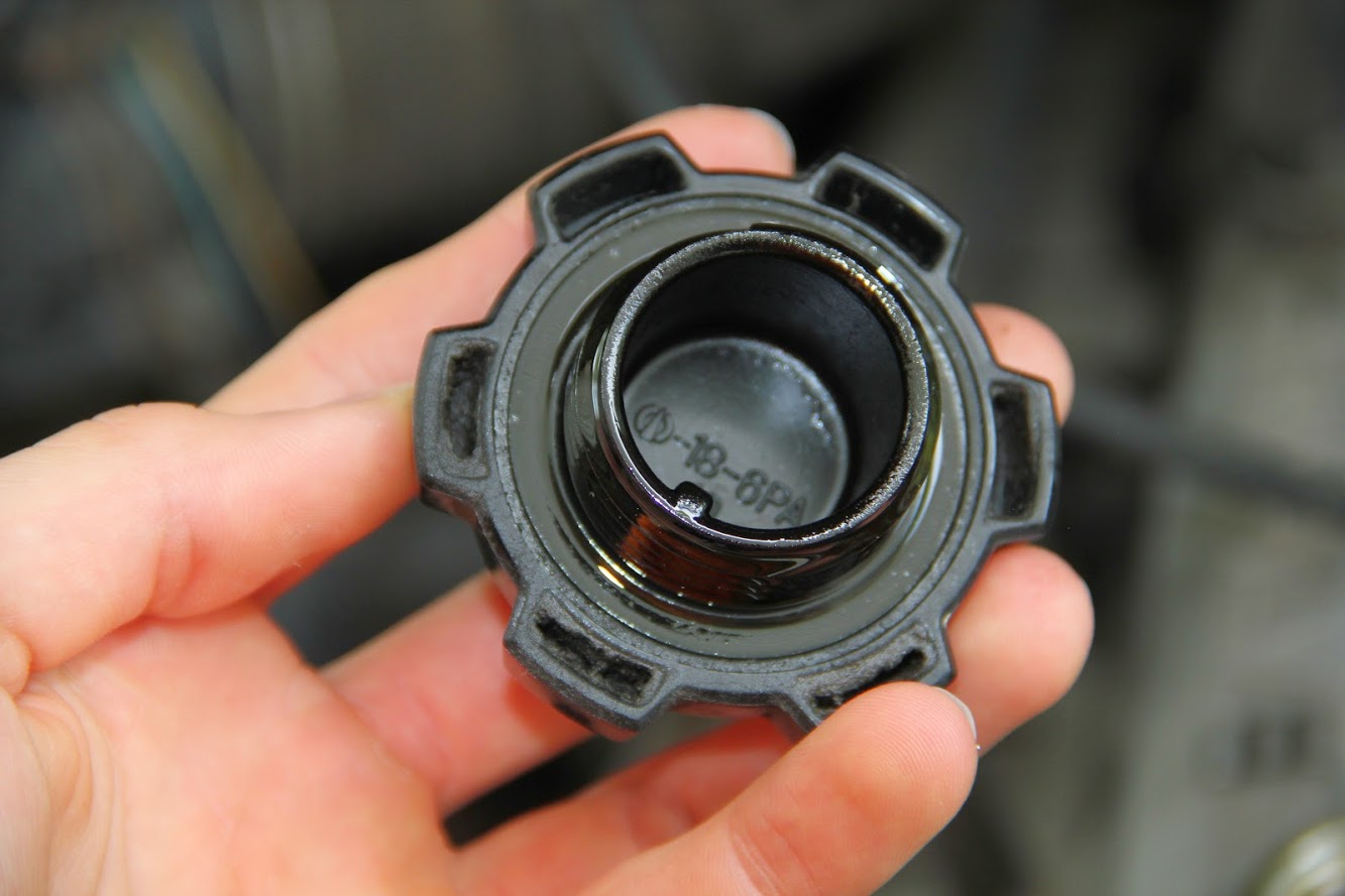

In answer to your question about the light brownish foamy stuff, I don't think I have any of that, but I did take a few pictures and I will post them so you guys can give a more expert answer. Hopefully that is a good sign!

Okay, here are the pictures as promised.
Oil Dipstick:
Oil Cap:
DNZCejvrc4l5TxA5ewj23BapvOGwvjt0KeWh2tgrgX8=w1334-h889-no
Valve Cover:
Obviously, I need to change my oil, but I think I will wait until this mess is sorted out...

  3. Okay, good to know. I posted some pictures. I don't think there is any milkshake, but I'll let you guys decide.
  4. Hmm. It's worse on start up. I don't know if that helps at all but if the engine is warmed up it's not as bad. I'm going to try the block tester again from a cold start while I look for leaks.
Certainly doesn't look like you've got any oil and coolant mixing from those pics. That's good news!
You don't have to have cross contamination to have a blown HG. My Civic had a blown gasket and never cross contaminated, it would however bubble up the overflow enough to push all of the coolant out over a short drive. I was constantly checking the dipstick and oil cap and never had signs of moisture.
I'd be looking for a leak. You can loose a lot of coolant without ever hitting the ground. From what you've shown, it doesn't look like a HG.
