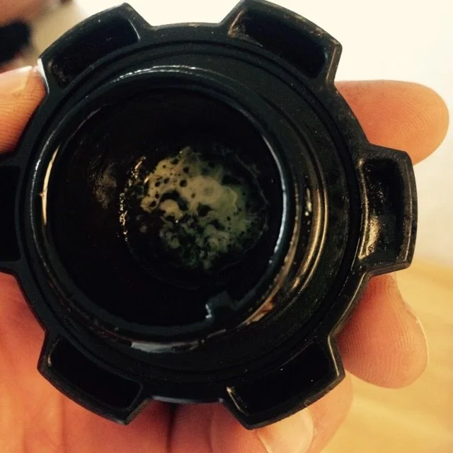

All of this was in preparation for a 500 mile trip home. Unfortunately, while the valve cover was off I notice foamy looking oil pooled below the cams (see picture)
So everything is leading me to believe my gasket is shot or worse the head. The only thing that makes me wonder is when we took the intake air hose apart it appeared that at some point there has been water in there. I admit that doesn't readily explain the foamy oil, I guess I'm hopeful it isn't the gasket.
So I'm going to do a blackstone analysis. I've already done compression tests and I cylinder 3 and 5 were low with 5 being in the 40-50 range.
Your thoughts?
