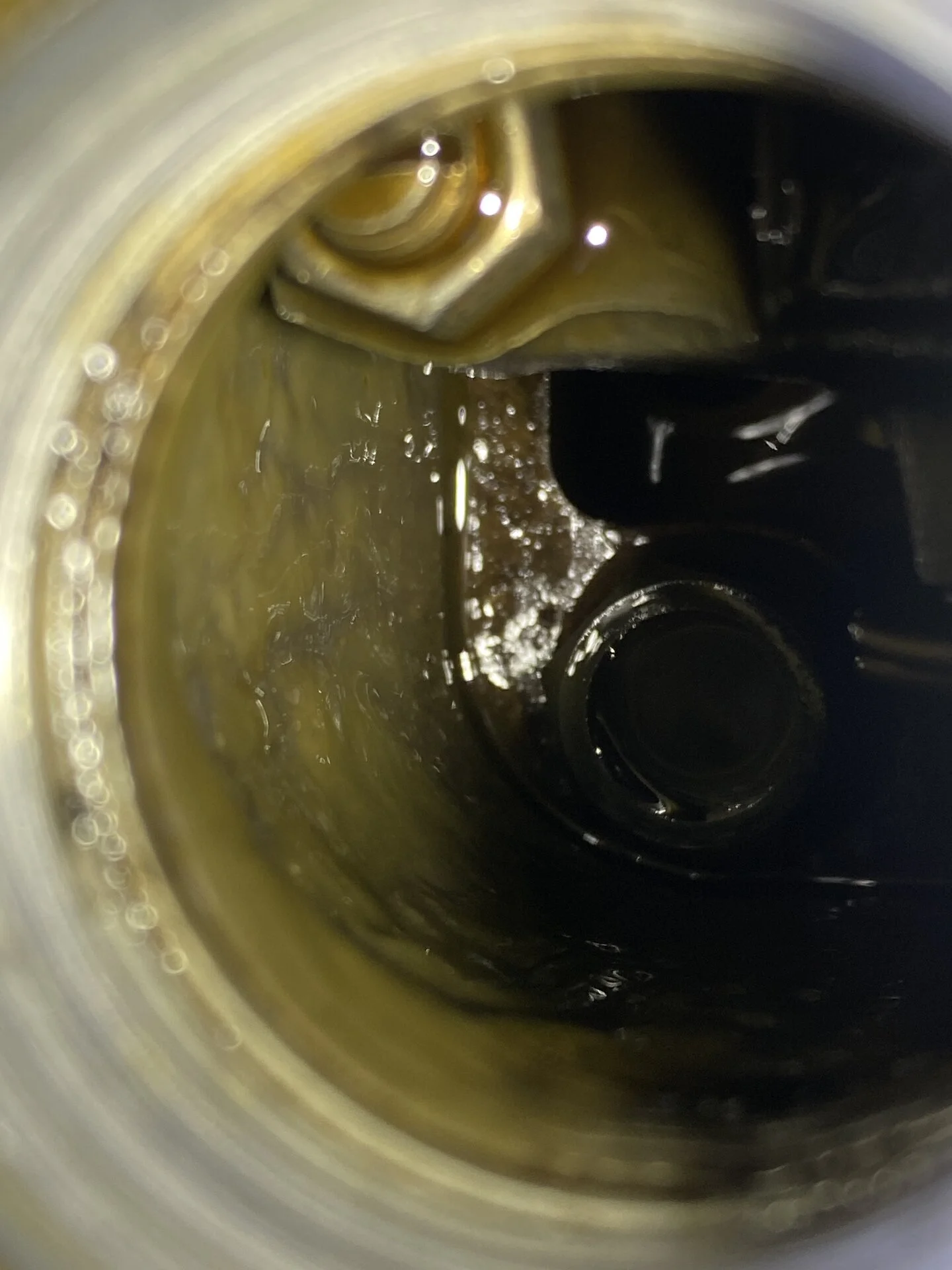

flush as much of the old coolant as possible, start with fresh coolant & oil and run it. Check often and see what's what. There's no telling what a previous owner had going on or any type of additives they may have used. It doesn't appear to me from those 2 photos it's a blown head gasket.

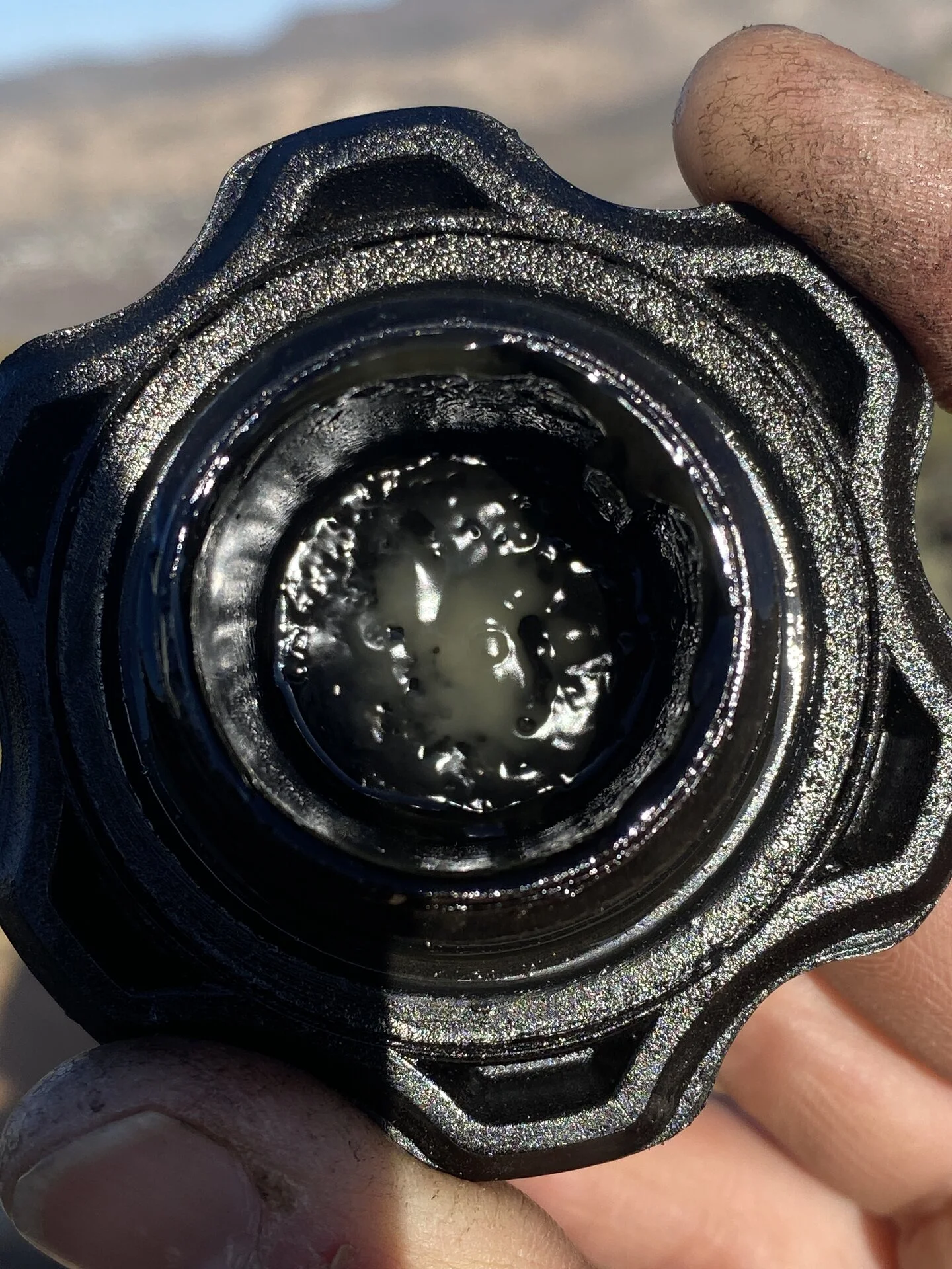

Take the valve cover off so you can look at the whole thing. It's much easier to do than the oil pan. You may just have an oil cap that isn't sealing and letting in moisture from the outside. Also you should be able to borrow or rent a cooling system pressure tester. This will help you find if your cooling system is leaking and if it is leaking out onto the ground. I would think a head gasket leaking between the combustion chamber and a cooling galley would over pressurizes the cooling system. A leak between a cooling galley and an oil galley would not necessarily show up in a compression test.

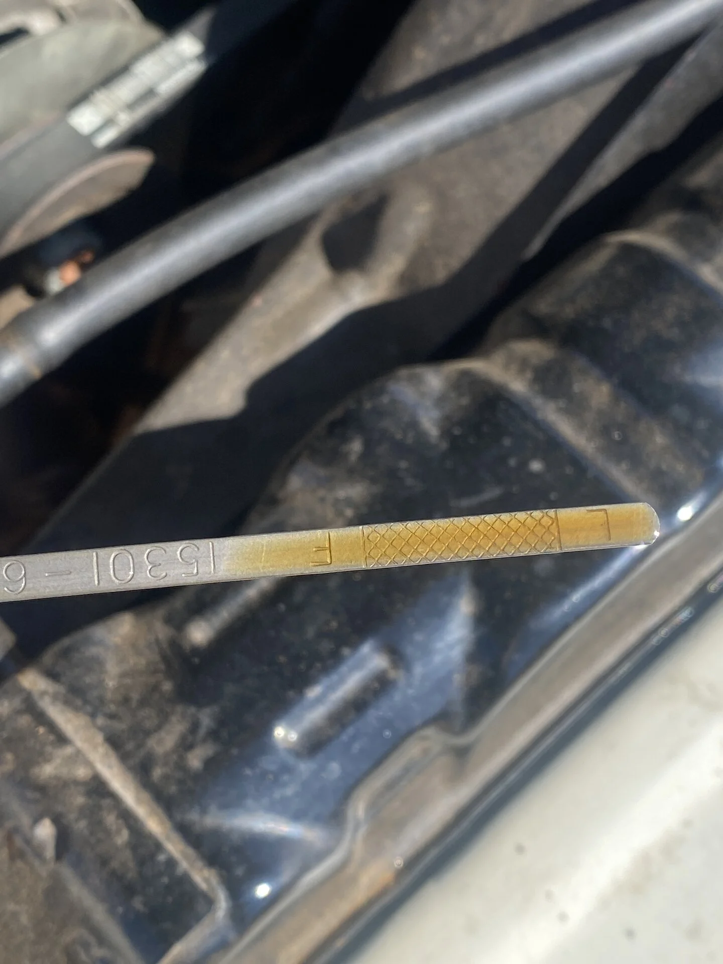

Oil looks clean but maybe a little high, is it normal for a cold 2F to show too much oil on the dip stick? I guess if almost a gallon of coolant disappeared into the oil the level should be a lot higher than that. The most damning thing here is the inside of my valve cover. I just replaced the gasket and cleaned out the inside of that cover a few weeks ago and there was nothing but oil in there when I opened it up. The fact that it’s covered in slime now that the truck is running coolant is pretty disconcerting.

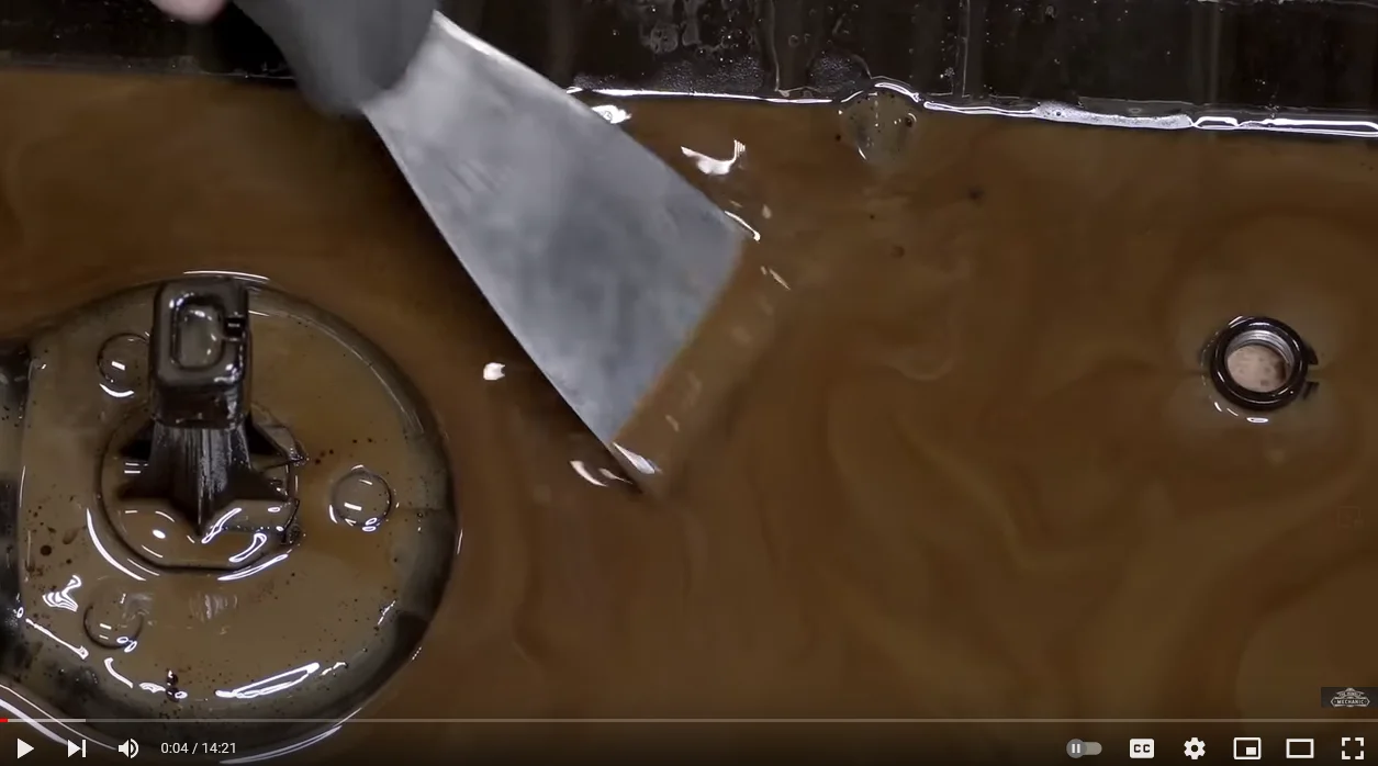

I you had a gallon of water/coolant all in your engine's oil, it would look something like this, probably worse. The 2F takes about 7 quarts of oil. That is 1 3/4 gallon. If you added another gallon of water/coolant it would show much more than one quart high.
I took the screen shot from this youtube video. Don't wish for water in your oil. It makes a mess.

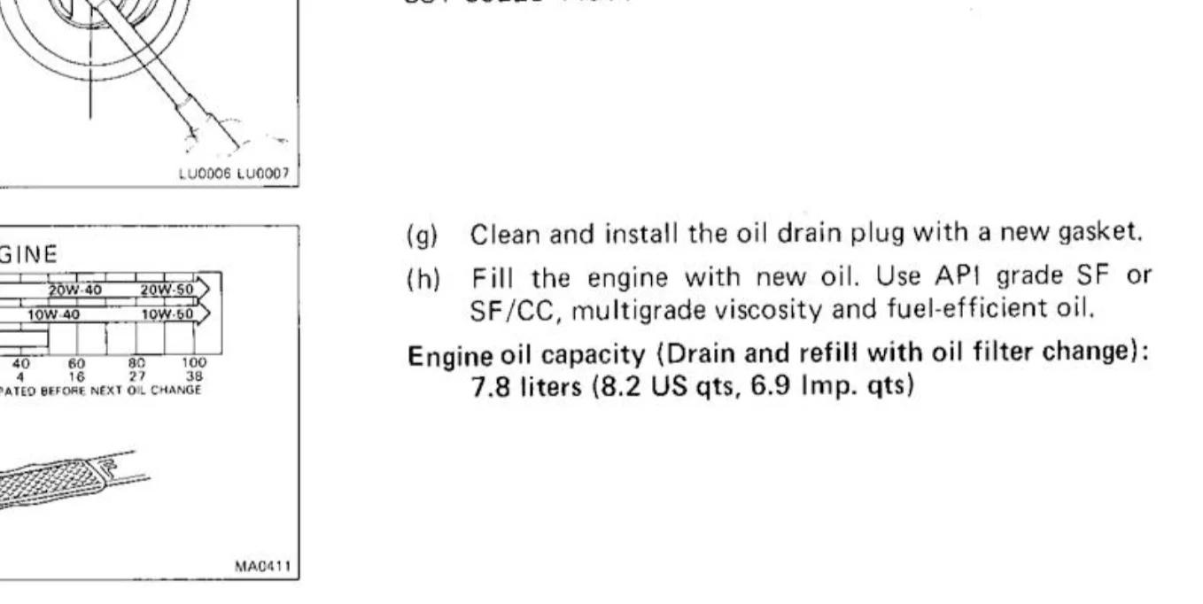

I put in 8.2 quarts in when I did the oil change. I believe that’s what the manual states when you’re changing the filter which I assume everyone here does on every oil change. Is 8.2 quarts wrong? If so it would explain the oil level on my dipstick.
As I recall it's 7.8 Quarts.
Looks like @2mbb is describing the oil capacity in imperial quarts and @BGarcia88FJ62 is describing the capacity in liters. I can see how this can get confusing. I'm in the US so 8.2 quarts was the correct amount for me.
Sorry. I got too many cars and can't keep them all straight. Even so, if approximately 1/3 to 1/4 your capacity is water/coolant there is no way your dipstick would look like that. That's my point.

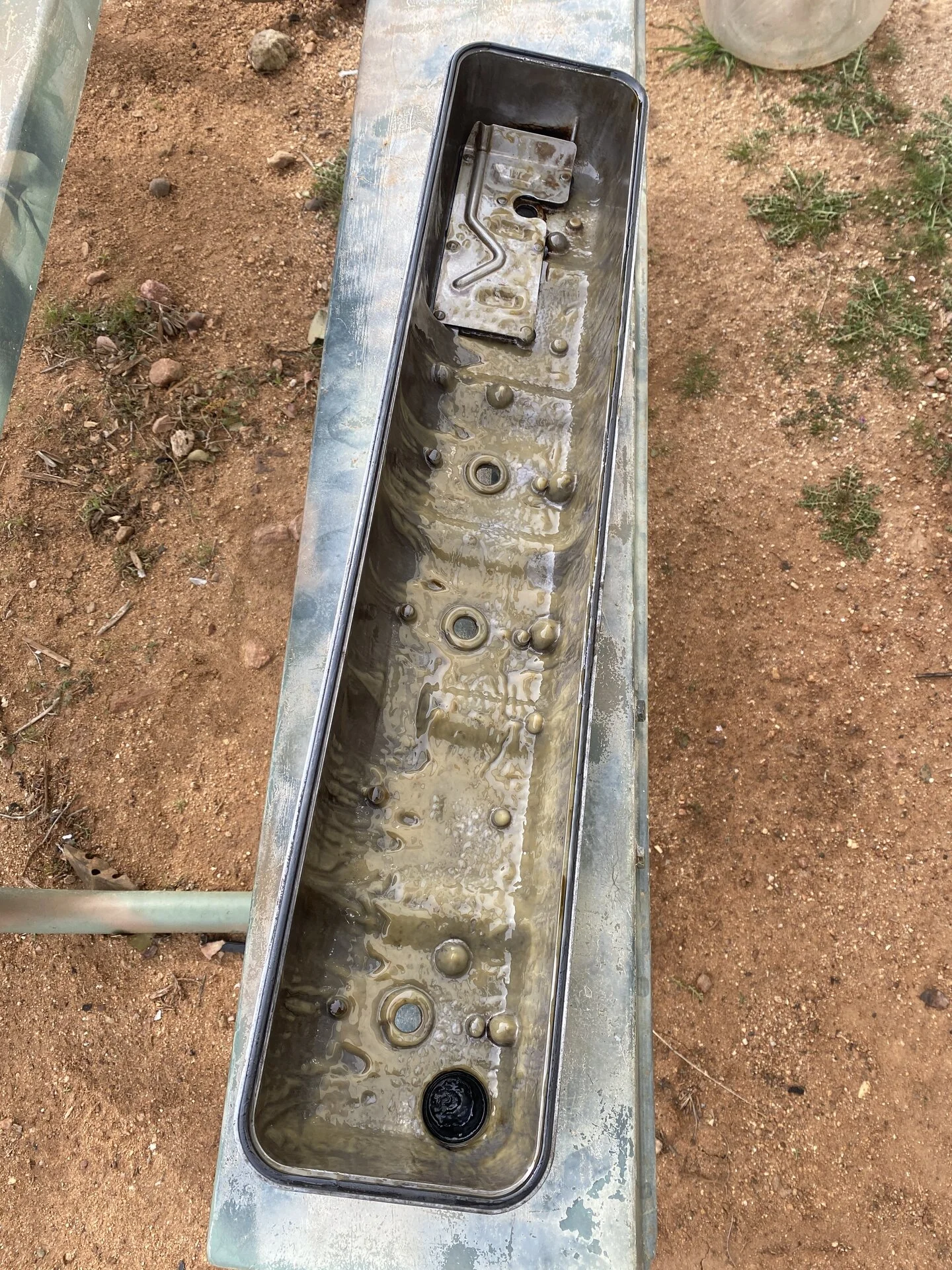

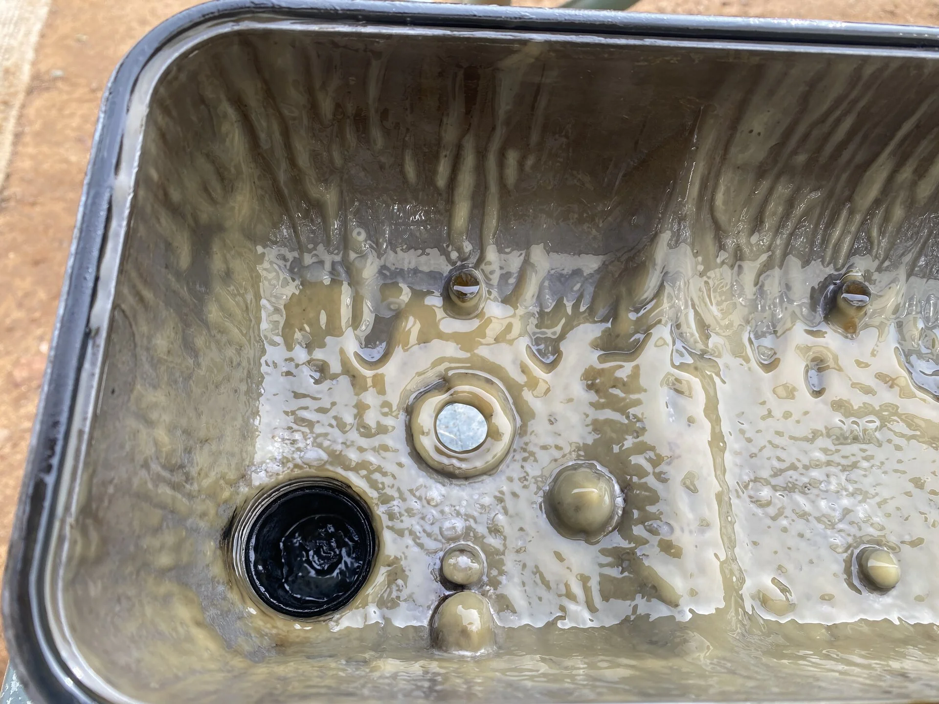

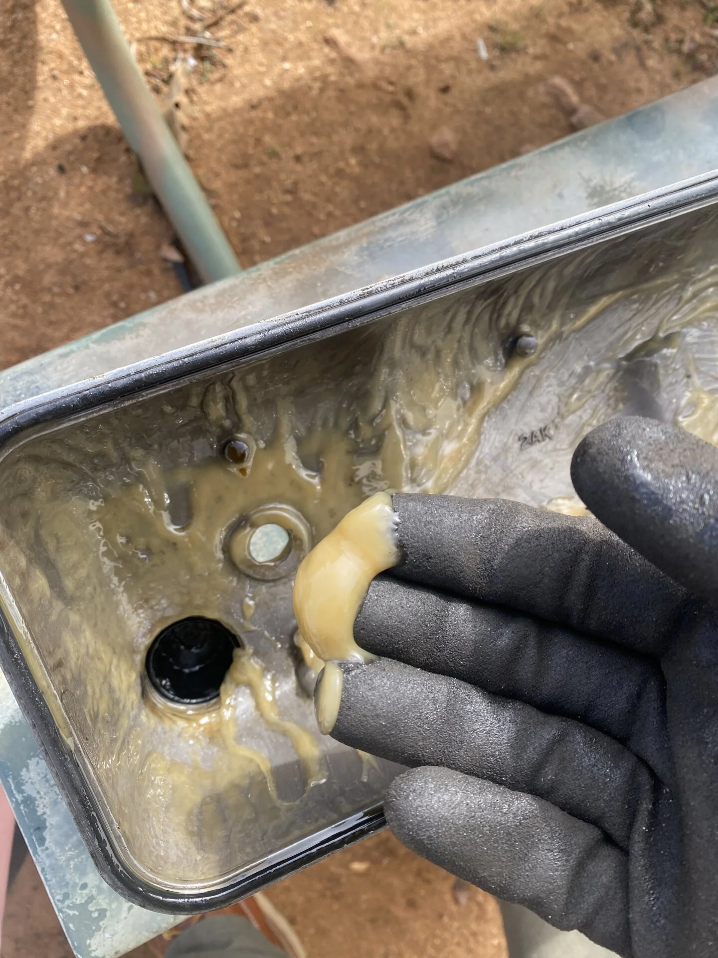

The mess under the valve cover. Drained some coolant and couldn’t detect any oil but i imagine all this snot under the valve cover must be coolant right? I haven’t drained the oil yet but that might be my next step
Seems odd to me that all that goop isn't all over the valve train as well. And the oil on top of the head bolts looks pretty clean.
This has me leaning toward some sort of additive may have been used in the past and it may just be residue of some kind.
I'd still drop the oil pan and inspect the bottom end. Wipe everything down clean it up. I'd run it, keep an eye on your temps and
look inside the valve cover daily to see if this builds up again.

Have you run it a bit but just short times? If you start it frequently but don’t drive it/get it up to sustained operating temps, any moisture that’s in the air within the engine can’t cook out and can cause this. Really cold and humid air temps can have similar results even if running longer times. Being that it seems mostly on the valve cover (not all over the valves) this may be that simple? Condensation on the cover then oil droplets flung up there from valve action?
Have a properly functioning PCV?
Hard for me to imagine it’s remnants of an additive doing this. When I opened the valve cover before it was just old oil in there. I changed the oil and flushed the coolant system with several rounds of distilled water (previous owner was just running distilled water) before I added coolant. The first 2 hour voyage since then I discover the coolant being low and the underside of the valve cover looking like this for the first time. Previous owner replaced a lot of the coolant system (new radiator and hoses, new fan clutch, thermostat) there was a 180* thermostat when I got it and I switched it to a 190* and put new gaskets on the thermostat and the housing.
I agree it’s weird how focused the goop is to the valve cover and not really anywhere else. This is way too much goop to just be condensation getting under the valve cover I’d imagine? I didn’t replace the valve cover bolt seals when I replaced the valve cover gasket. The weather has been pretty wild out here too, snow, rain, hot days cold nights (high desert).

In my experience that stuff doesn't resemble and oil/coolant mixture.

I drained some oil from the pan and it looks normal to me. I cleaned off the goop under the valve cover and put it back on. I’m going to run it and do the combustion leak test again. If it tests good again maybe I’ll drive it around today and check the valve cover afterwards.
