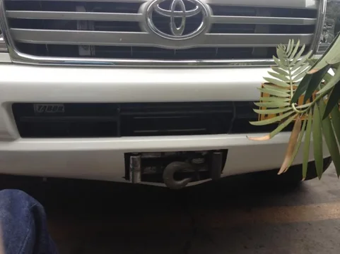

With new big intercooler I have finally remounted my winch, and when putting the bumper back on The front, I have had to cut a new winch hole
Anyone else doing this, there are markings inside the plastic bumper that help to line it all up, but measure twice and cut once. I went 10cm vertical instead of 10cm at an angle and the end result was the top lined up nice but an extra 2cm at the bottom, it is still a little tight but I am thinking to cut extra 2cm on the sides and put a liner on the bumper to make it look OEM

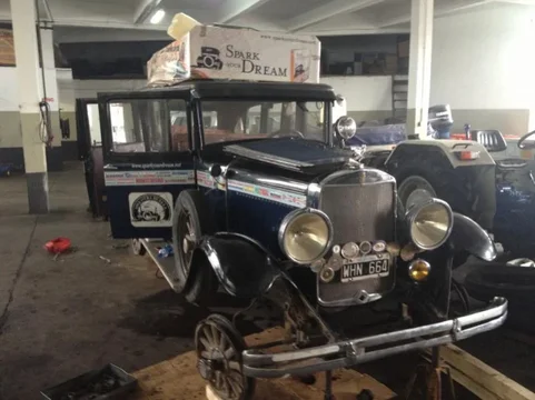

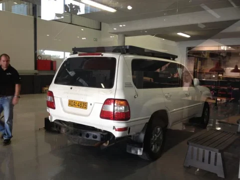

That's inside Front Runner Kyalami, I Went with an advised 1950mm long rack, 1345mm wide, width is good, length... The advise sounded right at the time but I would rather have full use of the roof window for the kids to climb in & out of the roof top tent... An idea I got from the Zapp family who have been driving around The world in a 1928 Graham Paige, and have had 4 kids on their journey. www.sparkyourdream.net if you want to see where the have been. Here is a shot of this incredible vehicle
He extended it between the 2 doors in 2004, to add a bench seat behind the drivers seats for the kids in the back. He has done over 250,000km in 13 years and stayed in over 2500 homes with people & families from all walks of life & religion
The mileage before the start if this incredible journey was unknown... But my cruiser has a great buddy to look upto whilest they stay with us :)

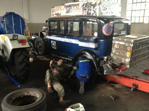

We are at Zimbabwe Spring Steel, where the guys have done an incredible job remaking the leaf springs to suit his longer GP and bigger family with The added weight. The skills of these men are incredible, and largely go unused now that this once great country is ironically very similar to Argentina in that its leaders change the rules for votes and decimate the jobs & economy...

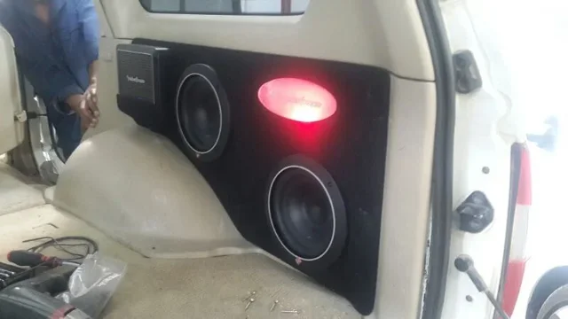

Pulled the trigger on a Rockford Forsgate speaker & amp setup... image-3146697792.webp Pricey, but the sound is incredible... Only affordable as I can swap for chicken... Clarity is good, replaced the tweeters with Prime R1 component speakers, and all 4 door speakers with Prime R1 full range speakers, put a RF amp for the door speakers under the drivers seat, looks like a Prime R600-4D, had to cut into my storage back right to mount 2 by 8" P1-SVC Punch subs, and I have another Prime R600-4D amp supplying what the subs need, all in all I am very happy with the outcome
Pricey, but the sound is incredible... Only affordable as I can swap for chicken... Clarity is good, replaced the tweeters, and all 4 door speakers, put a RF amp for the door speakers under the drivers seat, had to cut into my storage back right to mount 2 by 8" subs, and they have another amp supplying what they need, all in all I am very happy with the outcome

So with a little savings & Christmas on the way, Raul said he could do a RF sound upgrade on special for $1400 which was equivalent to what I had seen around town about 9 months ago. I said I wanted crystal clear sound quality, and not a rolling thunder cloud of bass that hurts my ears, but also the perfect bass. I also requested we fit 2 by 8 inch subs into the box on the left where the US amp & sub sit as I had remembered seeing something similar on mud...
Well what followed was quite tough to see and a few quick trips to the shop as plans changed from left to right hand side for the sub & cutting into the plastic panel :(
The door covers were removed & the OEM speakers were slaughtered to get the speaker mounts for the new door speakers, same thing with the tweeters and all I saw was the old destroyed ones... I was a little worried...
It took 3 days of solid work from Raul's team and what followed was a work of art, I really love the sound and I am enjoying listening perfect sound with all doors open on a Saturday with my Kids and we dance and have alot of fun for a couple hours whilst going through the playlist... :)
All in, speakers $1470 as I went for 2x8" vs 1 by 10" sub, and cables & fitting etc another 300 and I put in a reverse camera for $30, so very happy with it and it was well worth it for the fun I am now enjoying from it :)

Added a couple double jerry can holders to the front of the front runner rack, also moved it forward about 60mm, as much as I could, the plan is to use the double jerry can holders to create the strength needed so I can cut out a piece of the centre cross bar over the sun roof, which gives my kids access to the roof rack from inside the cruiser, and I don't have to worry if they need to go to the toilet at night with Hyena or lion walking around, as they gotta get past us and wake us up for that... Safer that way... Just gotta make a magnetic mosquito flap that's easy to use...

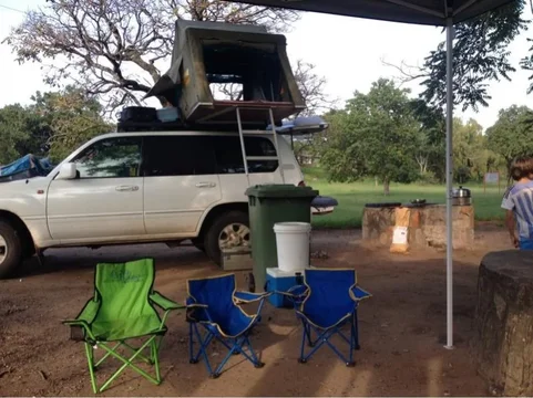

Mounted the rooftop tent. First to hang over the back, but the back door that opens up was hitting with the break light, so I re-drilled through the floor board and it now opens to the side :)
