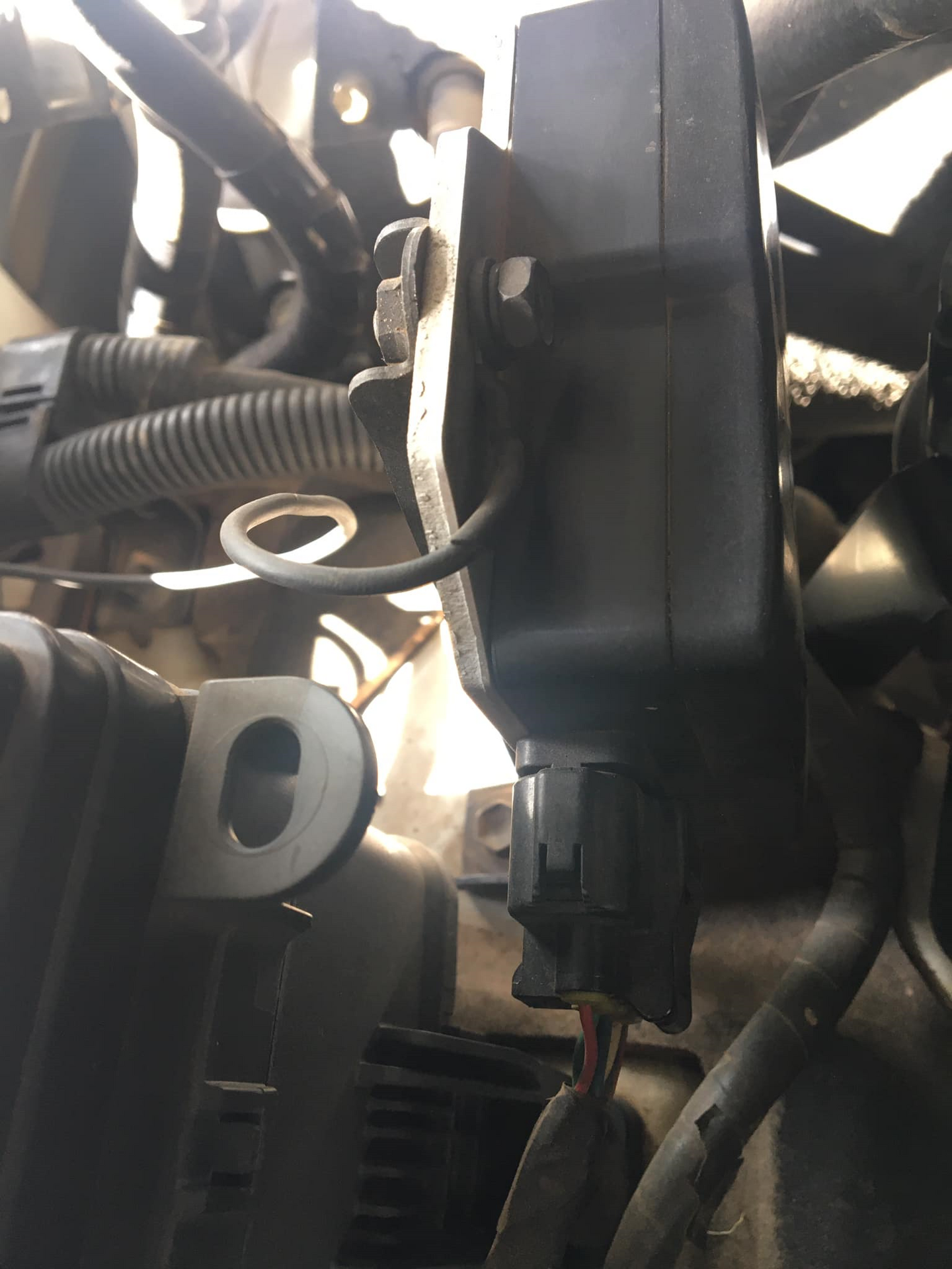

Try running a heavy wire to earth (ground) the Spill Valve Driver directly to the -ve terminal of the battery.
View attachment 3384738Okgood idea to reinforce the direct battery GND
