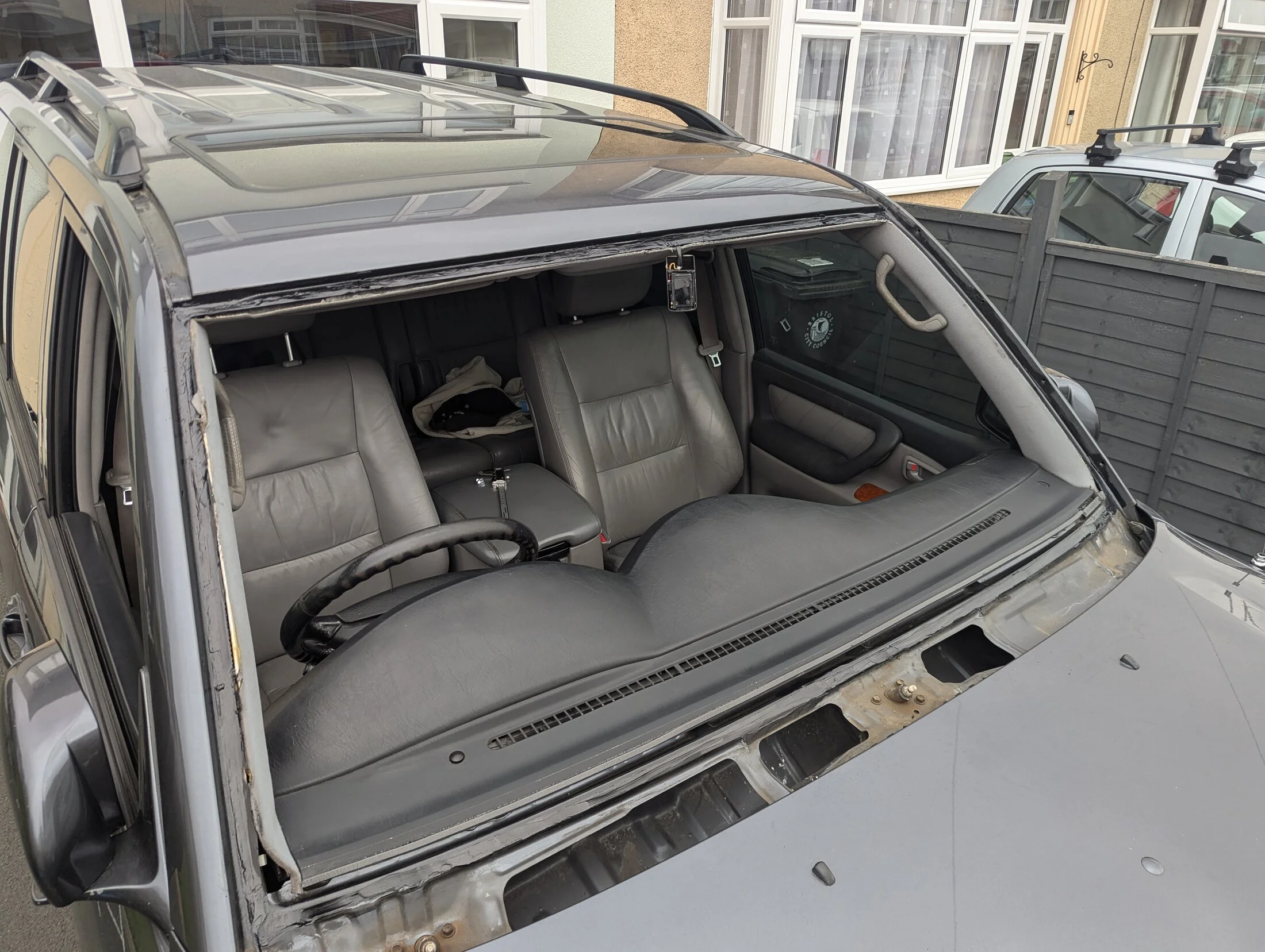

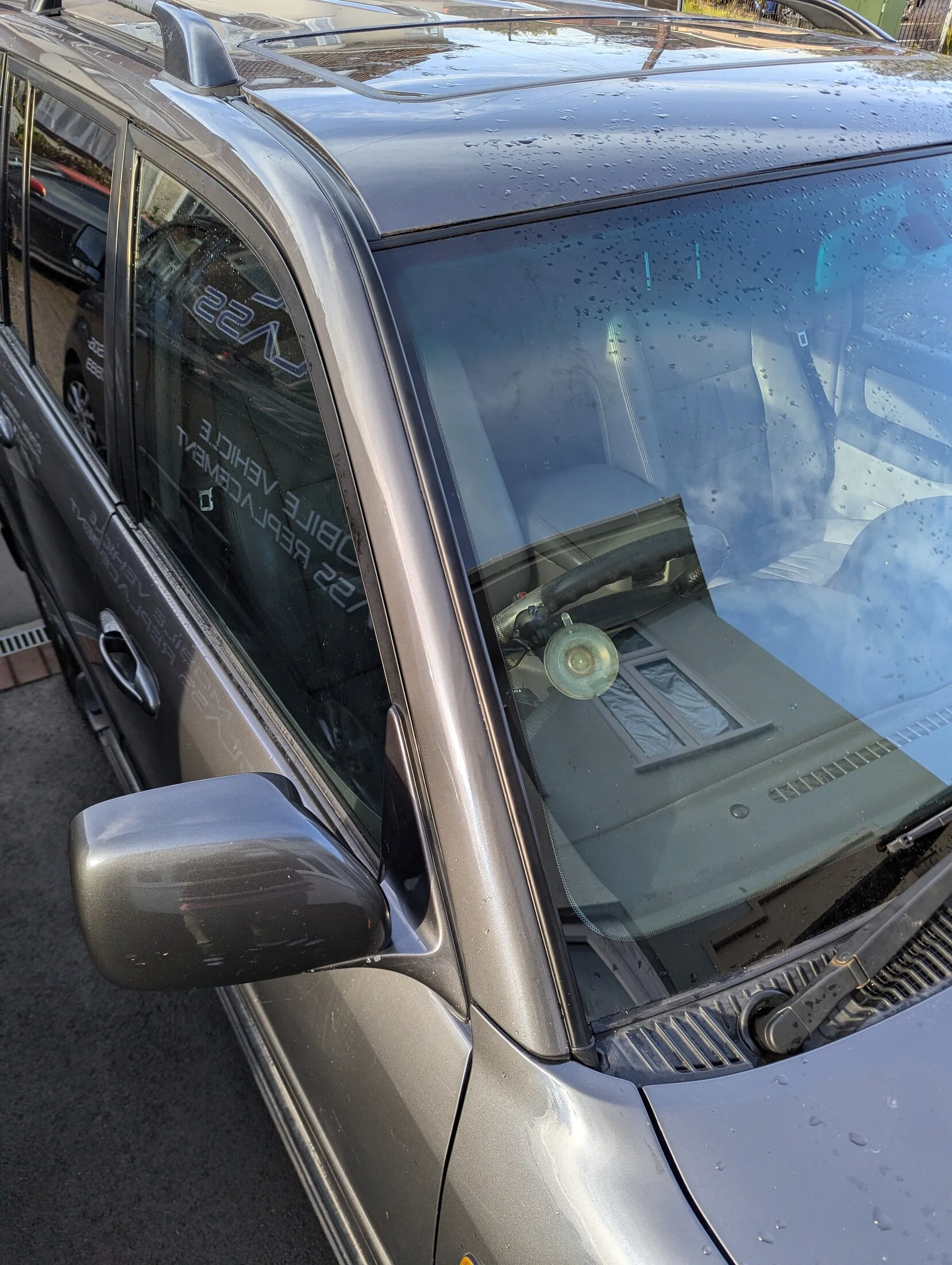

First things first - I needed to get this thing watertight!
I ordered all new windscreen mouldings, the various other dams, rubber sealing strips, rivets etc. When I ordered/order stuff for this car, it's always from either Partsouq or Dave Stedman @ Japan4x4, but more often than not the latter as I've had increasing issues with Partsouq not including items they have pictured etc.
Anyway - I ordered a windscreen replacement from a guy who told me he could fit it and rivet on the new mouldings etc. Fast forward to the day, he fitted the screen badly, decided he couldn't fit the mouldings or rivets and left after installing the screen.
A much more experienced fitter who is familiar with these then came to salvage the job a few weeks later, but sadly the windscreen had been installed too far out by the previous guy and after a week of the new mouldings being installed, the screen cracked where a rivet hole was.
The good news was that the car was now water tight, and the foot wells were no longer wet, but had a small crack - I decided to leave it as is for the moment and focus on the rest before blowing another £350-400 on a new screen.

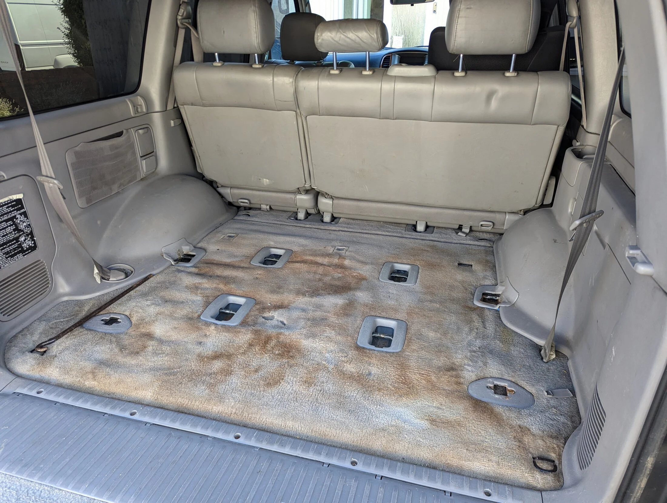

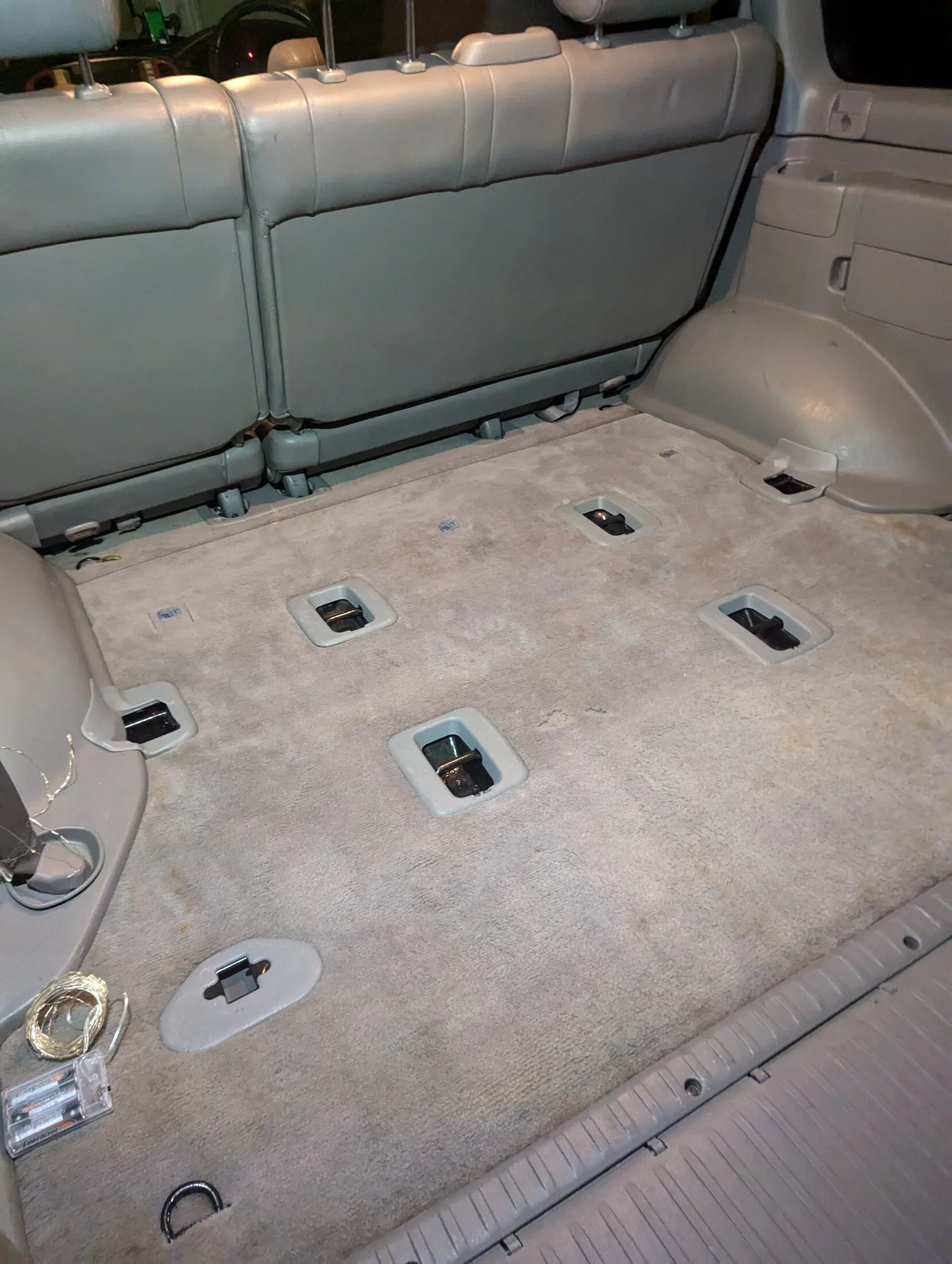

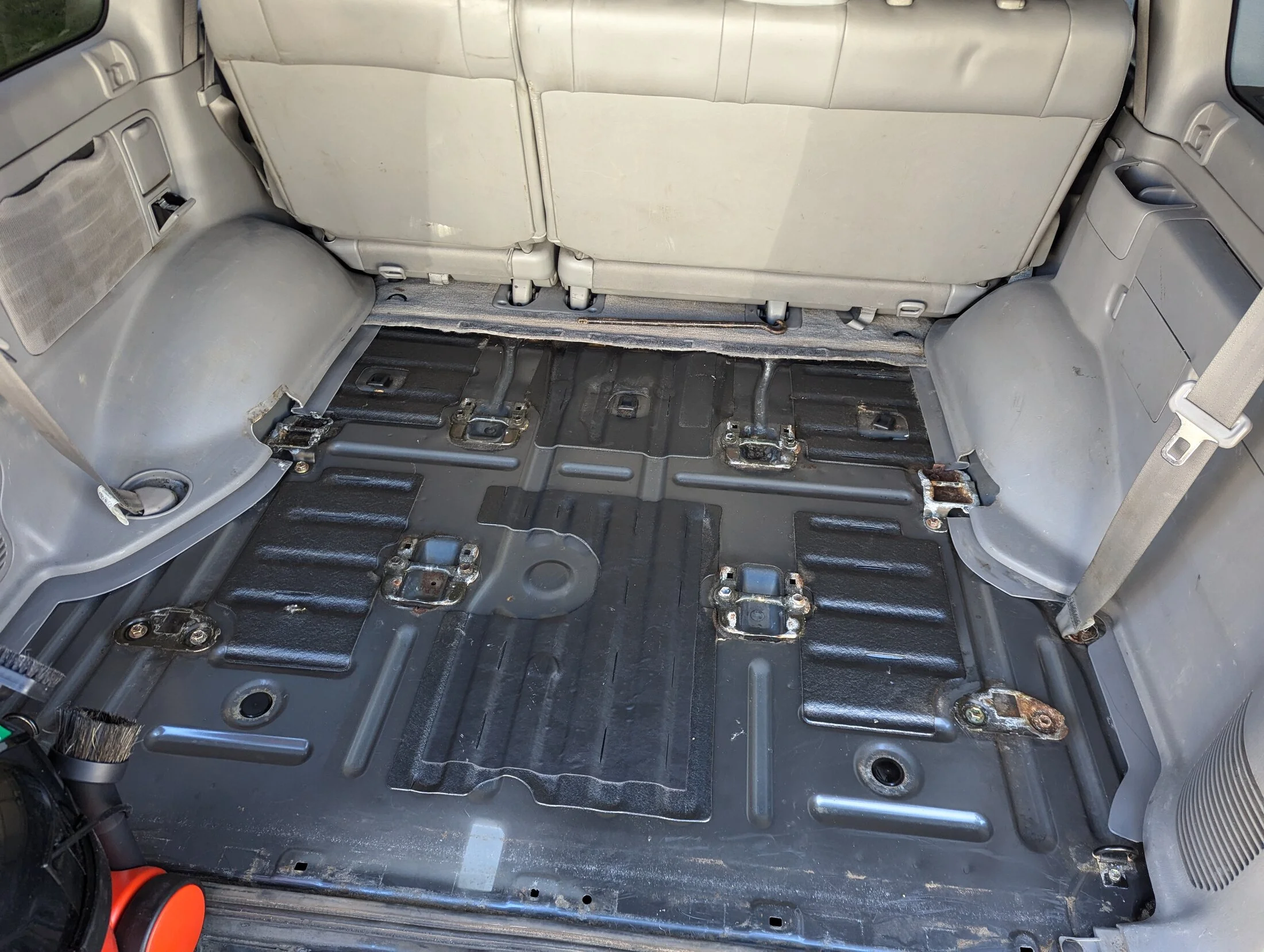

Following this, I turned my attention to the rear - the boot carpet under a protective mat was very wet and very stained.
I ordered more new seals - one for the upper tailgate and one for the whole boot opening and fitted those! I then saw various posts around the 3rd tail light and it's poor 'foam' seal along the top, and sure enough mine had a big gap and was perished!
I removed the 3rd brake light, and then added some butyl clay/paste stuff that people on here recommended and reinstalled. Annoyingly, the stud on one side snapped when tightening it up (the clay thickness wasn't an issue), but by this point it was already well seated, secure and the butyl stuff was quite happy, so I added a small amount of clear waterproof sealant around the 3rd brake light as a back up. Another job to revisit down the line but it was then fully water tight.
I removed the carpet and wet-vac'ed it, and cleaned up the various rust spots and painted the brakcets - again, I didn't realise at the time you could buy new brackets instead so I'll definitely replace those at some point next year.
Sorry for the bad quality late night picture, but you can see it was all much better!

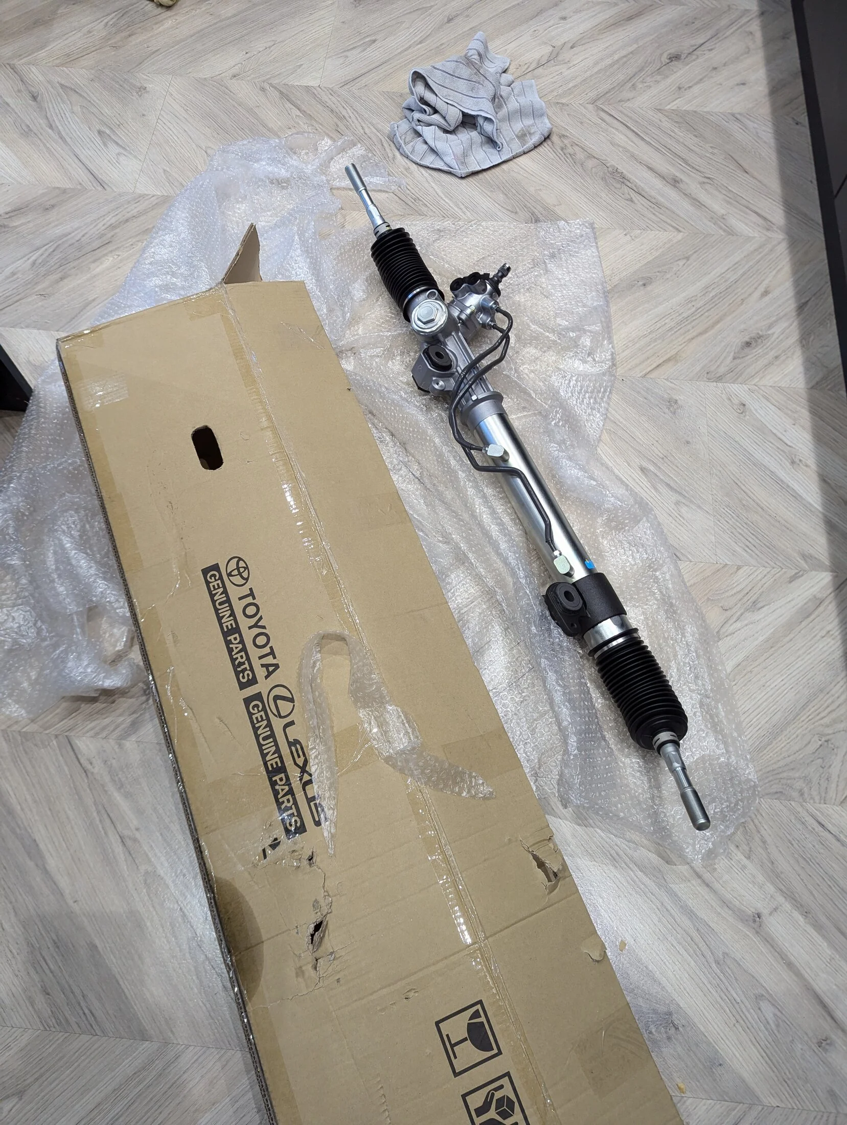

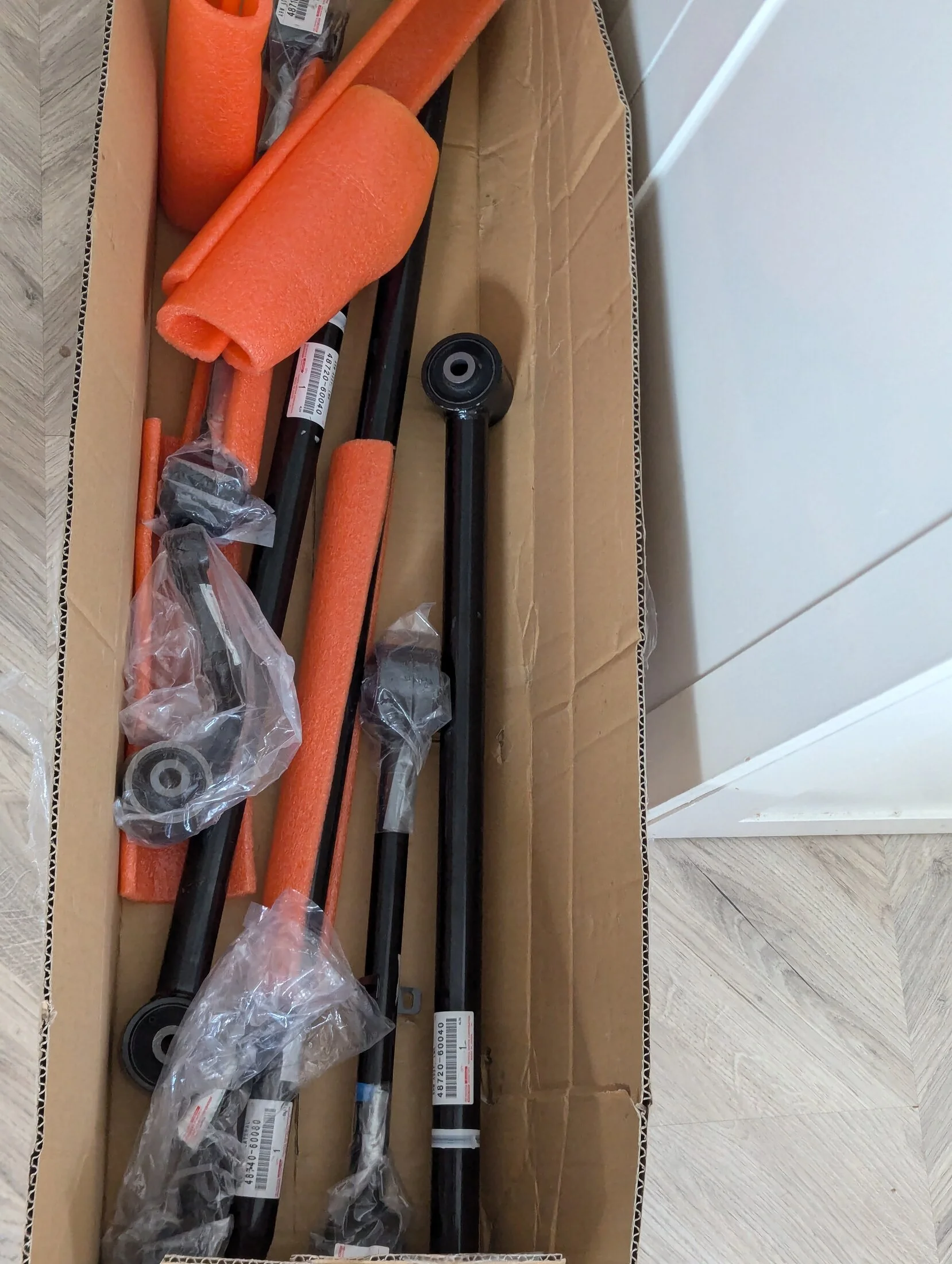

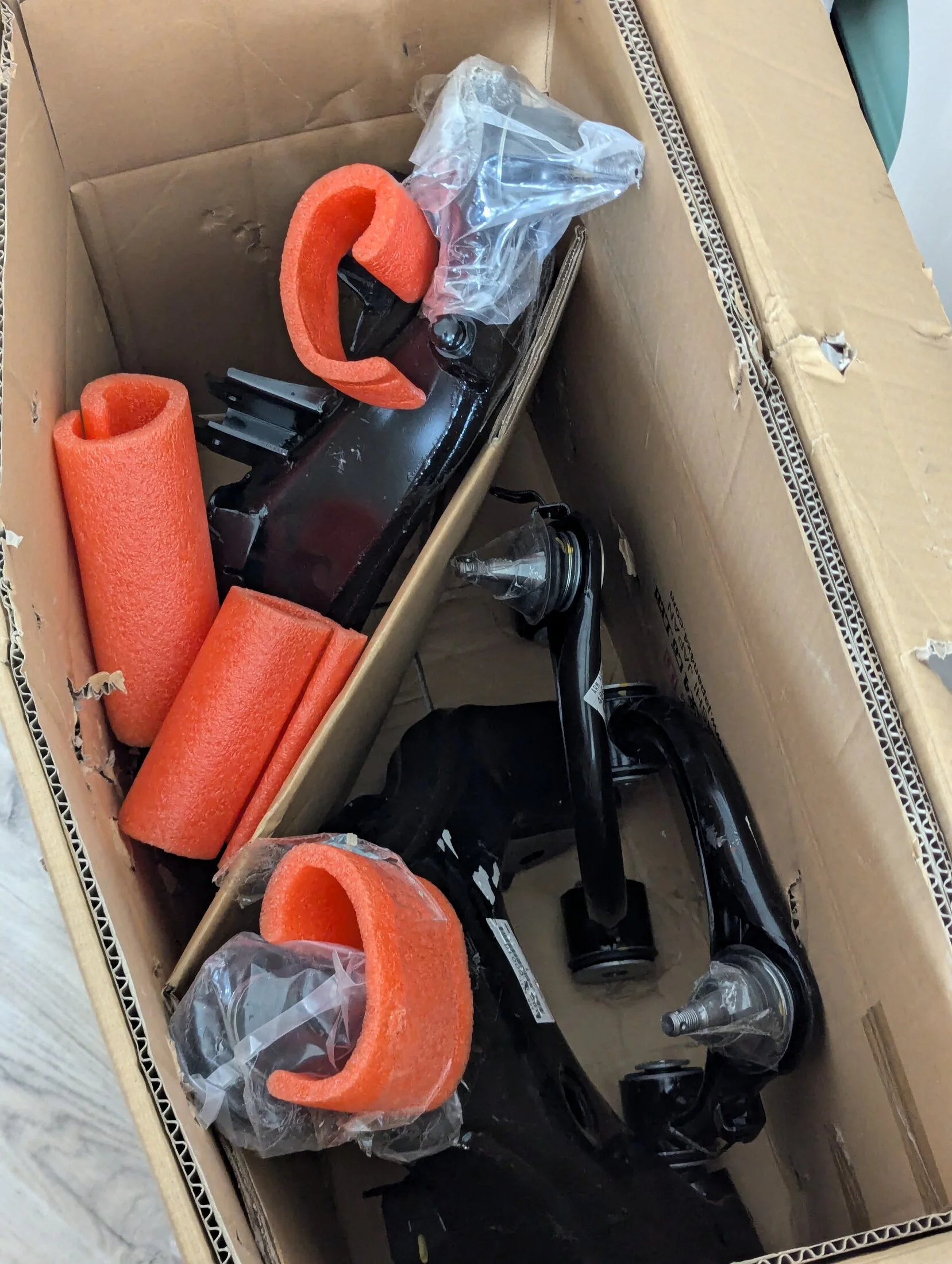

My wife was very supportive of it as she loves the car, so we went all in and ordered a shed load of stuff from Dave @ Japan4x4 in Japan consisting of:
- New Steering Rack & hoses
- Front & Rear UCA/LCA whole units & Panhard bar

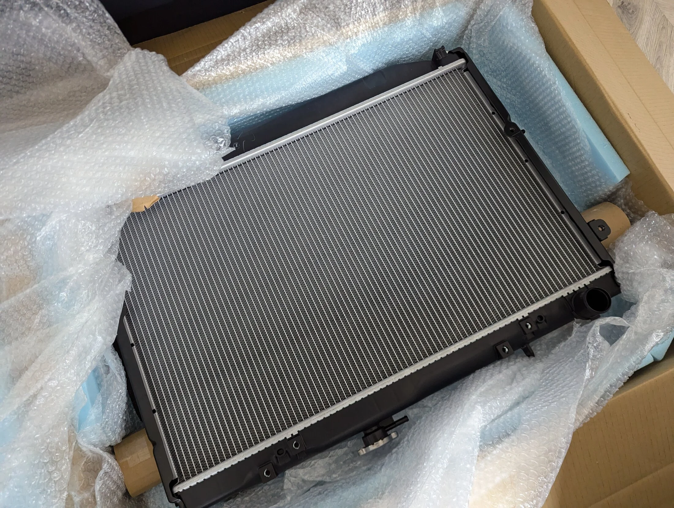

- New radiator and all hoses
- Front & Rear droplinks/bushes etc
- All new bolts/nuts for these
- Cambelt/Waterpump/Tensioner/Cam seal etc
The parts arrived, and I booked in some time with our LC guy to get this stuff sorted.
Before sending it down, I also ordered new front bearings, discs, pads etc and much more.
A few pics:

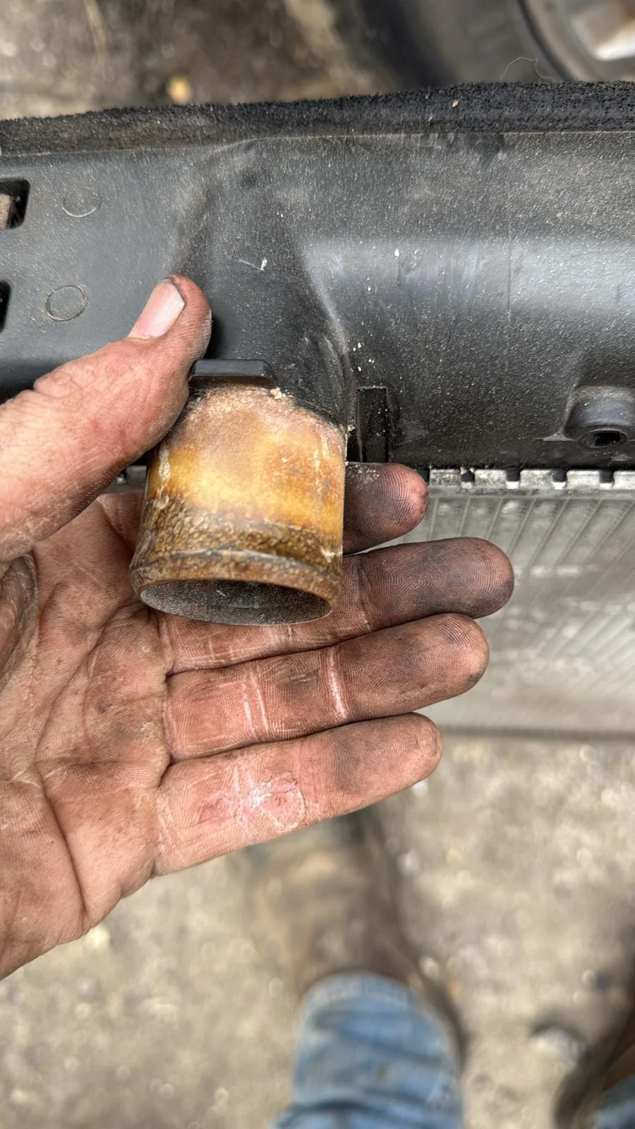

So the truck went off to my LC guy, and the first port of call was the engine bay work:
- Check valve clearances
- Replace injector seals
- Clean out intake manifold etc
- Replace waterpump/cambelt/tensioner etc
- Replace radiator, coolant hoses, T pieces, other hardware etc
- Change brakefluid

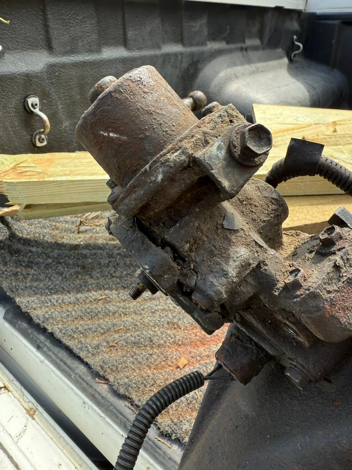

- Replace steering rack & fluid
The clearances were all good, bar one valve so that was good news! Injector nozzles are worn so those will be replaced in the next few months, but other injector seals were replaced in the meantime. The manifold was surprisingly clean too!

- UCA/LCA entire assemblies

- UCA/LCA/Panhard Rod entire assembles

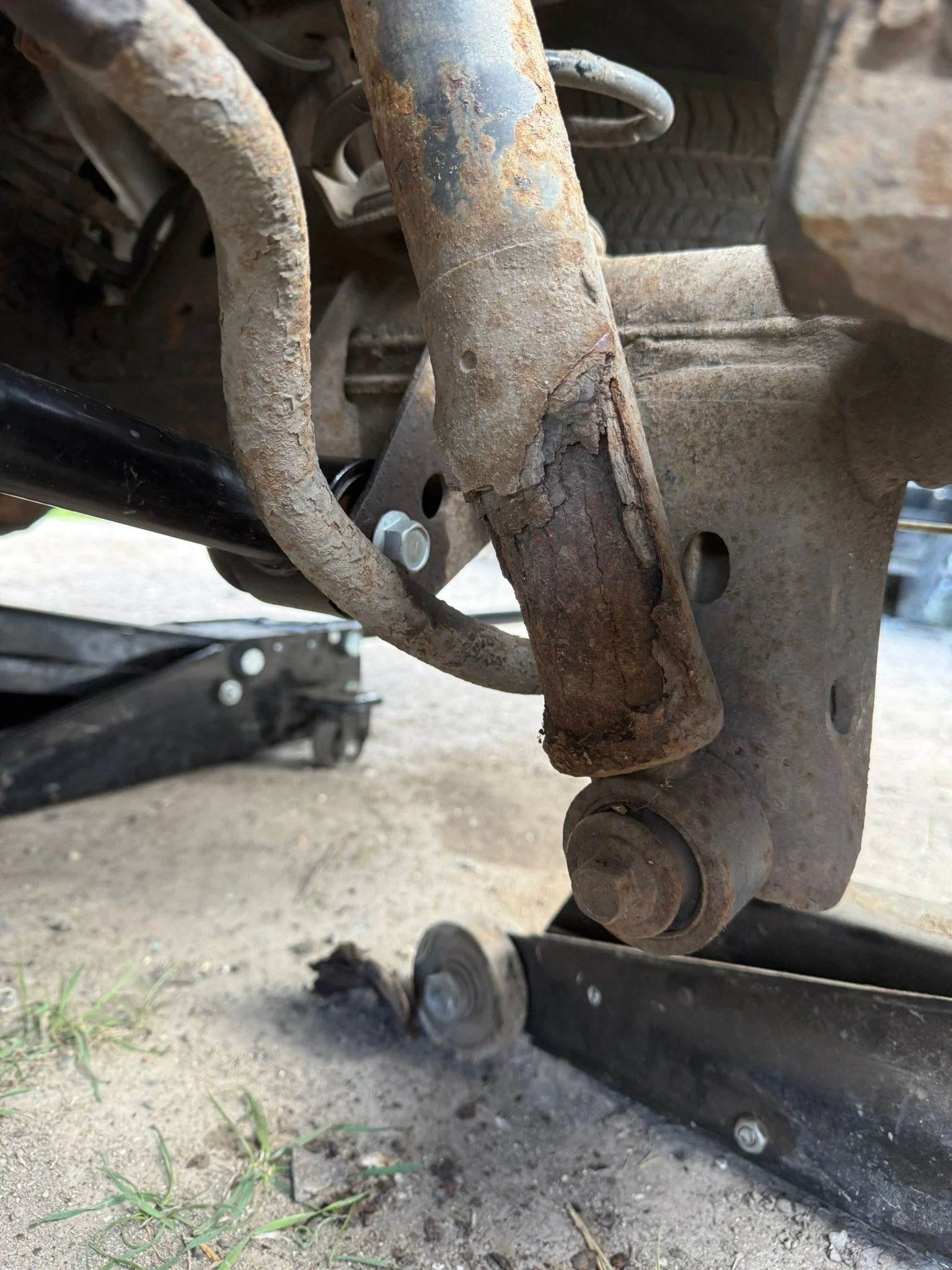

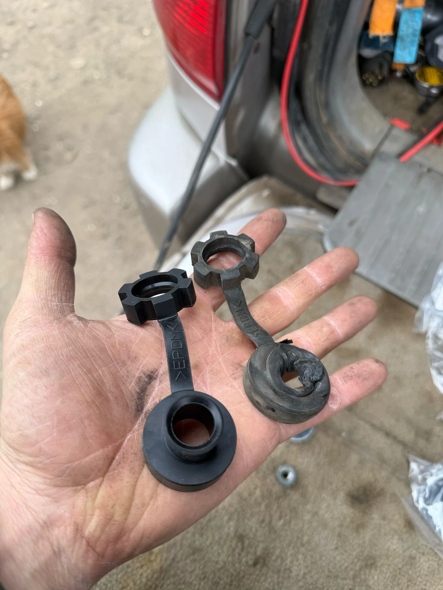

And then moved onto the rear shock bushes, but working on something equivalent to a 'rust belt' car means the rear floor access holes needed cutting to allow access to remove the rear shocks.
On closer inspection, it became clear that the outer casing of the rear shocks was just rust, so to avoid issues with the annual inspection (MOT) and to address this, I opted again to replace them both - with OEM, along with all new bushes and hardware.

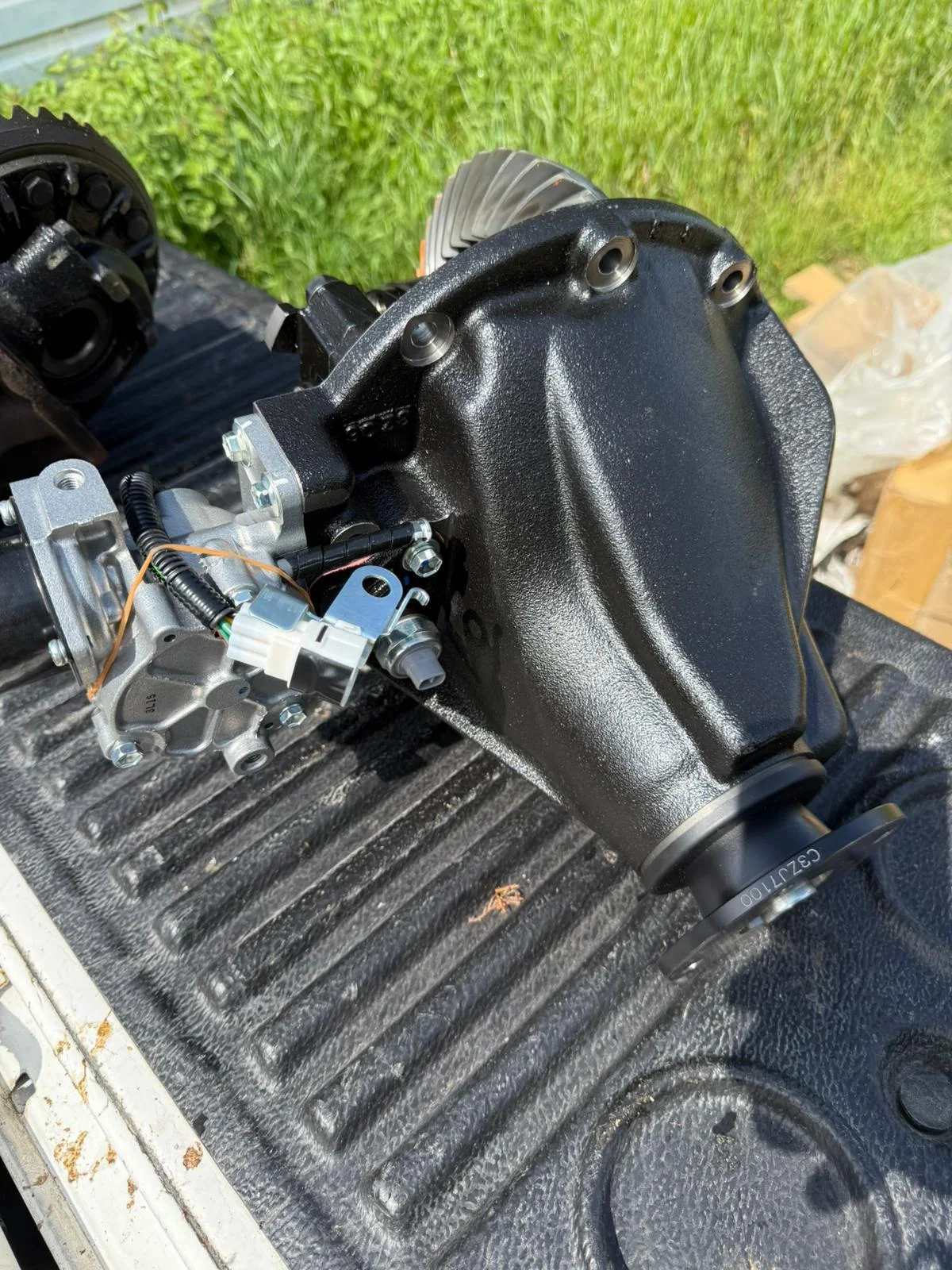

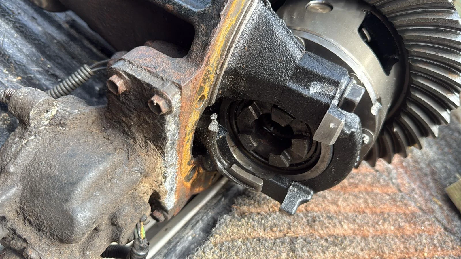

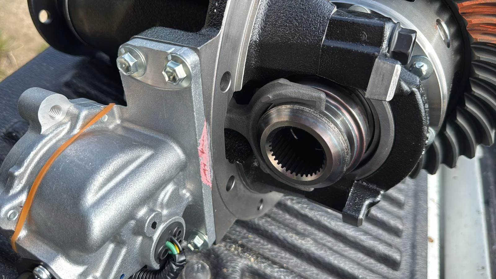

Another thing to address was the rear diff - the rear diff pinion seal was leaking every time it was replaced. The casing which it sealed against was pitted from rust, it was clear that the diff oil had not been replaced for some time and was heavily contaminated by water (likely from the blocked breather pipe before it got replaced), so the diff oil and pinion seal got replaced again.
Sadly, disaster struck!
Driving on the motorway, listening to music, enjoying the new drive and I could suddenly here a noise that was getting louder and louder - it was coming from the rear.
The rear locker actuator was not functional but for whatever reason had engaged the diff and broken the fork inside, the diff was very unhappy. It was also likely the pinion bearing was shot, so I got it recovered home.
I had to make some more tough decisions:
- Buy a used diff for around £500 with no history, warranty or confidence in what I was buying
- Buy a new 3rd member casing and get the old diff rebuilt for around £1000
- Buy a new entire diff and actuator for around £1200 shipped from Dave @ Japan4x4
Even though the costs were incredibly difficult to swallow after all the other work, I opted for the final option and ordered a whole new diff and actuator from Japan4x4.
Old:
New:
The diff got fitted, but despite everything being cross-referenced, the connectors were different on the harness vs locking actuator, so we had no way of unlocking the rear diff.
Some quick thinking from Dave @ Japan4x4 meant that we could essentially use a 12v feed to activate/deactivate the locker, meaning the car was once again driveable. The intention is to get this connector sorted out properly in the coming month or so once I've moved house, so I can use the rear locker properly for the first time in my ownership!

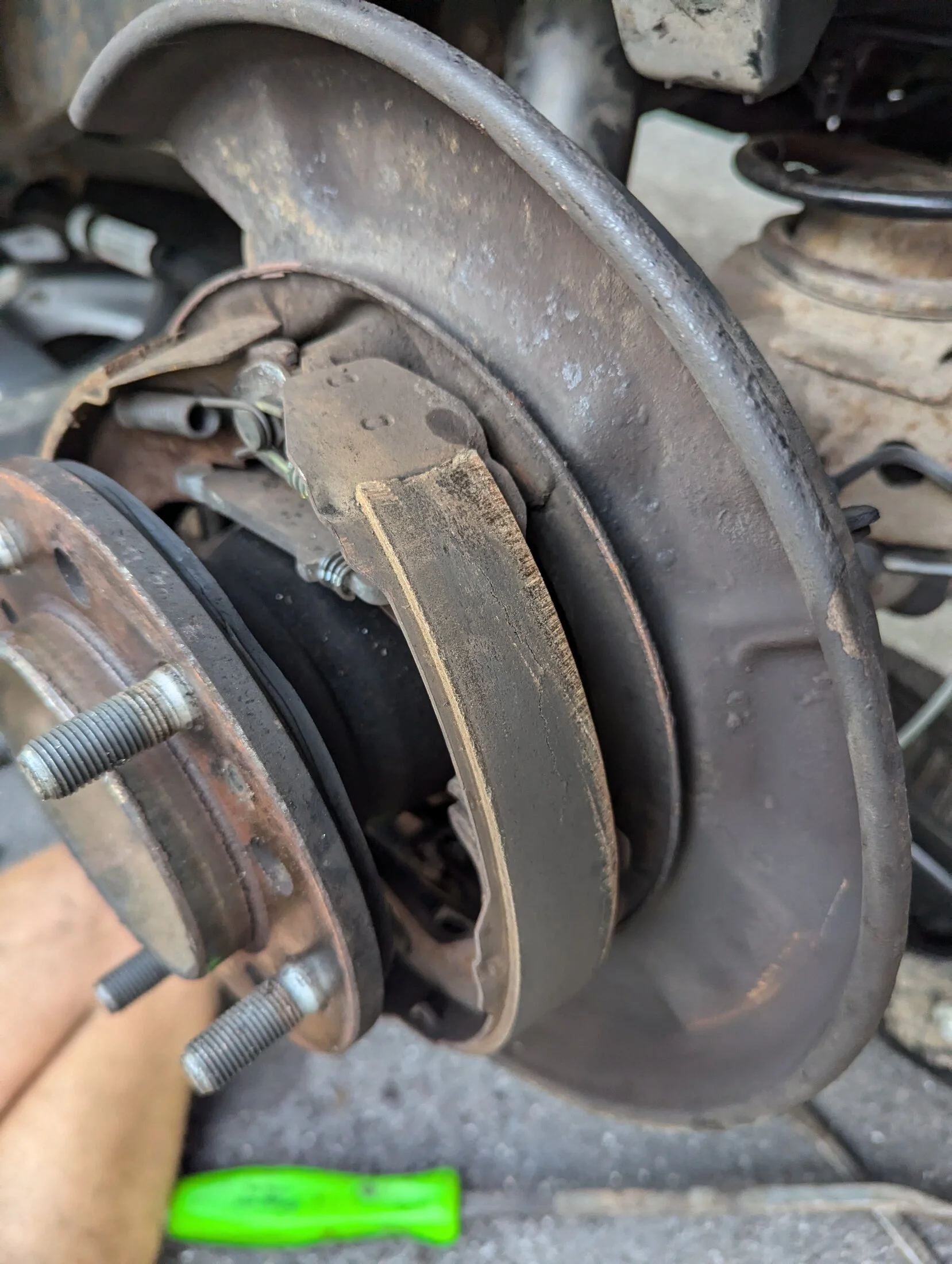

This week, the vehicle went in for it's annual inspection, but just prior to this had it's windscreen replaced again to address the crack which previously formed (as explained in the earlier post).

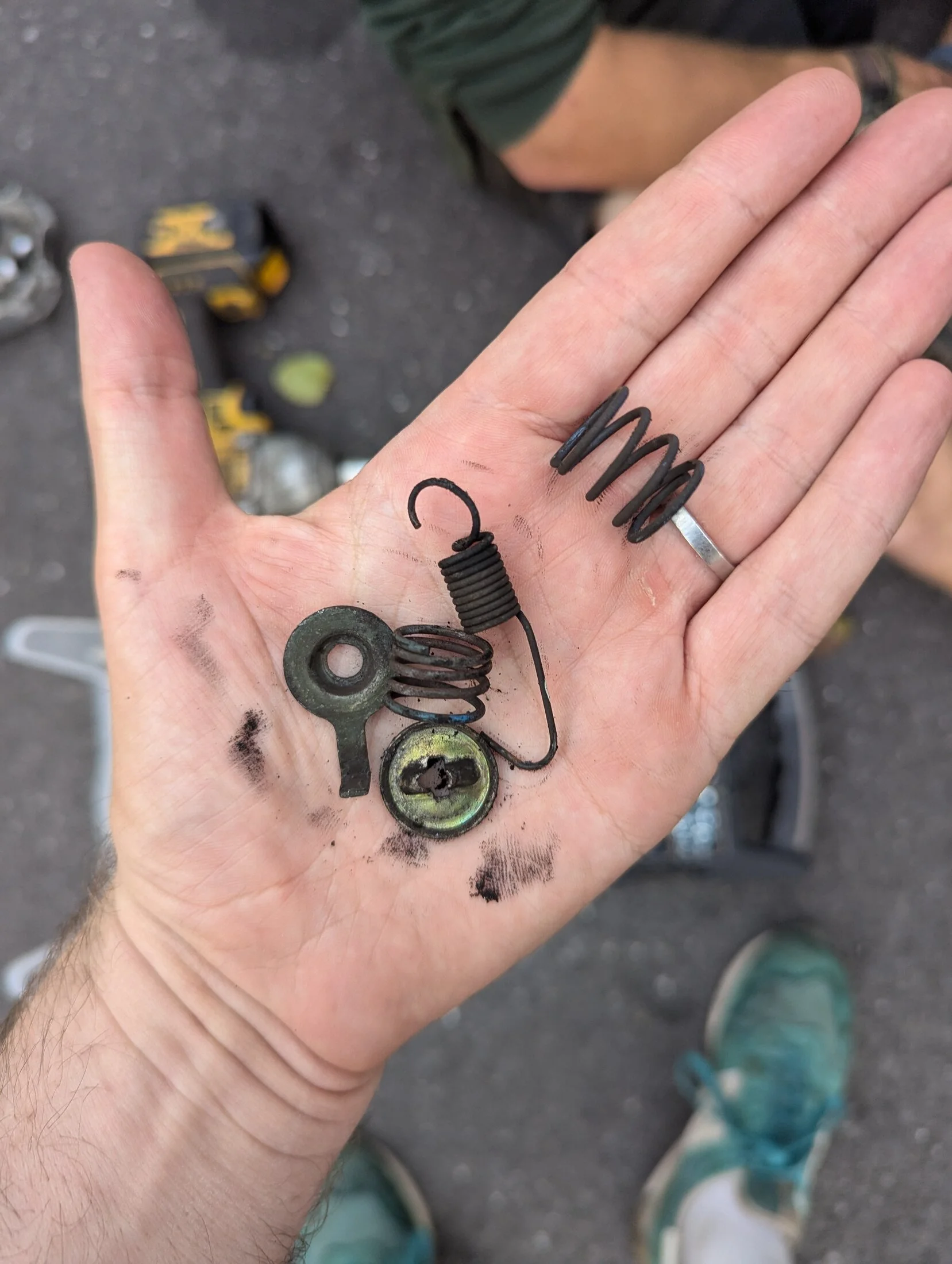

It was doing great until they were testing the brakes individually and a brake line straight from the master cylinder burst! They MOT garage also noted that the NS rear handbrake shoe needed adjustment.
The cars MOT ran out the following day, so I couldn't take it to another garage easily, so I did what I had to do and moved the car without brakes about 50 metres down the road in the industrial estate to another garage, they replaced the brake line, bled the brakes and then adjusted the NS rear hand brake.
It passed it's MOT, and then I got the car back - however my LC guy suggested I check they've not overtensioned the hand brake shoes as it's quite common and will cook the rear bearings. Well, they garage had done exactly that and the car was noticeably reserved and the rear wheel and drum got very hot, very quickly.
My guy drove 2 hours to help us out of this bind, and it materialised this s***show of a garage who had adjusted the shoes had reassembled and adjusted it all wrong. The rear drum/disc took well over an hour to remove, even with the help of bolts in the face of the drum to help push it out and alot of prying. It became clear very quickly that the shoes had got incredibly hot, cracked, and expanded even tighter against the inside of the drum.
You can't see in these pictures, but the metal work inside had heat-treated itself, I was very lucky it hadn't caused an accident really
Rule #1 - don't trust random garages who don't have a clue about these to do stuff properly.
All new rear handbrake hardware being ordered, but in the mean time I'll get by with OSR handbrake shoes working nicely and with the car in P.
These pics show it after 50 miles!

After posting other threads on here regarding the severe front end knock that was being experienced after having all of the front suspension replaced (OEM parts), I found a very reputable garage who did an excellent job putting into practice what some other members on here had suggested was the issue.
The Front control arms were not installed correctly (not preloaded etc), as a result the clunk was very very severe, and annoyingly caused some damage (one of the bushes ground itself into the chassis), which has now all thankfully been corrected, best of all - no more clunk when turning! If this had happened on a lesser vehicle, it would have ripped itself apart.

You'll recall the rear Diff actuator connection was different on the new diff that came from Japan (it was for a different version), so in the end I just bit the bullet and bought a new actuator (OEM) and kept the other (new) one for spares in the future.
