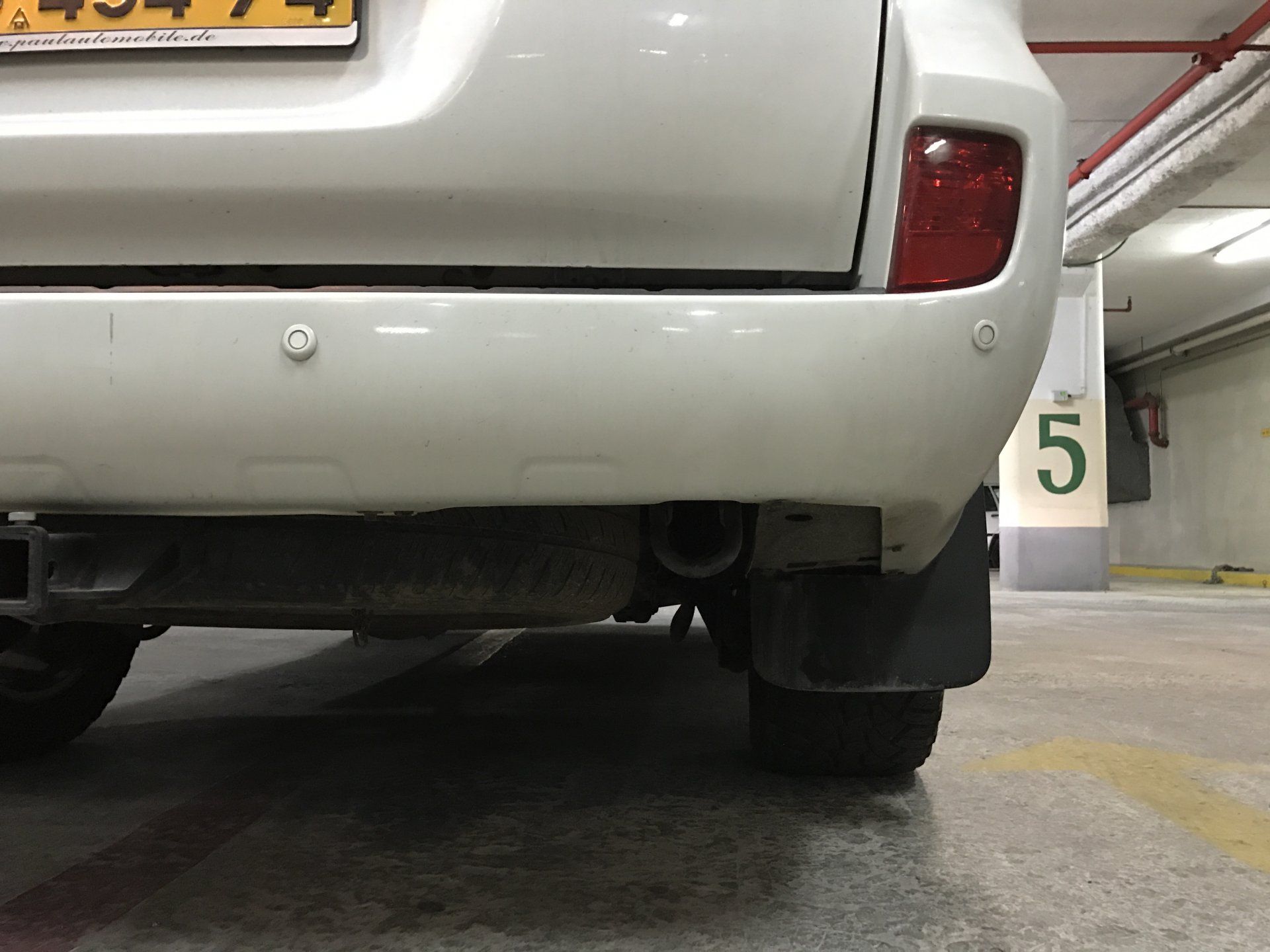

Thanks so much for the super quick answer , what you offer is gd but I need additionally the original ones.
Reson is in my side I am working on giving a hand to evacuate cars after accidents and need some times to use cross belts.
Thanks
Those pictured in your rear photos are tie downs for stabalizing the truck in a container during shipment from Japan to Merica.
I can see things going badly if someone were to use those for recovery, especially at an angle.
Gd mrng thanks very much again , in my left side I have the one I show you in the picture and on my right side in rear I have a bigger one same as in the front what do unsay about them ?
