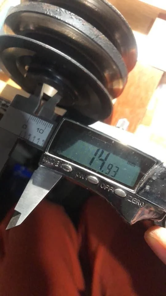

It’s not plug and play, the pulley needs to be machines to 17mm to fit . And If u know how to weld, u need to extend the adjuster bracket .

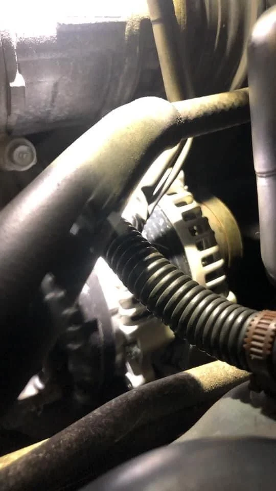

Do you have any pictures of it installed? What you extended of the bracket?

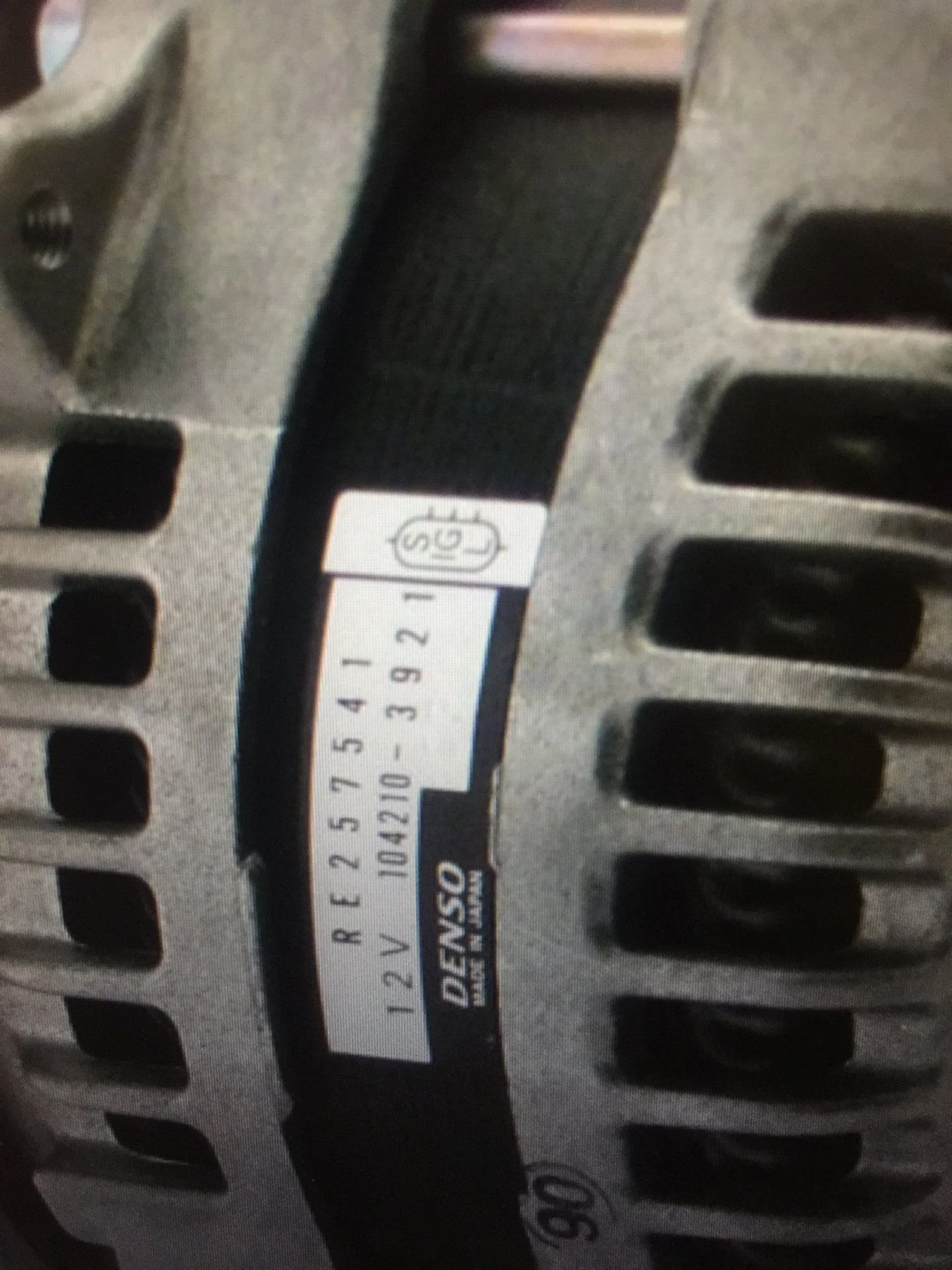

I just googled the Denso part number in the picture. I haven’t changed it yet though. I’ve had to replace my turbo, and rebuild both axles since I posted this.

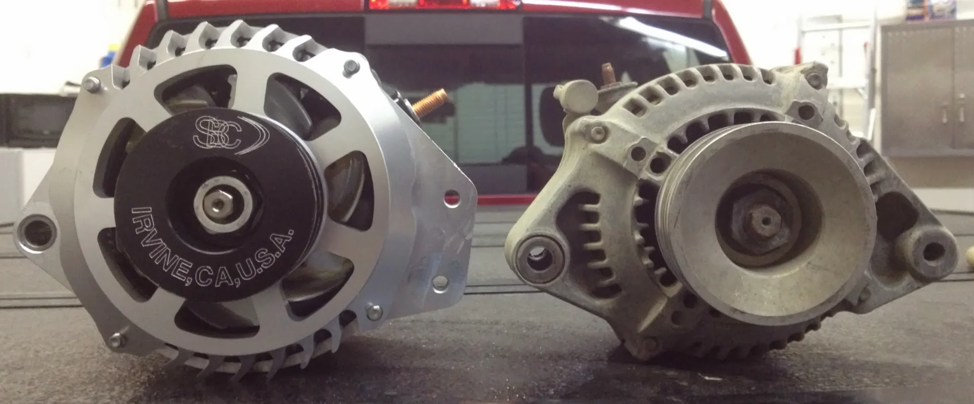

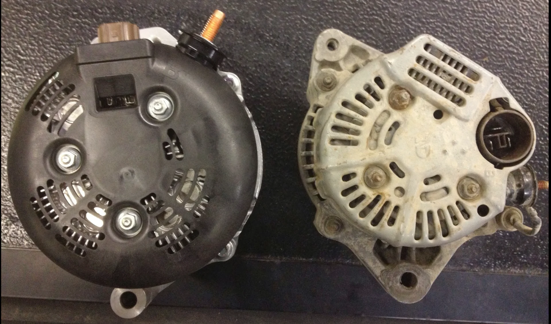

I can vouch for M2K.inc I actually have 2 390A alternators from them
I recently opened them up they use larger Koyo bearings and have better cooling design

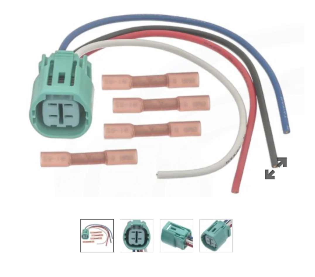

The internal regulator is an IN6301 uses a 4-pin Toyota connector I converted to a 4 pin connector on the harness using napa EC2469
or you can run a pigtail adapter.
I didn't like the pigtail connector too many connection points.

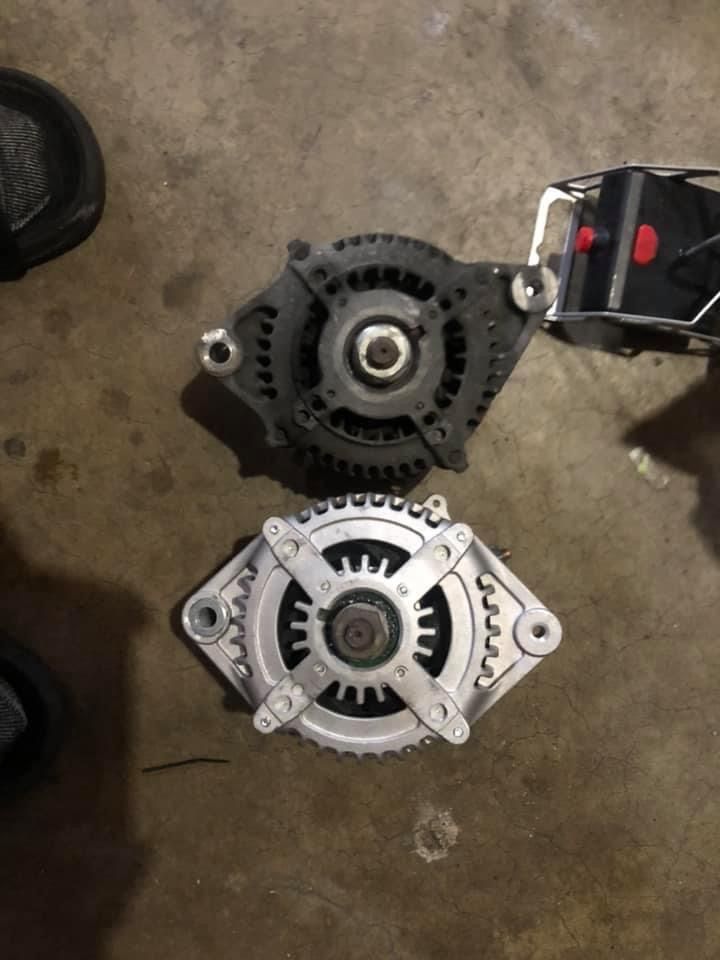

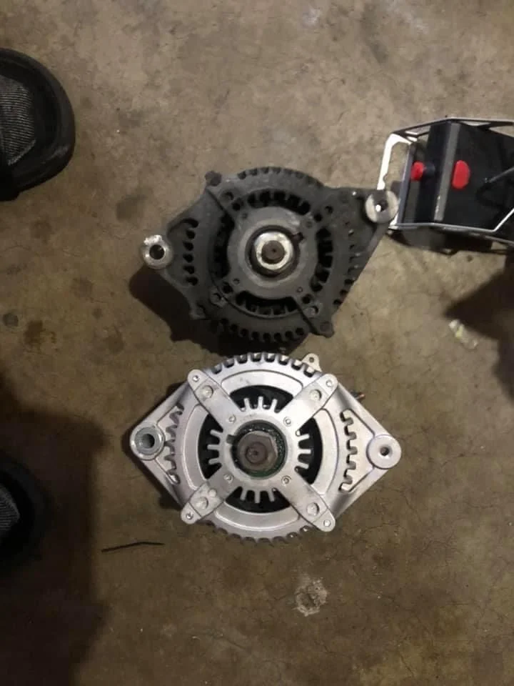

here is a comparison of the factory one
you do have to run the alternator adjuster bracket i believe it the bracket from the 1hdft/1hdfte as the bracket has a different curve to it toyota part #16381-17020
