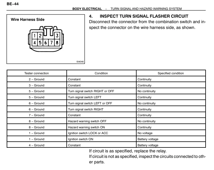

from the service manual I found the pin diagram for the flasher relay (the flasher relay is in the drivers footwell my car is obvs RHD)
clearly pin 8 is the man
so I did a continuity test as specified
off - no continuity - check
on - no continuity - check
so thats the issue - the hazard switch is not providing a ground to pin 8
to test I grounded, it with a piece if wire
Hazards now working - check
OK so now I know what the problem and what the fix is - a new switch that shorts pin 8 to ground - simple

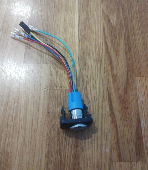

next stop Amazon to buy a switch

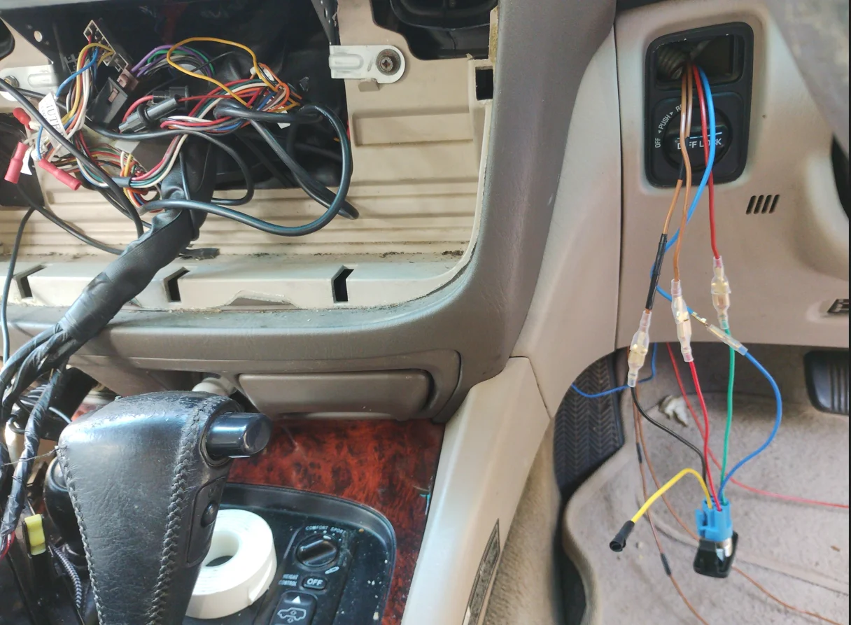

by luck rather than judgement it seemed like it was going to fit in the spare switch above the rear locker switch

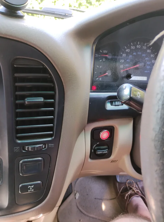

so wired it all up - and bingo, working Hazard switch - hope that helps someone
i did take the central binnacle off - but didn't need to in the end
installed and working
