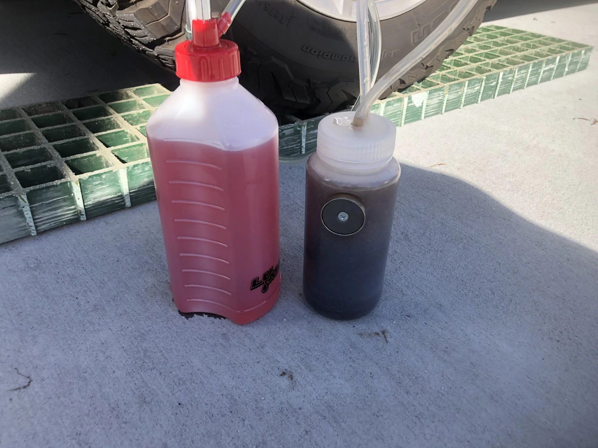

Thank you. This was helpful. I shined from the front, bottom, and side...it wasn’t until I found a way to snack a wand style flashlight in between the spare tire and the reservoir that I realized the reason I was having so much trouble was because the system was ultra low. The only time there was fluid in there, even at the bottom, was when the system was completely lowered...and even then it was just barely in the reservoir.
having the light in that perfect spot showed me.
and for anyone thinking about doing the service: it’s easier than an oil change. New (red) fluid vs 82k mile (brown) fluid.
