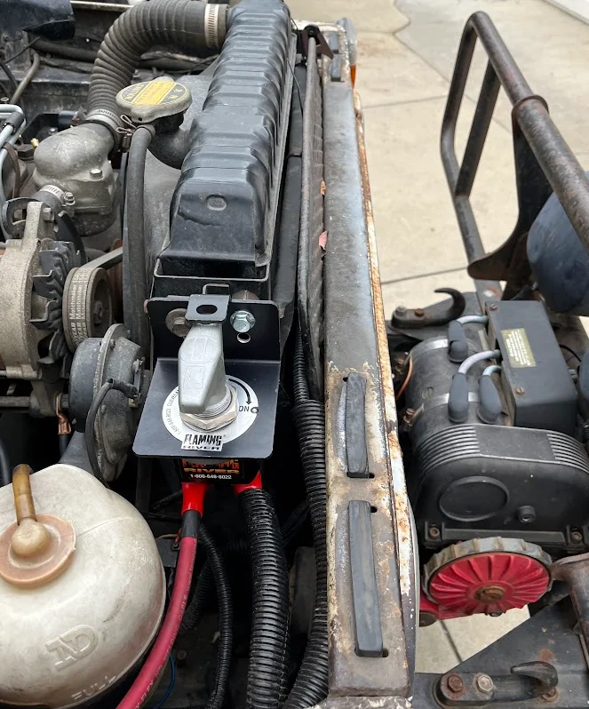

I have a smaller get wired breaker on my house power circuit. The build quality does not instill much faith for winching. I‘m direct wired on my winch but always have planned to do the same as above with a marine switch.
I also added a high current switch like george_tlc. I'd rather not rely on a fuse or breaker, it just seemed too unpredictable and unreliable. Even if it did work at the rated current, you've probably already fried the wiring at that point so it's not really doing anything useful. Or, if it doesn't work at it's rated current, then your stuck without a winch and you probably won't find out until the worst possible time.
With the switch I can disconnect power to the winch until it's needed, and the only thing I have to worry about is the short length of wire connecting the switch to the battery.
