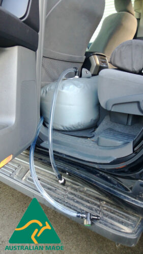

I use a 110l bladder.

I paid $255 usd and I wanted something that was easily storable (it is about the size of a small sleeping bag rolled up), if it wasnt filled to capacity it wasnt the same size and I wasnt limited to where it needed to be if other passengers in vehicle. With it between rear seat and drawers it holds 12 gals. I also was wondering if I could create a space under the vehicle or somewhere else to install. Not there yet because of planning around weight distribution. Its about 250 lbs filled.

Love the capacity, and flexibility. Price is a bit prohibitive for what it is. If it could be sourced in the USA that would make it really reasonable, especially from a warranty standpoint. I am going to remove the 60% seat behind the driver and build out a platform and keep the single seat. The Front Runner Footwell storage is easily removeable if not full, or with 2 people it only weighs approx 90 lbs.

Just bought the FrontRunner Footwell tank, measured the 100 2nd row and plenty of room to spare. doesn't stick up very high either, the tunnel allows air flow from the vent under the center console, and doesn't interfere with my Rugged Radio comms system mounted to the back of the Center console either. Moving forward with the removal of the 60% seat and buildout of a platform for luggage and other peripherals.

Ya it isn't cheap, for sure. That was why I got it on Black friday sale. At least it saved some money but they don't ship for free. So you getting to pick it up would save $ too. The stuff we put where it goes will just go on top of it. It is a nice flat surface on top with cross hatch for none slippage, but we will probably put a non slip runner on top of it. Cooler and other quick accessible stuff go there for us.
