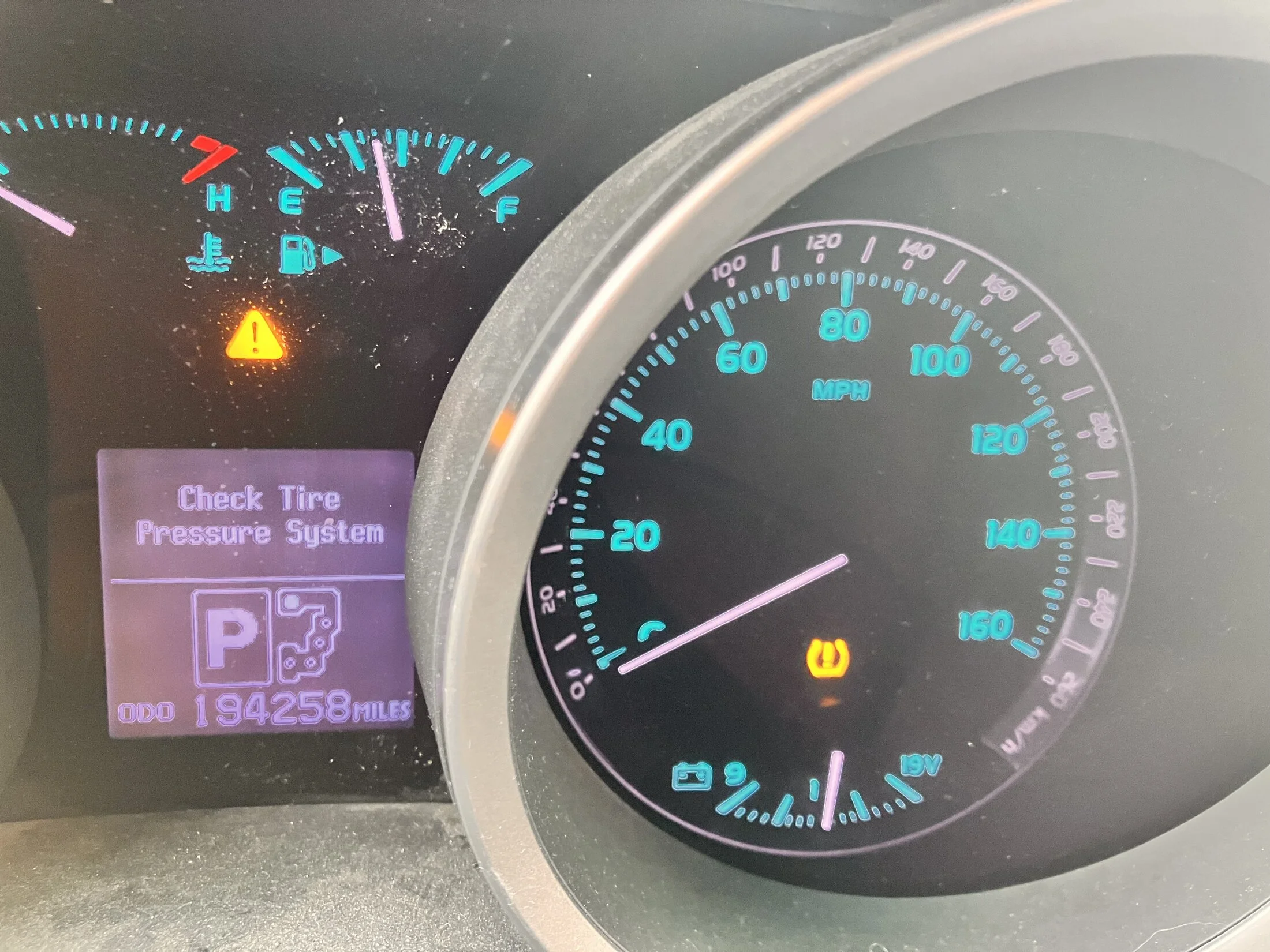

Anyone have this trio of trouble lights? My tires are all at normal pressure.
I’ve had a TPMS sensor go bad before but don’t remember getting this message.
Thanks!
2014 lc here. when my tpms sensors go bad (frequently i might add), i get the tire/exclamation point icon error and then the readout of my tires and their pressure. this stays steady for many days. if i wait to have the sensor replaced and reset (sometimes up to a few weeks), i no longer can gain access to the tire readout and it instead defers to a 'check tire pressure system' message similar to yours instead. i don't recall ever getting the triangle with exclamation point however which may be a separate issue.
i might add that the readout of the tire pressure usually indicates which sensor is no longer communicating properly. for me it's almost never low pressure but a bad sensor or low battery
I just got this exact combo this weekend in an 08. Same miles too btw.
TPMS had been reading fine. 2 showed sensors were reading low (but had readouts; 29,27) and were highlighted so I aired all tired up to 34psi and instead of the warnings going away as anticipated I got the three lights you did and the two low units just get stuck in “reading” status :/
Either you have a low tire or a bad sensor. Make sure you check the pressure in the spare also.
Did you recently have your first cold snap? Cold temps drop tire pressure, and often the first really cold temp of the season signals the need to top off pressure for the new season.
Agree with above
I believe you get the 2 lights and the message when a sensor is going out or no longer detectable. I don't think you get the triangle and the message when simply a tire is low but i'm not 100%. From experience, until the sensor(s) are replaced, the triangle and message will not go away and you wont be able to see tire pressures for any tire.
