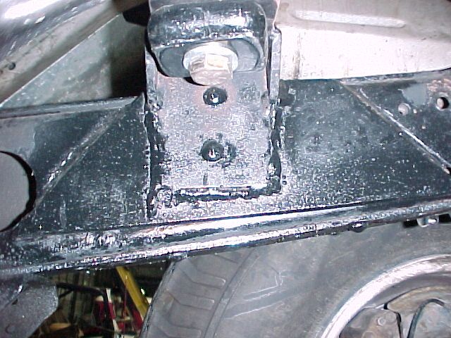

for some critical stuff you may want to avoid plain vertical shapes and joints when welding on the frame. those can be bad stress risers. My trailer frame has some poorly designed tilt binding that were welded vertical all the way through the frame height. Once the frame cracked open right at the joint along the entire height. Scary stuff. Needless to say, I reinforce/repair plated it in a <> fashion.
What you did is probably OK, but you might think about it for some later jobs.
keep the good work going ;)
:beer:,
Thanks - That makes sense... I will be reinforcing that area with some 1/4 " plate when I build the motor mounts. Hopefully that will hold.
Radd Cruisers said:
Just to point out, although I am by no means a good welder, that your welds look cold, not much penitration?
Rob
Yup - actually had to cool it down a little as I was blowing through... Good penitration :D

I had to plate my POS frame from the motor mounts to the front of the rear springs. We used 1/4. Heads up when you weld in your motor mounts make sure you have you atlas on hand to jig it up, with drivers side drop 60 and sm420/5.0 atlas to clock it all the way to flat we had to egg out one motor mount hole to allow the atlas enough room on the frame rail. It would be nice to weld the motor mounts once plating was done.

That's what I'm waiting on. I got the Atlas yesterday. But I'm waiting on the 700R4 so I can mate it all up and get everything to fit just right. ;)
Bruce, I thought I had a picture, but can't locate it, when we did the motor mounts for the 4.3, Josh made the scab plates about 5" at the top and angled them down to about 12" at the bottom, this way you have a nice semi horizontal line to weld, they really look sweet, I may can snap a pic tommorrow.
Butch
Butch
Butch, That would be great. I want to do this once... Thanks!
