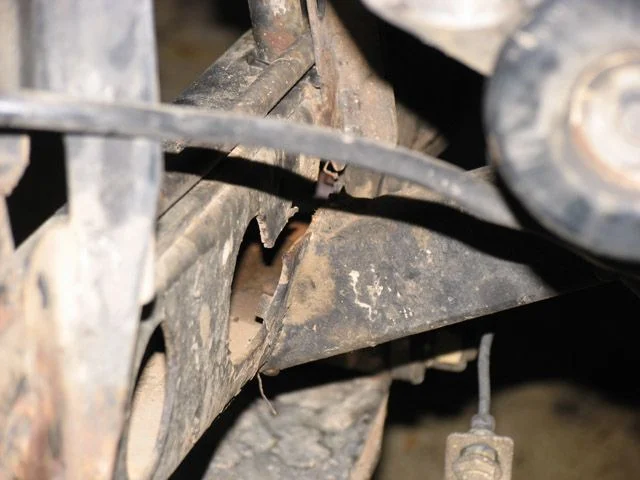

Runs during the past year:
Cheeshead Invasion - Clayton - Broke a DS rear axle - actually Butch's fault
Lone Star Roundup - Katmecy - Broke DS rear spring
Tin bender's Jambo - the Hammers - on the gate Keeper to Wrecking Ball - Broke 1 DS rear Axle, 1 DS rear spring, 1 PS 1st Gen Longfield, and a PS motor mount.
Razorback Ramble - Superlift - Hot Springs, AR - DS rear Spring Pin. Really found out that I had broken the PS motor mount.
I'm tired of breaking!

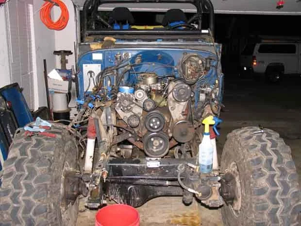

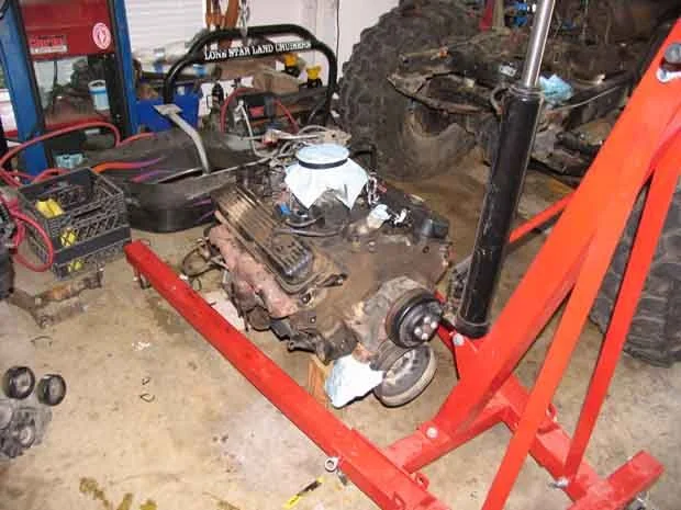

Here's the plan:
Keep:
engine - 350TBI
Replace:
SM420 w/ Sunray 700R4
Toyota TCase w/ Atlas II 4.3, 32 Spline upgrade, 1350 yokes, Short Tail housing, Cable Shifters
Rear Axle w/ Sunray Ford 9" - still working on the exact specs
Rear suspension w/ RockTaxi (Ed Westerbeck)4 Link, Coil Overs.
Front Axle w/ - you'll have to wait.
So far I have:
ordered the Atlas - will be in this Friday.
Pulled the engine, tranny, t-case.
Done some long needed cleanup from the PO.
Let the fun begin!
