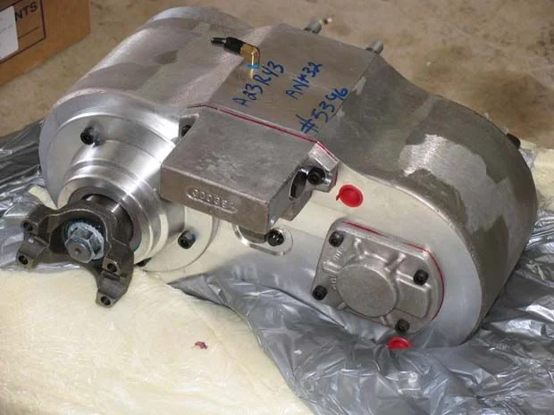

Talked to Lance @ Sunray today. Transmission should be done by the end of the week. :D
