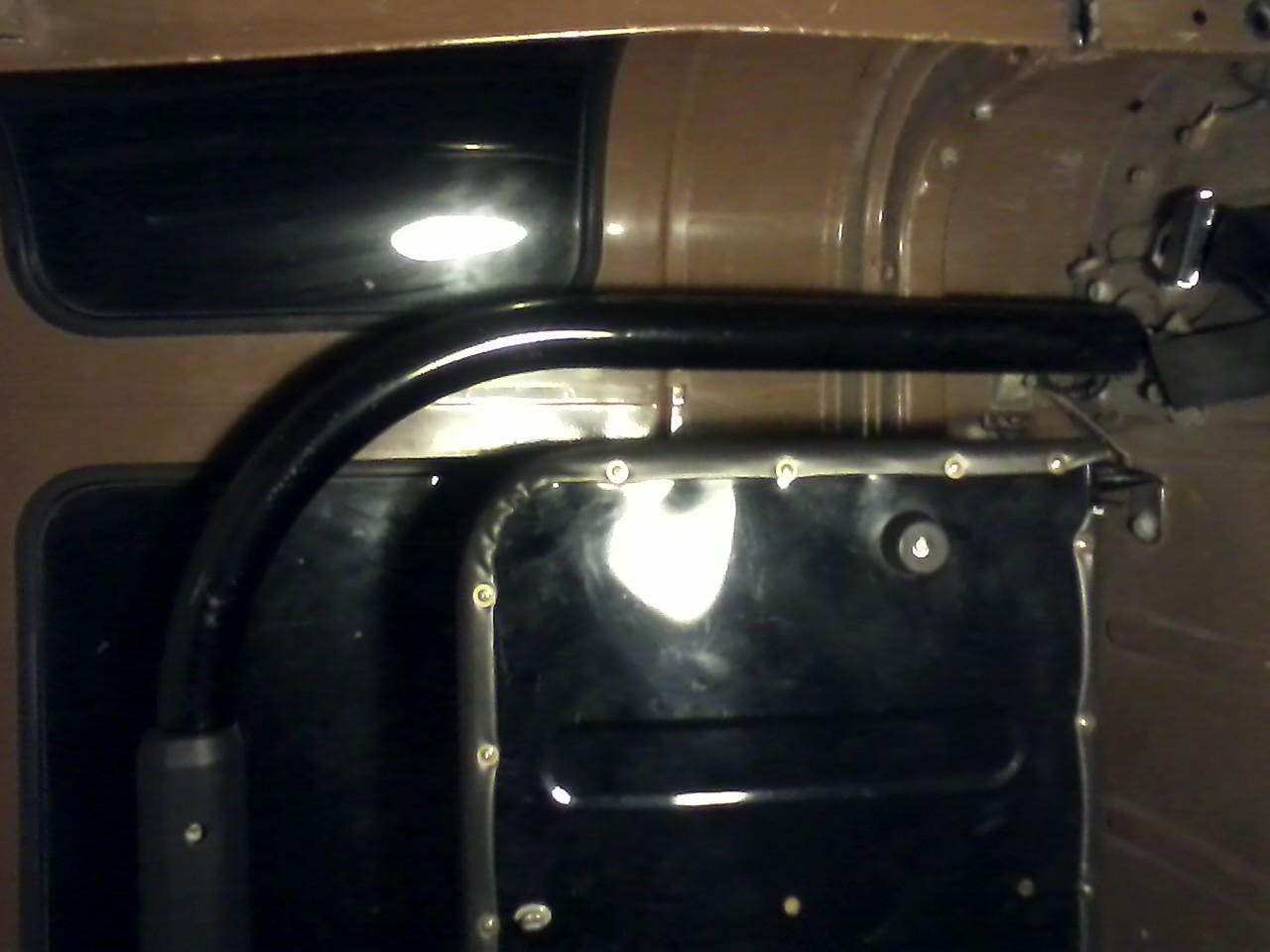

We all know that the factory roll bar is not that stable but as I said I don't do much wheeling anymore but I like my roll bar since it was in the truck when sent here. What I did was cut the horizondal extensions off just enough to clear the latches plus I have a bench seat in the rear. Yes it was worth it because I like the vents in the back for air flow plus passengers if any can get a little air or dirt lol. Plus the fact that the vents were in the 81 top anyway because when I got my rig it had a soft top and choices here for 40 parts are far and few between. I am not sure that you can see the roll bar in this pic but it sits just in front of the vents. Hope this helps some.~ Rob
Can't see the bar... But do I understand correctly that you shortened the top tube to move the corner further forward?

THose are the older style. The latch will interfere. Any chance you could find some newer rears or extend them to move them back a little further?

No Smurf I shortened the two smaller bars at the connection point to the large bar. Shortened I think 3" just enough the get to the vent latch. I was thinking about doing the semi cage thing like you did as well when I first saw yours lol.
