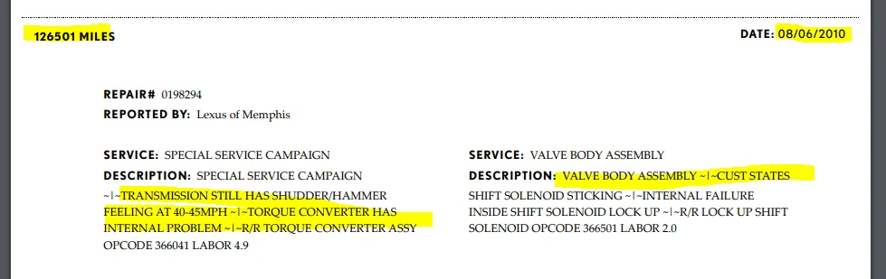

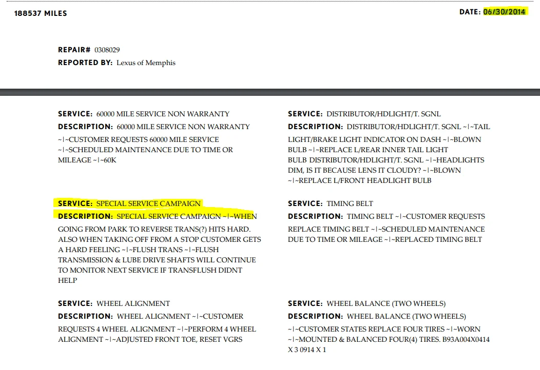

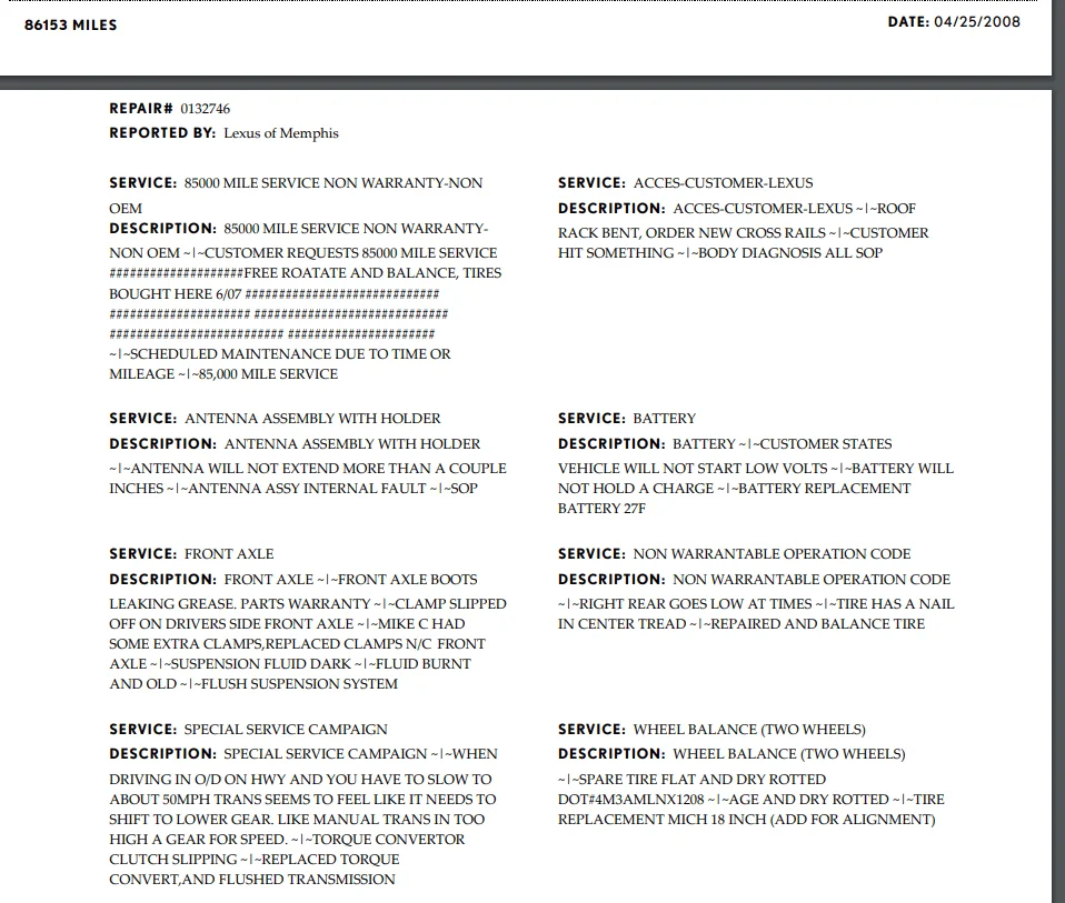

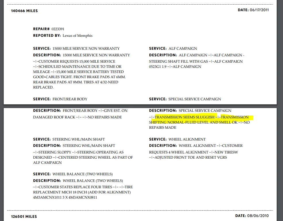

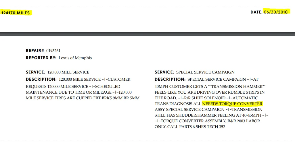

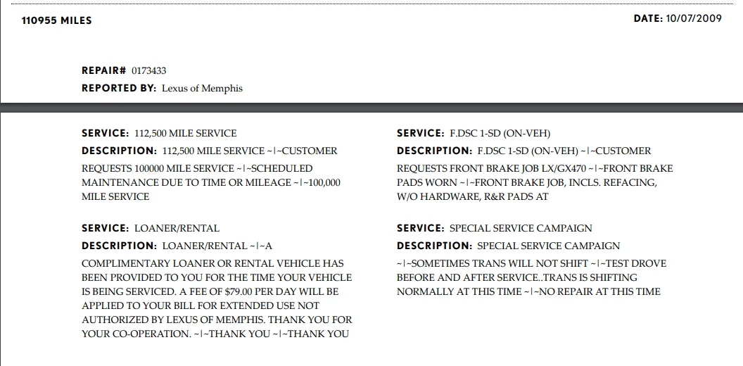

Looking back at the service history, the PO seems to have had repeated problems with the transmission or torque converter (replaced torque converter in '08, and again in 2010), which is not encouraging.
I've attached the relevant service history from LexusOwners.com if anyone is curious.
Thoughts? Should I just flush and add some sort of additive? Solenoids have already bee
