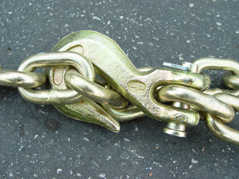

best to have *2* chains with grab hooks, well the kind that hook between links. That way you can adjust lengths, go back and forth between 1 chain and winch etc to keep moving. Can't adjust the length of a strap or wirerope quite as easily... :)
edit: called it choker hook, I think the correct term is "grab" hook... what I meant is the kind of hook that allows you to grab onto the chain at any location

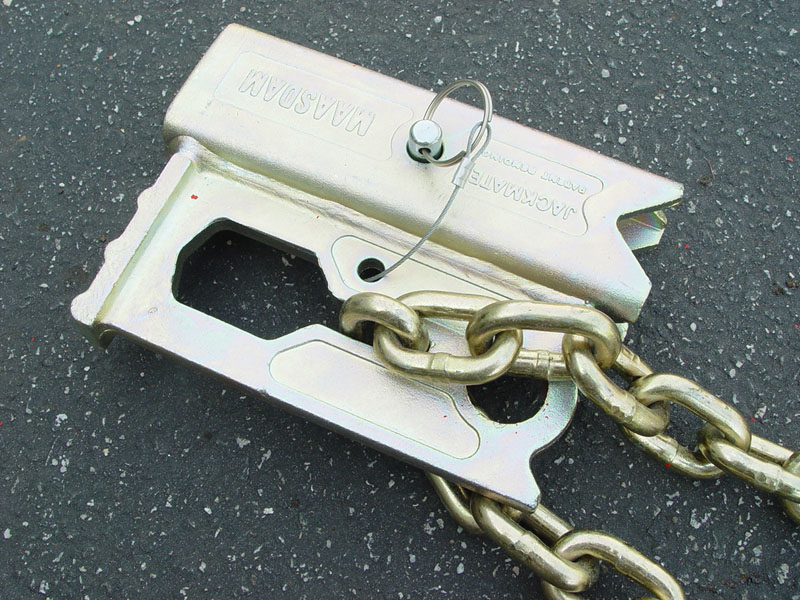

Like this.
A Delta tow strap chain with the grab hook could be useful when attaching chains to staps.
