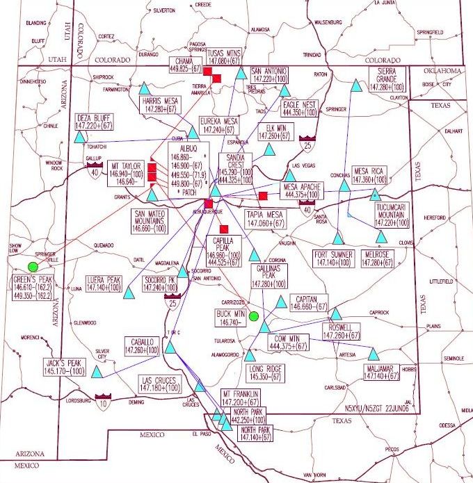

Here in NM, we are fortunate to have something called "The Mega Link" This is a group project by the amateur radio operators throughout the state. They have set up repeaters on all the mountain tops such that a radio operator driving through the Carlsbad area in far Southeast NM can communicate clearly with a radio operator in Shiprock (at least that's what I think it does... haven't tried it yet ;) ).
"All of the repeaters shown on the maps are open to any Ham radio operator."
http://www.urfmsi.org/graphics/map_urfmsi.pdf
Here is a map of the NM repeater system:
-Mike-

Re the map - correct me if I'm wrong, but the + or - means your transmit (the repeater receive) frequency is either above or below the repeater transmit (your receive) frequency, respectively; and the number e.g. 100 is the PL (private line) tone frequency.
