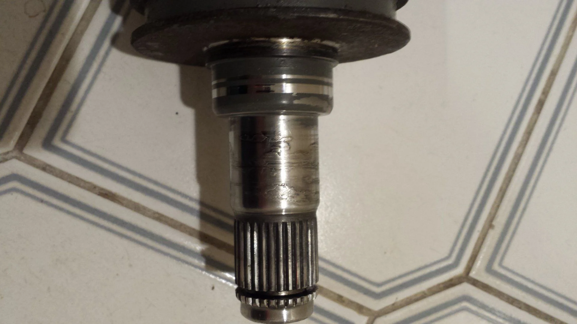

Finally got the shaft removed, and understand why it was hard to remove. The inboard tulip stem (just before the spline) is pitted/scored. Picture attached showing the condition of the tulip.
Question: Can I reuse it for the moment, at least till I can replace it when the weather warms up, or will there be side-effect to using it? The balls, cage and race are all in good condition.
You should at least replace the seals in the diff. You might get a fine scotchbrite(1500) and gently clean up axle.
Edit: I did not see that pitting- indicates the bearing race might be toast.
The bearing inside the differential housing? How hard is it to replace that? Also, does that mean I can't reuse the tulip pictured above and need a new one?
Thanks.
Initially you can look into the dif and inspect the roller bearings the axle is riding on: spin each one to inspect ( look & feel) for damage. I haven't replaced bearings in the diff- not sure but it would prob have to come out to replace bearings.
More experience than mine required here to best answer your question.
