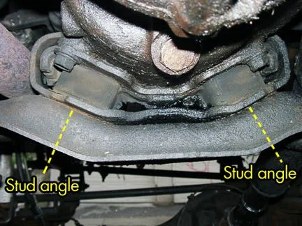

Check for a broken tranny mount (the cradle style)

...or a broken engine mount which would allow for engine movement, pushing the shifter against the body - knocking it out of gear.

The mounts seem ok..
