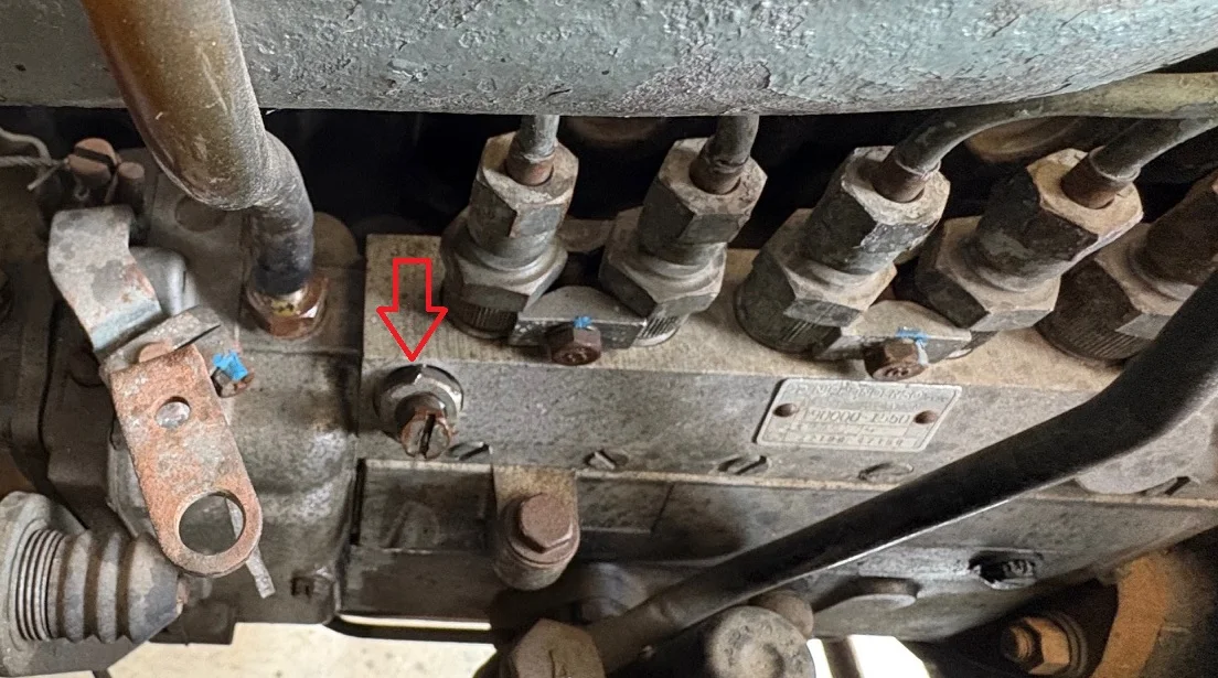

I have a 1978 HJ45. The screw on the injector pump with the red arrow pointing to it broke. I am not sure what it does (maybe the altitude compensation?)
Any idea where I might find another of these screws and what it does?

This is the pump body bleed screw.. find whatever you can to seal it, its not critical.

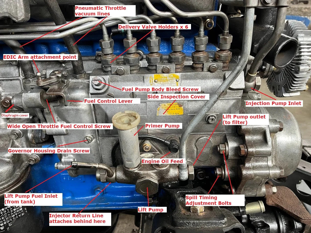

2H is probably the same part.. here's an image showing parts of the 2H pump for your interest..
thanks. I can see its the air bleed screw. I will look around for something else to put ion the hole and see what happens
