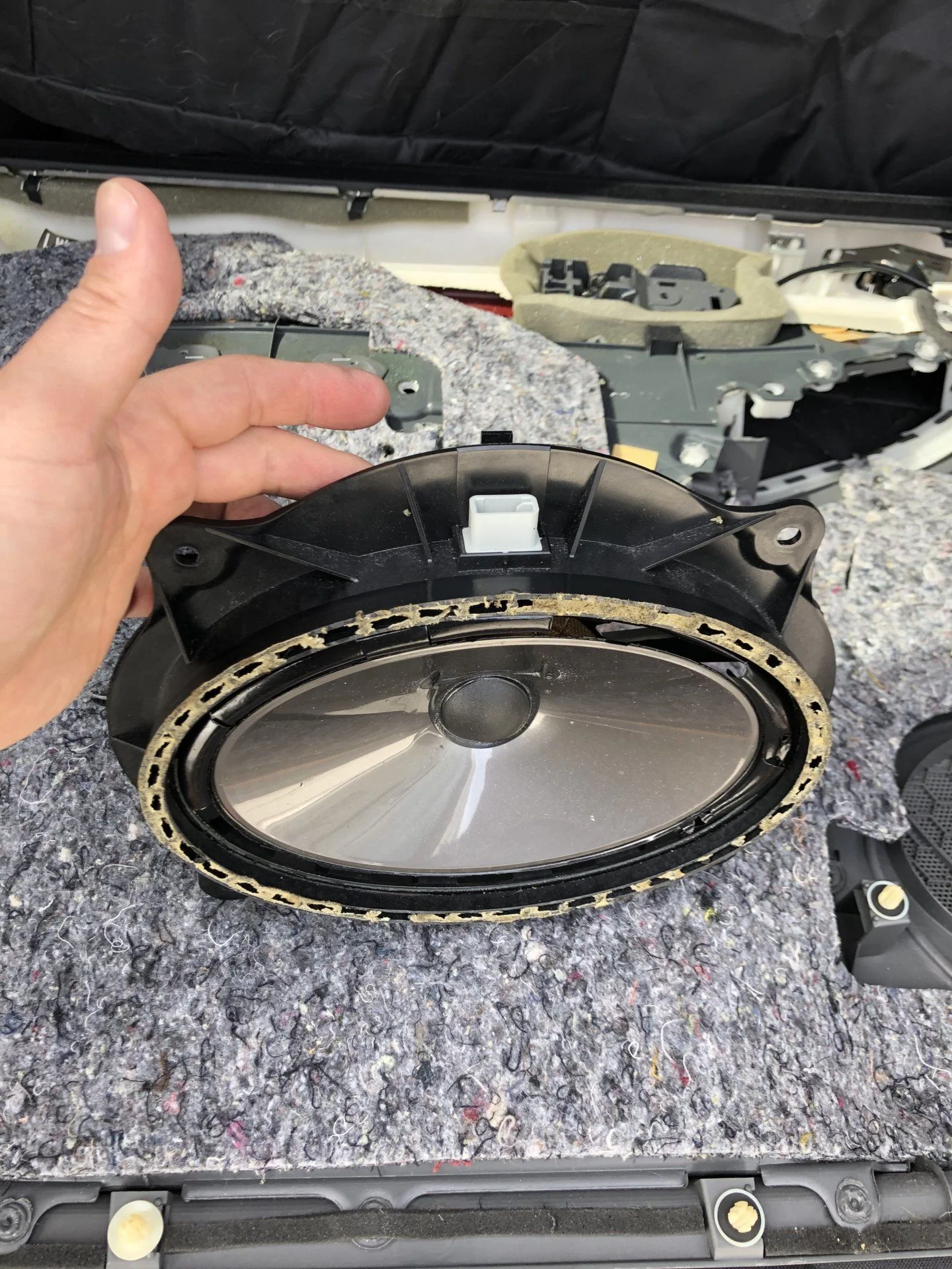

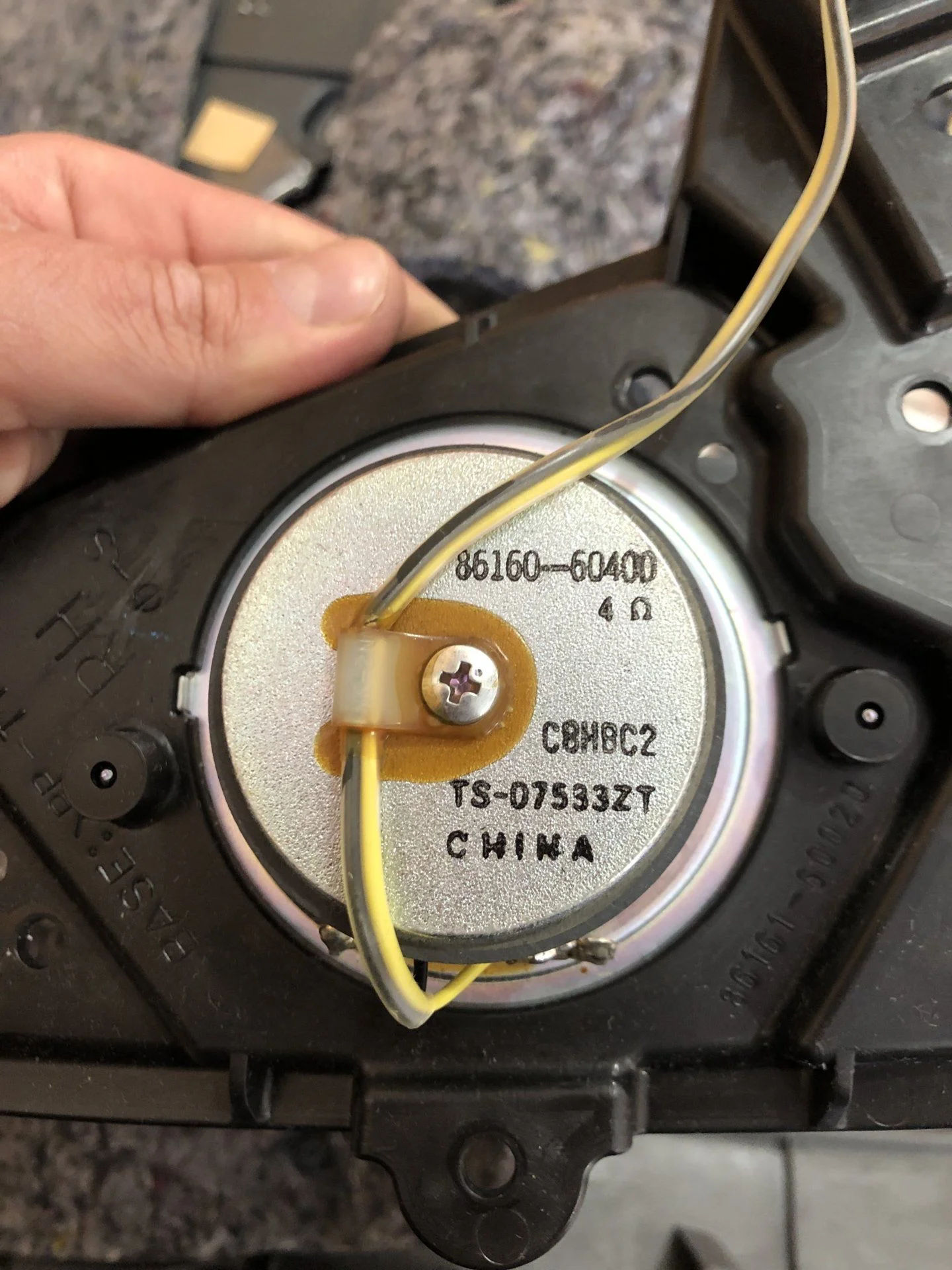

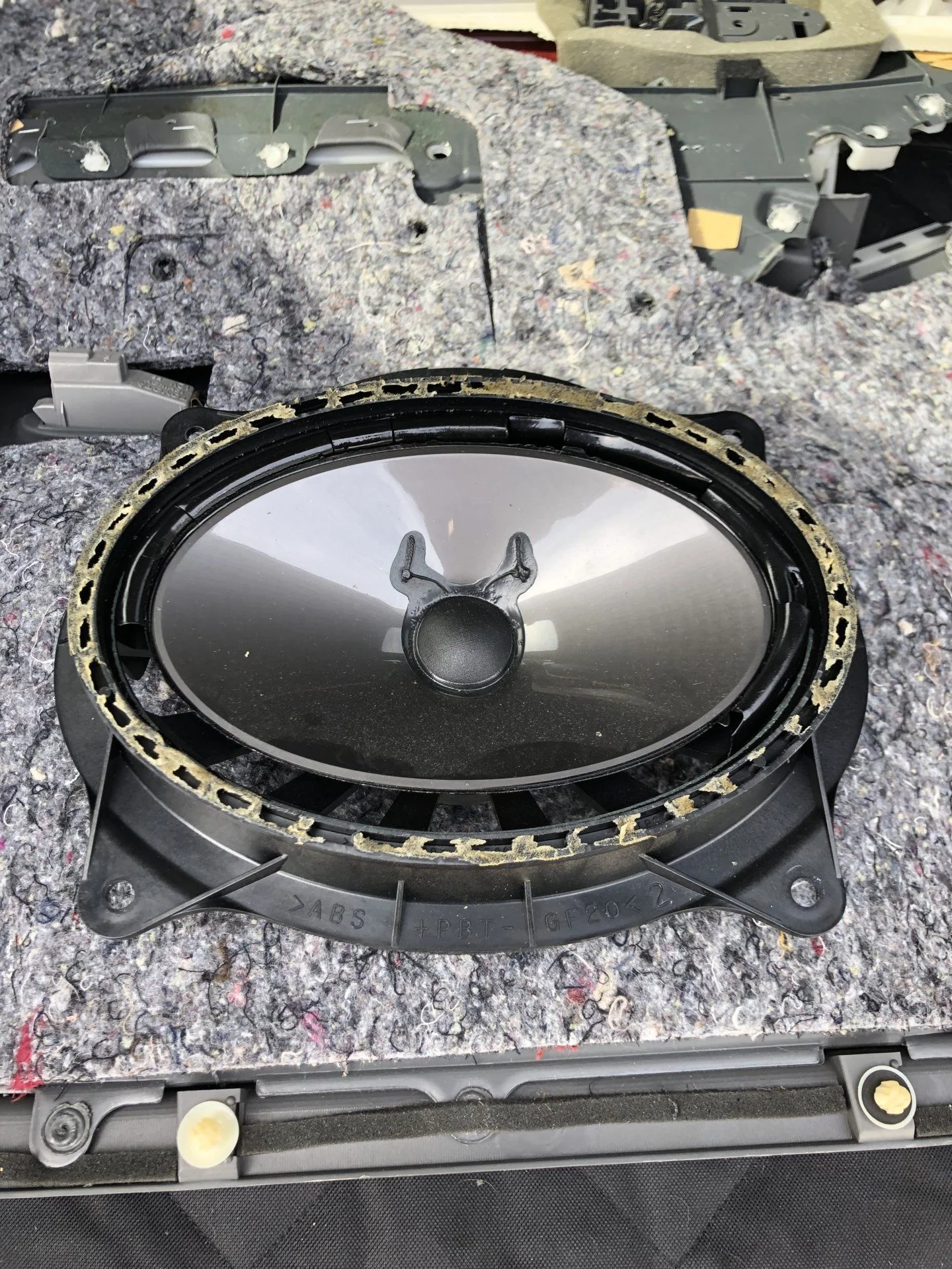

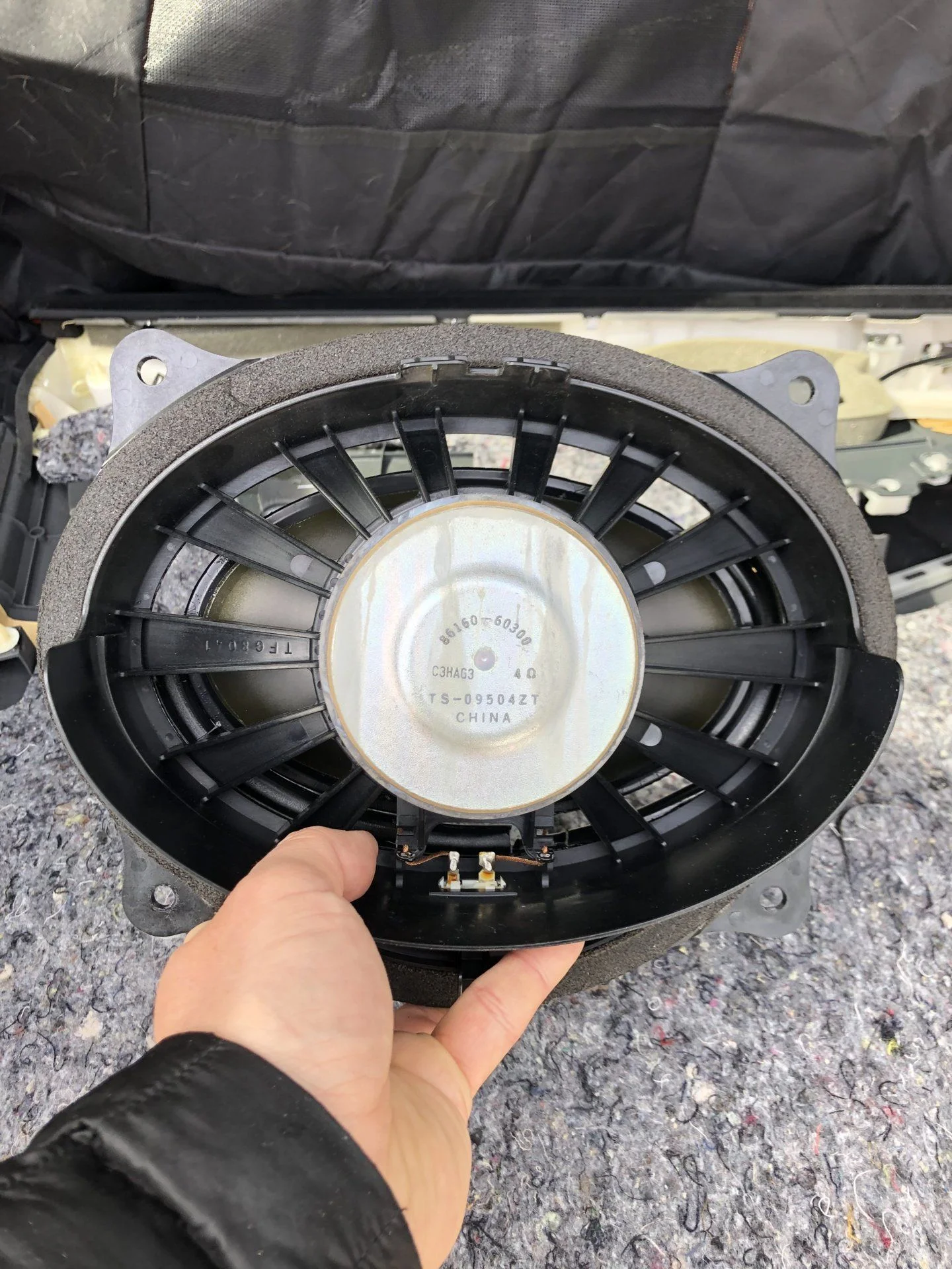

They are 4ohm pioneer speakers. I’m in the process of swapping out/documenting the factory non-nav head unit and speakers with the following:
- KENWOOD Excelon DNC-693S
- Focal IS690 TOY components for front and IC165 for rear door.
Hoping the setup will be fine for stock Pioneer amp for now.

Pics of my blown speakers.
