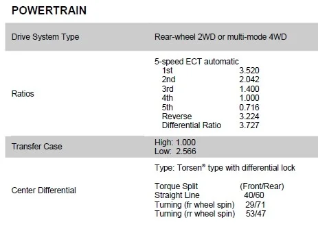

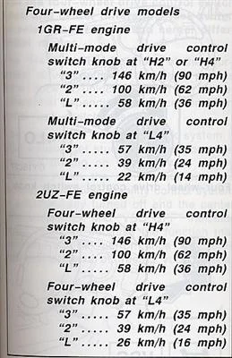

Found this from a 4runner forum:
We've got a different transmission, and 5th gear doesn't work in 4-LO. So in 4th you'd probably top out at 45ish mph, but it would "feel" and sound is if you were pushing the car over 90mph.
This one is also from a 4th gen 4runner, so pretty similar if not the same - looks like 4-LO & 4th is actually a lower gear than 4-HI and 2nd.
