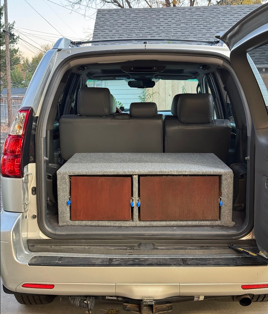

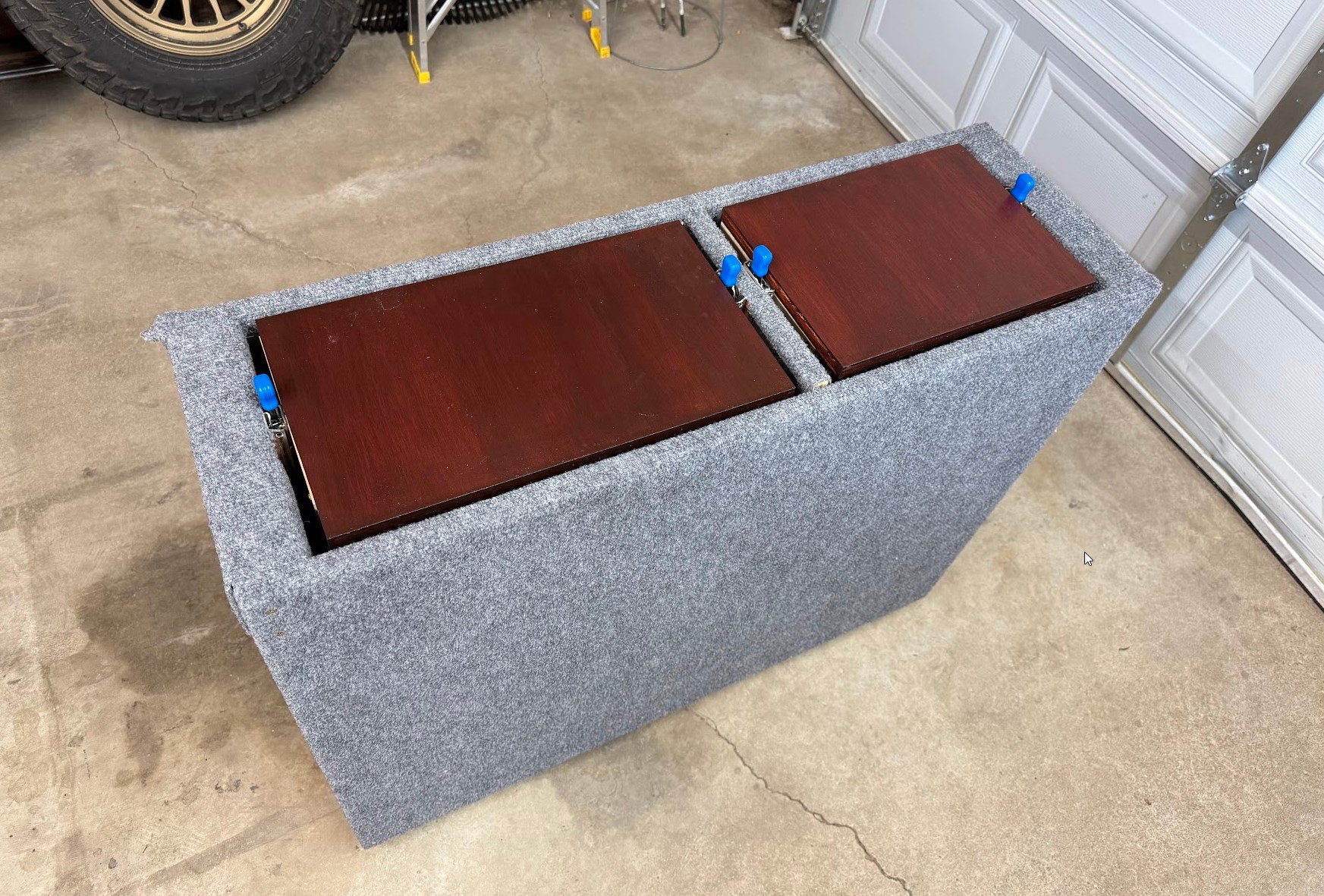

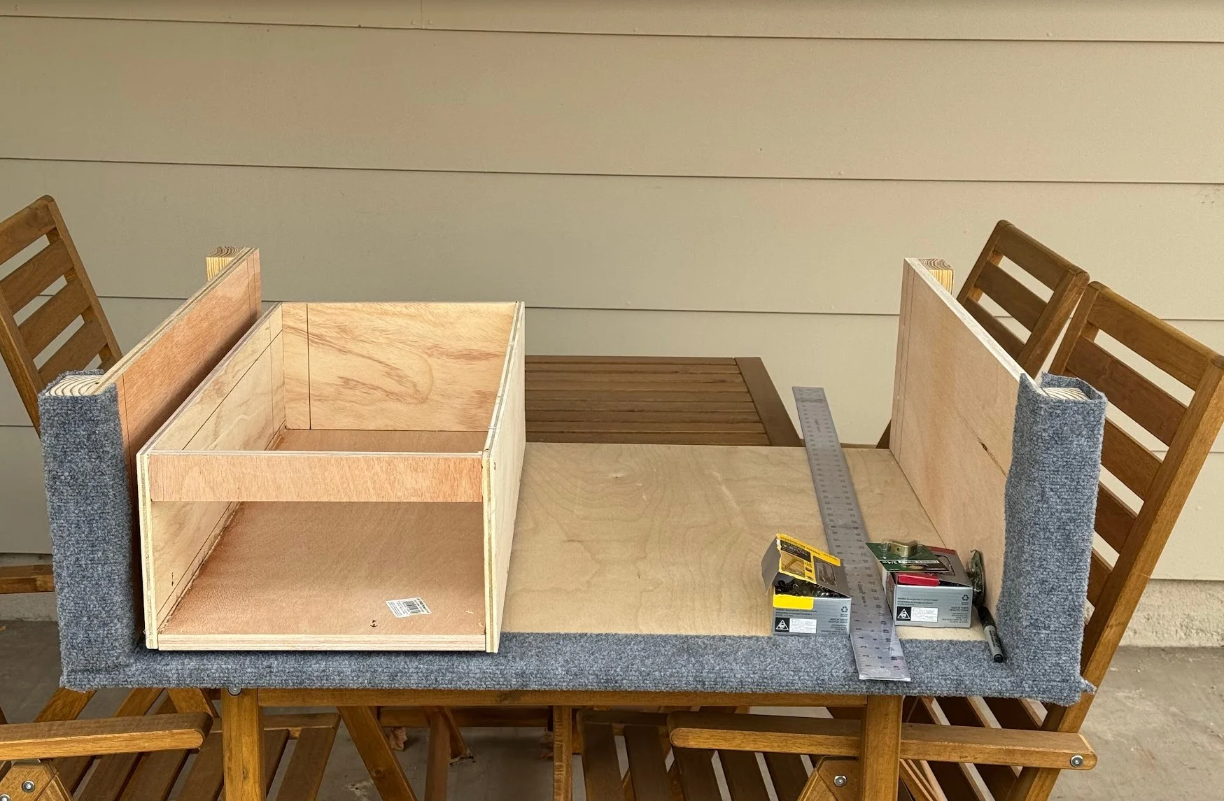

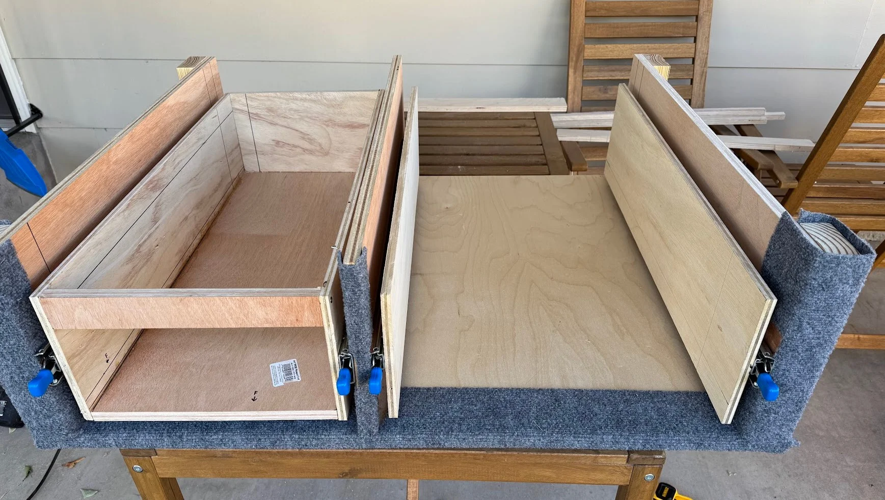

Recently got back into GX owenership after selling my first one, and the first project was to build a drawer system/sleeping platform.
It is fairly straightforward but also definitley overbuilt, using mostly 3/4 in plywood, and 2x4s, and therefore very heavy.
The slides ended up taking up more space than anticipated, however I am very happy with the final result.

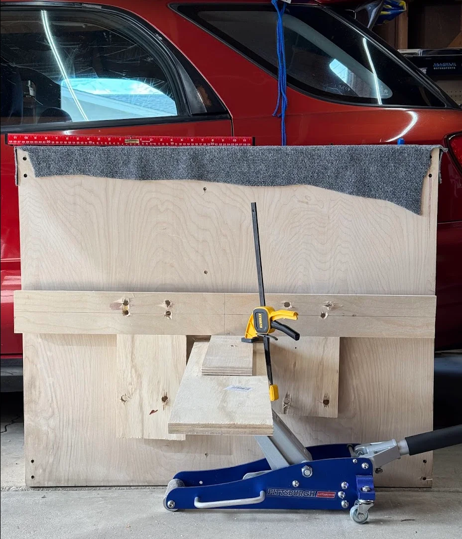

I ended up removing the third row seat mounts, and getting longer bolts to attach it that way
I mocked up a template, and very precisely
marked and drilled the holes, to keep the front of the drawers where it needed to be,
It bolted in just fine and with the bolts and washers feels very sturdy

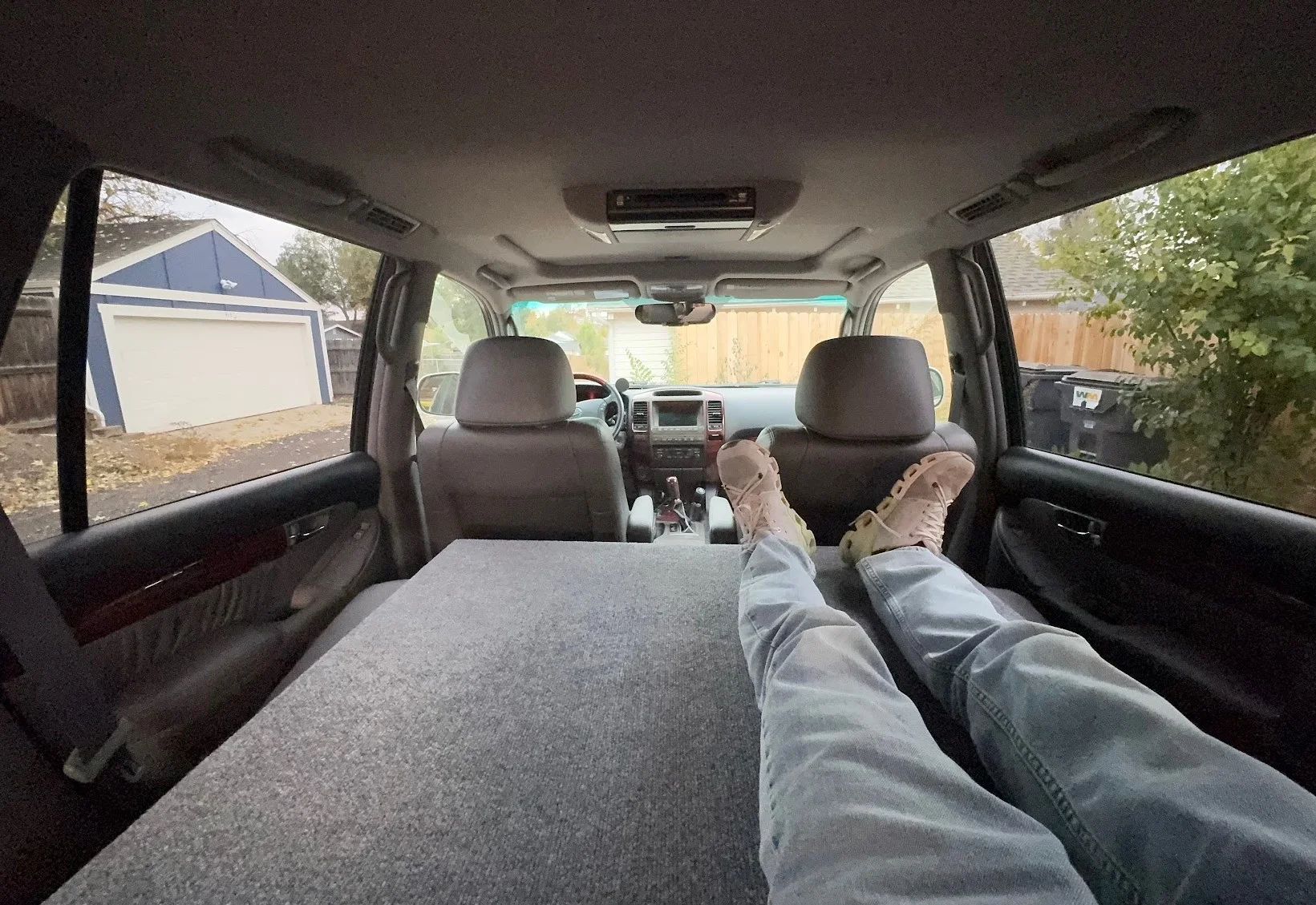

Looking forward to camping in it,
