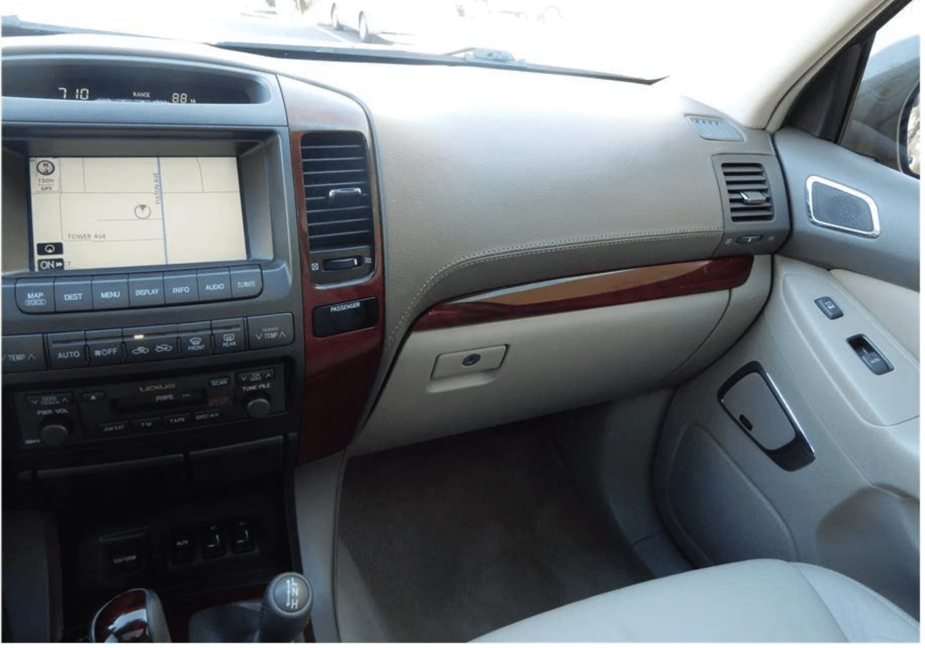

I have been in the market for a GX470 and have learned about the dash issues. To my knowledge, the replacement dashes given under warranty look exactly the same at the original ones. But in my search I have found 2 rigs for sale in california that have these leather stitched dashes. Photos provided from a green 2008 and I also saw this dash a blue 2003.
Was this dash apart of some factory option/ trim level, or is this a custom job done by a interior shop?

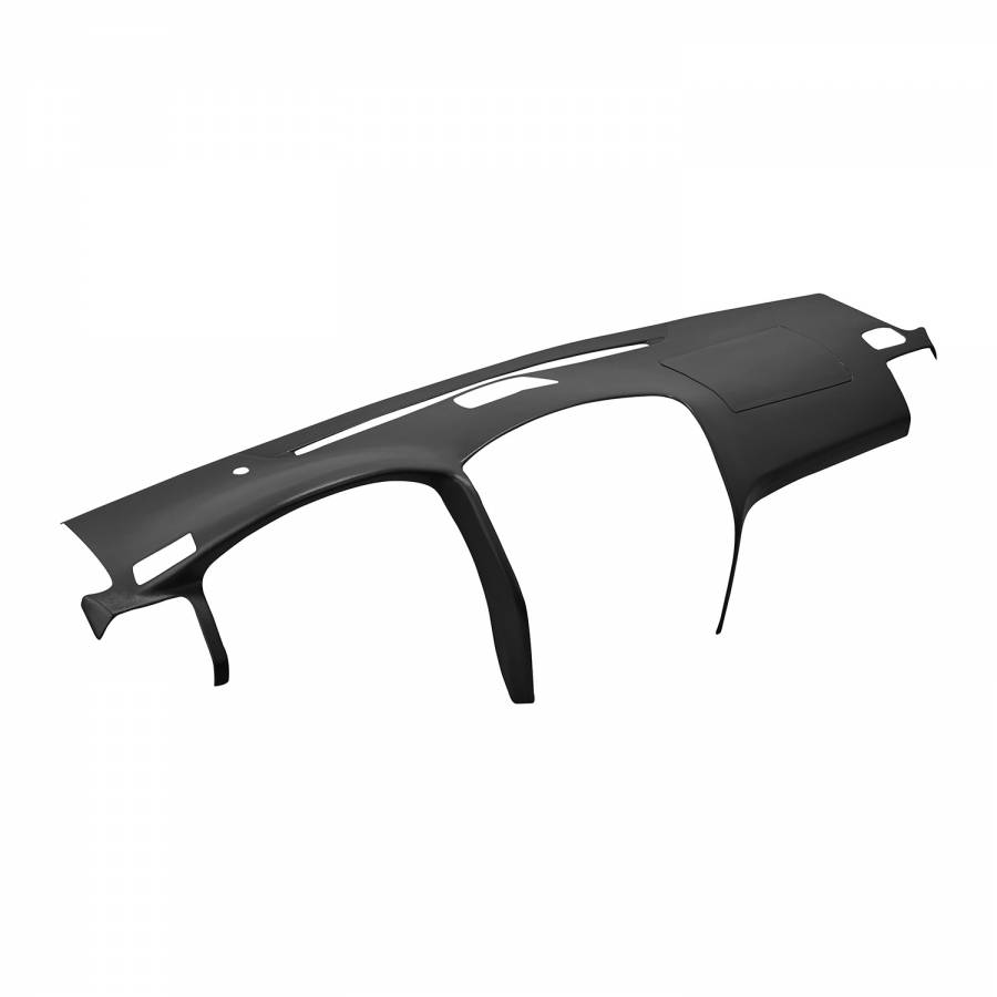

Never seen those before, and they look great, but how is that passenger dash airbag supposed to deploy? I saw other overlays when shopping for my GX, like posted below, that had a cutout for the airbag to safely deploy in the case of an accident:
Following. Love these? Must be a custom deal?
After talking with a friend who works at a Lexus dealer, I have been told that these were never made by Lexus. I also don’t think they are stuck on over the old dash. It seems to flush and I cant find any overlays with the same stiching. I am assuming that they are a custom job from an interior shop. I do find it strange that I have seen 2 with the same pattern though.
Both were in California... And right across the border are some of the best and cheapest interior shops you can find. Just the type of shops who would cover over an airbag without a care in the world.

It appears some dealers may sell the OEM dash for around $600, although shipping is not cheap. I'm just going to go the OEM route when I do mine. It's the last thing that I'll upgrade on the GX...a lift and lockers are more important than looking at a few cracks.
Someone really needs to come up with a better aftermarket dash option though. The Coverlay gets mixed reviews and the OEM dash labor indeed appears to be a bear.
