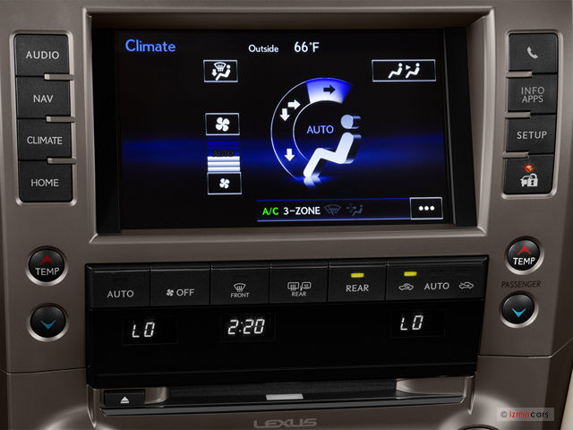

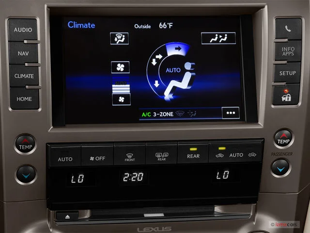

Infotainment system changed in '22+. One change other than Apple CarPlay was that some A/C controls were moved to physical buttons. As someone with a '21, I really really really wish I had that. The old infotainment system is slow and just feels terrible.

Agreed, Carplay is nice, and blower motor buttons are nice. But I actually also prefer the older layout, it makes more sense to me.
