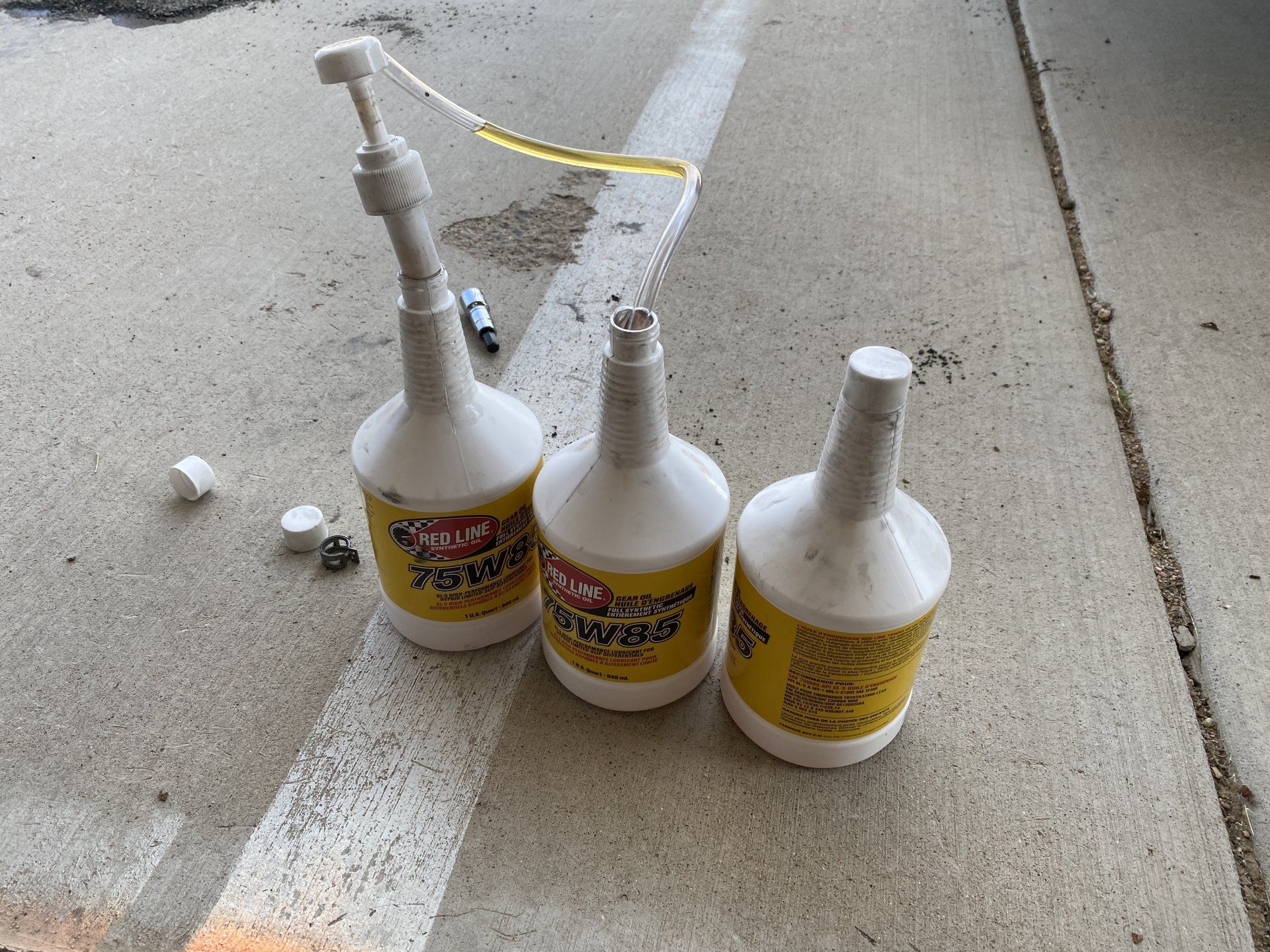

Ordered so far (5 quarts)
Red Line 50104 75W85 GL-5 Gear Oil, 1 Quart, 1 Pack
Amazon product ASIN B000J3G8KE
New crush washers:
Rexka 12pcs Transfer & Differential Service Gasket Kit Compatible with Toyota Lexus 4Runner Land Cruiser Tundra Tacoma FJ Cruiser Highlander RAV4 Sequoia Sienna
Amazon product ASIN B07CJHTDVV
And a Pump:
Slippery Pete Fluid Pump for Quart Bottles - Transfer Gear Oil, Transmission and Differential Fluid with This 5cc Hand Pump (1)

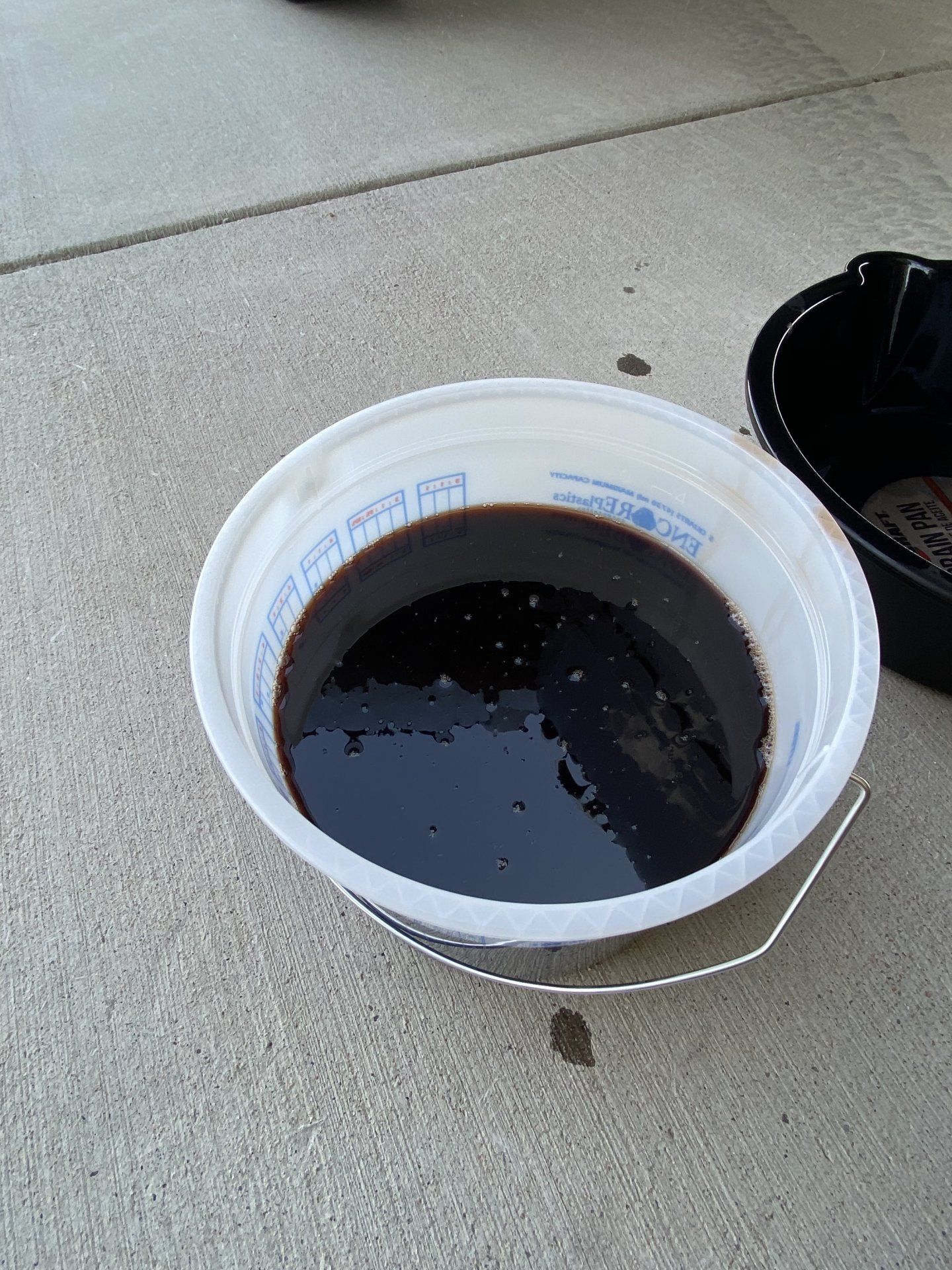

Just changed the Diffs.... Couple notes I think might be different for my year (2018) 31000 miles.
Front uses 10mm hex for both drain and fill. Located on drivers side.

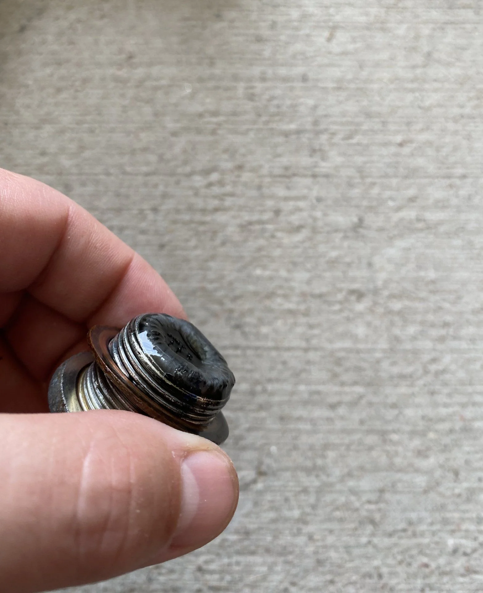

Both the front and rear had magnetic drains, both where covered up in metal.

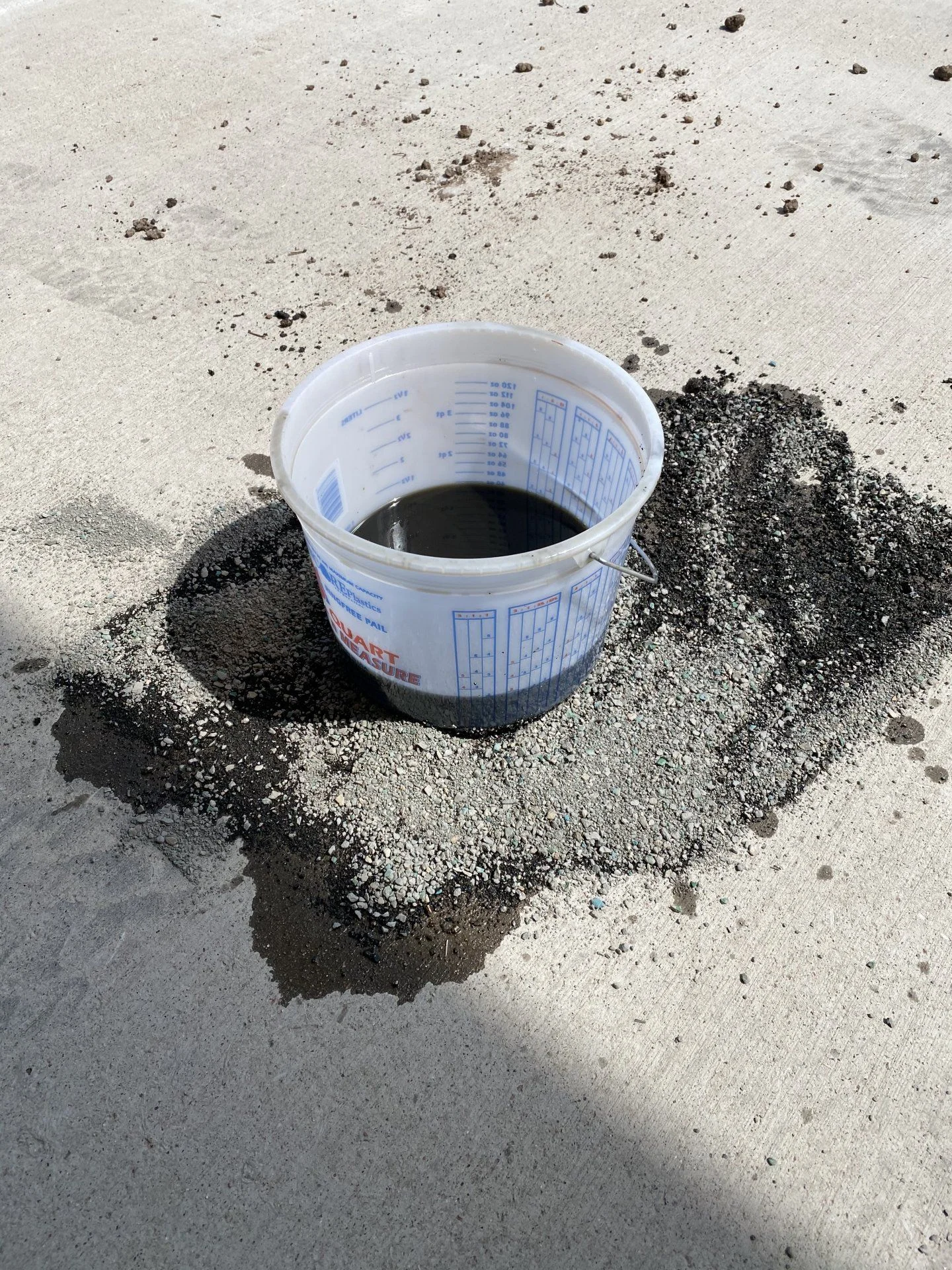

Also note.... The front fluid will drain out with conviction! Had a mess to clean...

I wanted to give an update... I changed the Transfer case fluid at 34,000 miles and it looked new. I'd recommend waiting a little longer for a change on that.
I can't say the same about the differential and transmission fluid. They were pretty nasty.
